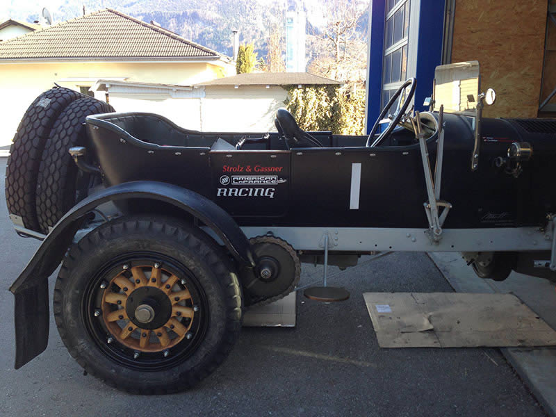

    Chain drive.

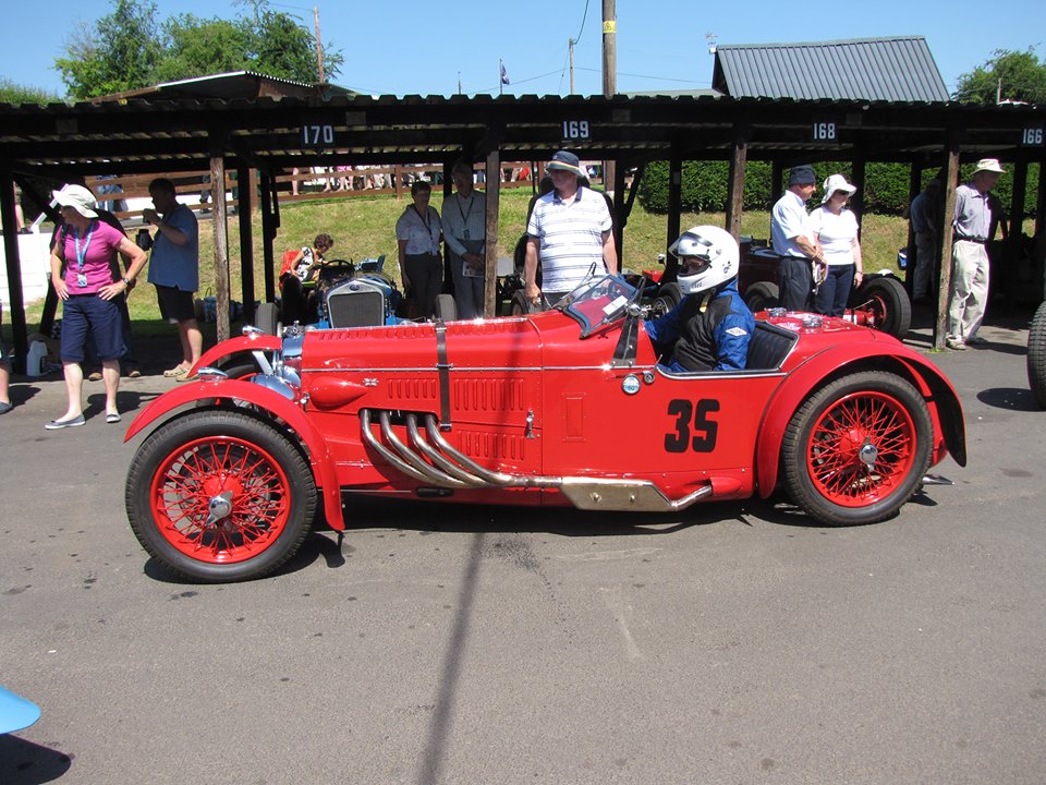

    Frazer-Nash Ulster at Shelsley Walsh.G.L. images

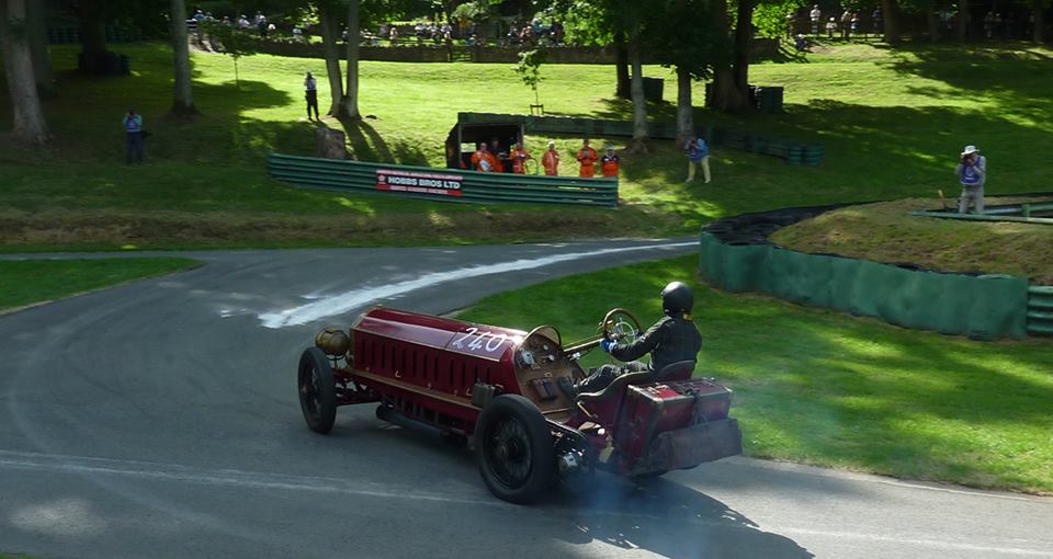

    More of the F-N by G.L. at Shelsley...

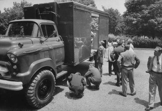

    Is that what this thig is?

    Yes. Notice the flat floor in the box. No place for any drive in there.

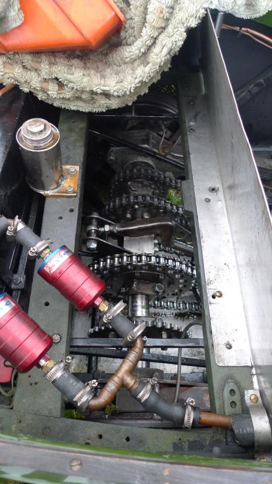

    Chain Drive...
