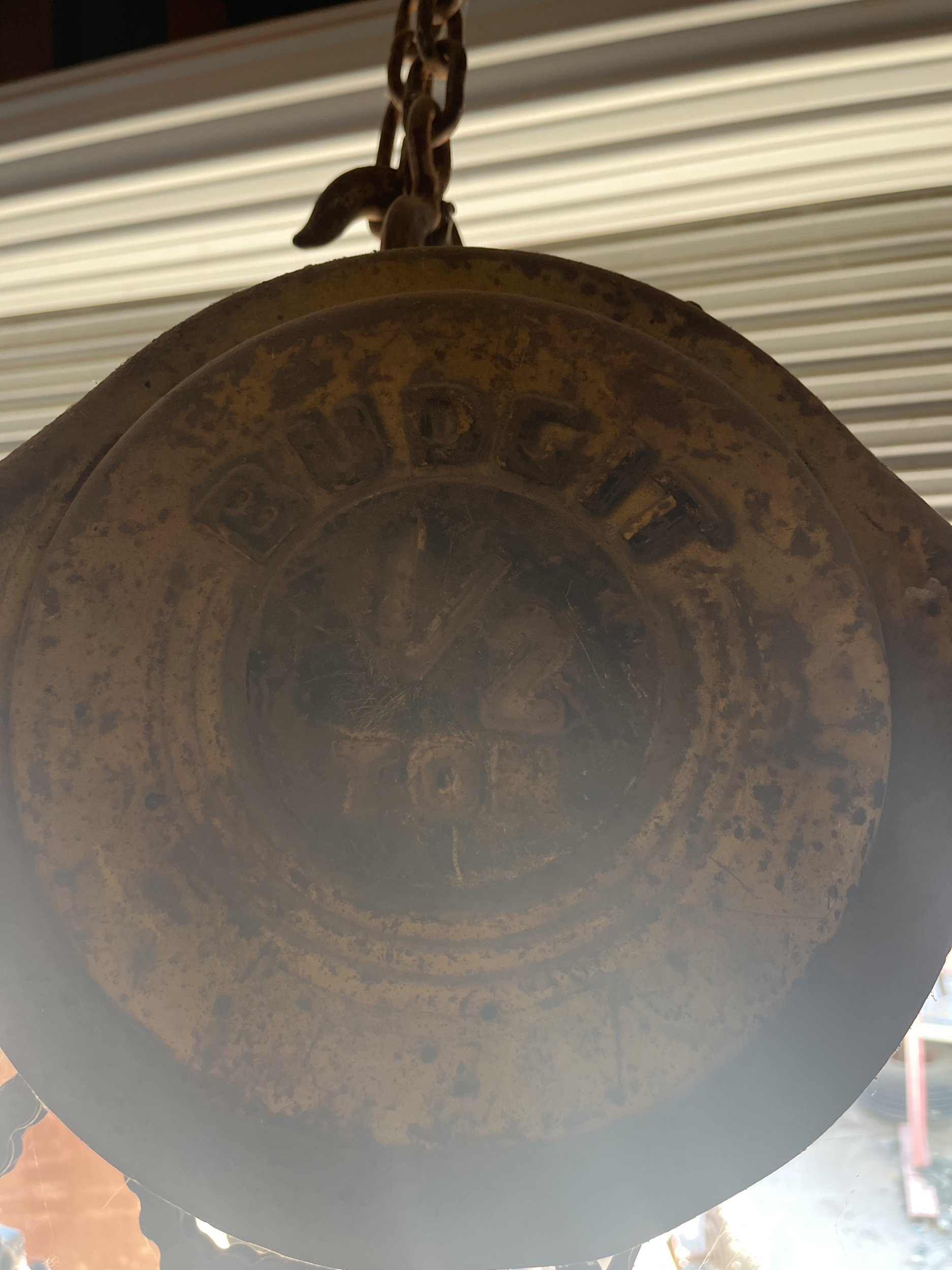

    This one is at least 50 years old
    If you can’t read it, Budgit 1/2 ton
    I also have an electric one (Budgit) that I need to take apart and fix.

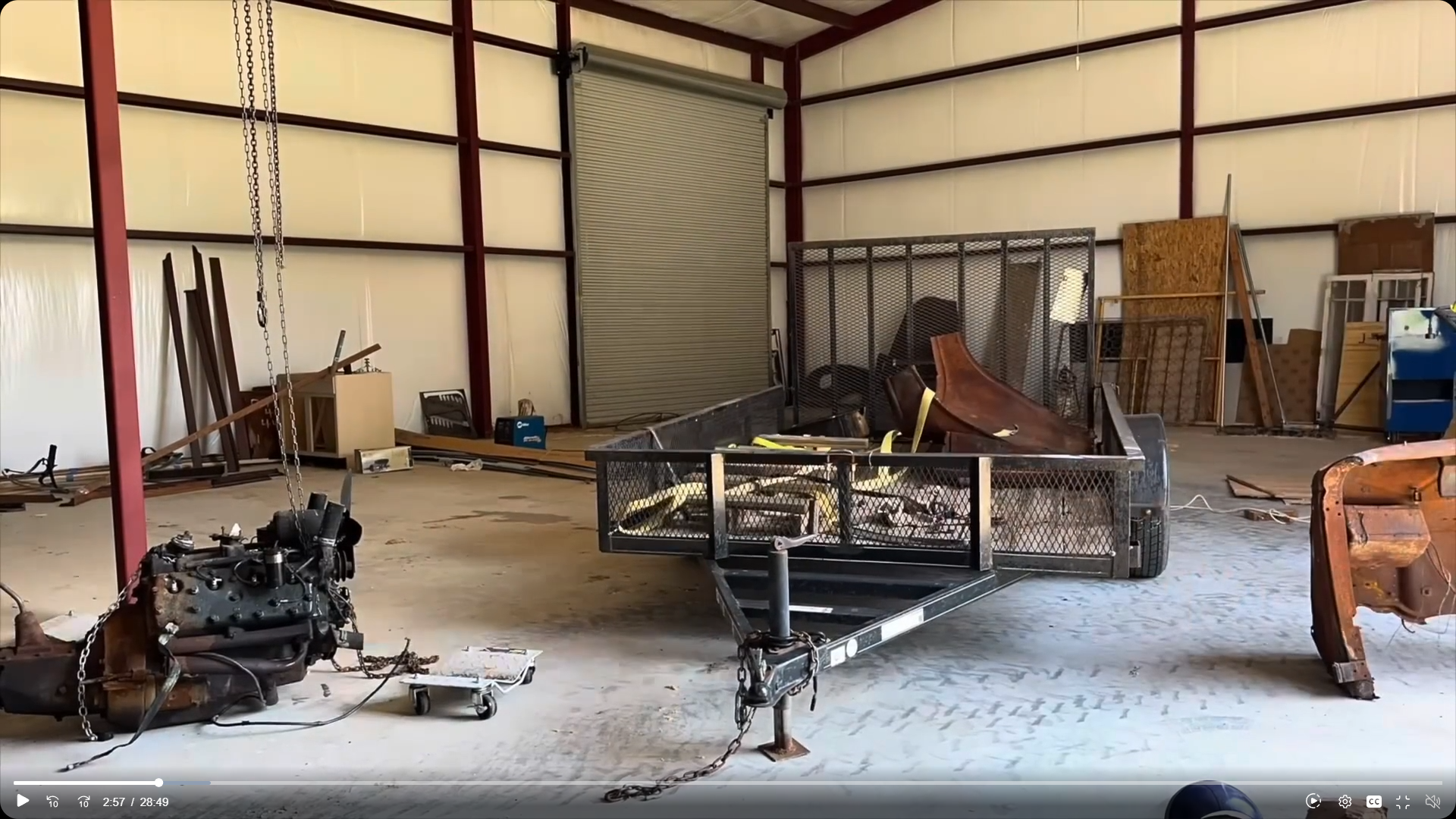

    Looks to me like the chain attached to the engine came loss on one end.

    The catastrophic failure seemed to be the chain around the engine letting go. The hook is still in mid air. The lower chain probably broke or whatever was holding it together broke after the shock loading of the previous drops on the faulty chain hoist. Sketchy stuff. I have two chain hoists and they are both excellent quality made in England units at least 50 years old.

    I'd say the bolt holding the chain to the engine broke or the bolt was to small headed and the bolt head pulled thru the chain link.
    Seen guys do that with a bolt head just barely big enough not to go thru the link, I ALWAYS put washers on the bolt heads, don't trust some of the cheap bolts now days not dis-forming and doing exactly that....

    Not much later in the video; you can see the loose end of the chain that was on the motor hanging on the ground with looks like bolt head and washer still in it.
    Don't know what made the hoist drop; but maybe the two shocks did in a bolt that was weak, loaded at an angle, or not screwed in far enough.

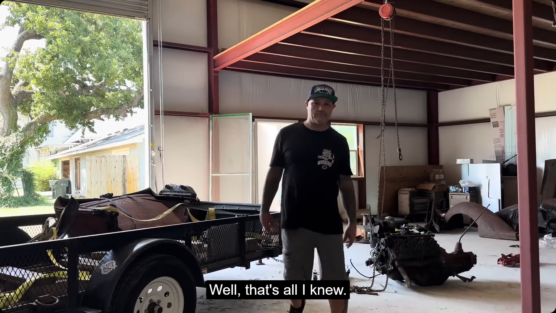

    Improvising, taking shortcuts to save time and not following the most elementary safety principles. He's an OSHA incident waiting to happen. He'll eventually hurt himself and/or others around him.
    • That looks like a 1/2 ton or 1 ton rated fall, for probably a 700lb. engine/trans. Pushing the limits. He has a big beautiful new shop and he's cheaping out on one of the most dangerous shop actions.
    • He uses a C clamp for an anchor shackle. A miracle that C clamp didn't snap.
    • He completely ignores the warning signs of an impending equipment failure; the chain jamming multiple times as well as it dropping the load multiple links shortly before the load being dropped. Sling chain not properly fastened to the engine.

    The galvanized chain that he was using on the engine broke or the bolt pulled out.
    Still I don't want any clown who uses a 6 inch C clamp to hang a chain fall / chain hoist from anywhere around my shop I figured it was that cast C clamp that would break.
    I've had this one hanging from this gantry for over 25 years and it will hang up like the one he used did when you try to go too fast but I figured it was rust on the chain to some degree. the chain just binds up when you get carried away with going faster than it wants to.
    2 screen shots that show that that dog chain he was using on the engine it's self or the bolt he was using is what gave out. Screenshot (478).png Screenshot (475).png
