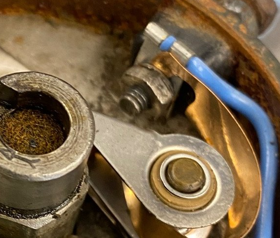

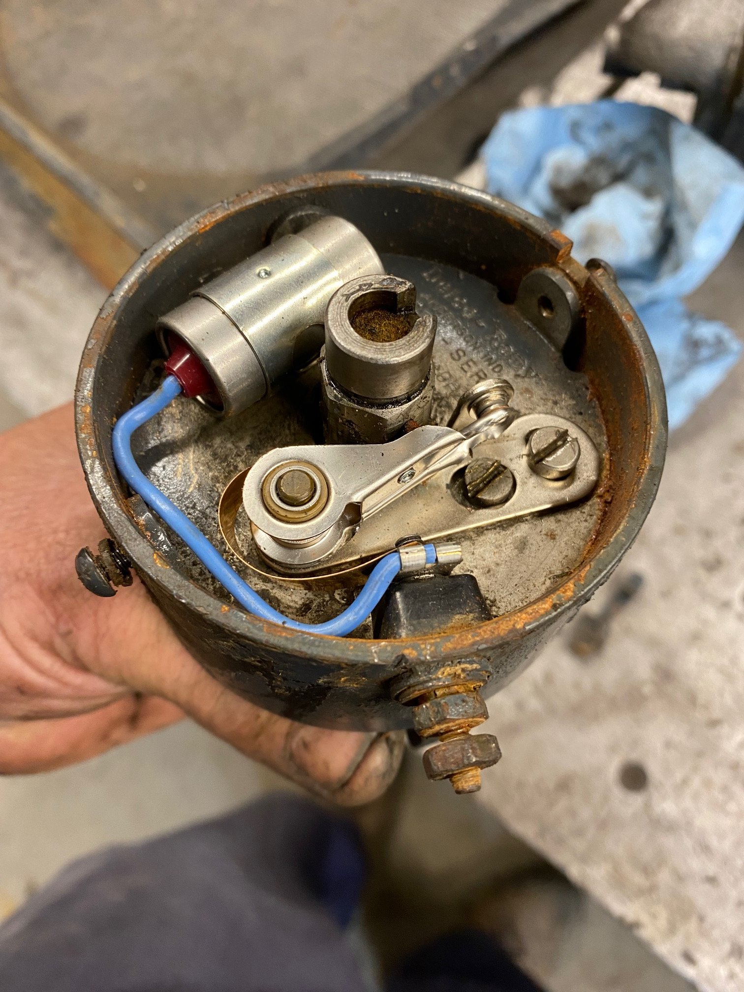

    back story. recently purchased 1940 chevy pickup, original 6 converted to 12v ,start and idled ok but "fell on its face" under higher rpm/load. pulling the choke out didn't make a difference. At higher rpm it acted like it was governed or rev limited. was recently tuned up and carb rebuilt.
    I found a few little things but can you spot the main reason? IMG_2480.jpg IMG_2479.jpg timer starts now!
    Br*** Contact isn't sandwiched properly
  3. HOTRODPRIMER
    Joined: Jan 3, 2003
    Posts: 65,331
    HOTRODPRIMER
    Looks like the br*** part is not properly seated/bolted down. HRP
    Sharpone and chryslerfan55 like this.
  4. tb33anda3rd
    Joined: Oct 8, 2010
    Posts: 17,591
    tb33anda3rd
    Good eye! That was one of the little things, but {hint} that thin br*** contact strip was held securely and was making good contact.

  5. patsurf
    Joined: Jan 18, 2018
    Posts: 2,875
    patsurf
    condenser screw too long?
    tb33anda3rd likes this.
  6. HOTRODPRIMER
    Joined: Jan 3, 2003
    Posts: 65,331
    HOTRODPRIMER
    Does it have a loose screw? HRP
  7. Flathead Dave
    Joined: Mar 21, 2014
    Posts: 4,057
    Flathead Dave
    from So. Cal.
    It's in your hand and not on the motor?
  8. Corn Fed
    Joined: May 16, 2002
    Posts: 3,453
    Corn Fed
    Worn lobes?
  9. Ebbsspeed
    Joined: Nov 11, 2005
    Posts: 6,515
    Ebbsspeed
    Probably all that rust not providing a good ground for the points mounting plate.
  10. Moriarity
    Joined: Apr 11, 2001
    Posts: 39,147
    Moriarity
    SUPER MODERATOR
    The br*** contact shown on the points is not a spring the spring is missing….
    saltflats, warbird1, ClayMart and 7 others like this.
  11. RodStRace
    Joined: Dec 7, 2007
    Posts: 9,785
    RodStRace
    What he said. /\/\/\
    The spring's not installed.

  13. Mike VV
    Joined: Sep 28, 2010
    Posts: 3,324
    Mike VV
    from SoCal
    Yeah, no spring holding the point arm in place.
    And enough rust on all...of the contact points, to cut the electron flow by at LEAST half.
    Mike
    Sharpone and tb33anda3rd like this.
  14. tb33anda3rd
    Joined: Oct 8, 2010
    Posts: 17,591
    tb33anda3rd
    there was a loose screw but that was one of the minor problems
    true:D but not the problem at the time
    probably slightly but not the issue.
    there was rust which contributed to a "not ideal situation"
    all good thoughts

  15. Sporty45
    Joined: Jun 1, 2015
    Posts: 1,410
    Sporty45
    I was looking at the condenser wire and thinking maybe it was shorting out on the case.
    Sharpone likes this.
  16. tb33anda3rd
    Joined: Oct 8, 2010
    Posts: 17,591
    tb33anda3rd
    YES! it has barely enough tension to close the points
    some have springs, some have a strong enough band to do both a connection and a spring.
    this isn't the first time I have found this
    lots of little things add up to problems
    Sharpone and Moriarity like this.

    CSPIDY
    Simple, no rotor
    Duh
    skooch, Just Gary and tb33anda3rd like this.
  19. guthriesmith
    Joined: Aug 17, 2006
    Posts: 12,656
    guthriesmith
    Beyond what has been mentioned, betting those points with no spring are the normal quality we can expect with points these days and that condenser is also suspect if it is anything like several of the new ones I have bought in recent years. I'm thankful that when I bought an old pickup recently, the farmer loaded me up with some old ignition parts still new in boxes. That is now my stash of points and condensers for this old stuff.
    ClayMart and tb33anda3rd like this.

  21. ididntdoit1960
    Joined: Dec 13, 2011
    Posts: 1,469
    ididntdoit1960
    from Western MA
    Not sure how those are set up.....but looks like there's no mechanical/centrifugal advance

  24. hot4hotrods
    Joined: Apr 13, 2009
    Posts: 215
    hot4hotrods
    from U.K
    Yeah, you've got no rotor arm in it.
    tb33anda3rd and Just Gary like this.
  25. ClayMart
    Joined: Oct 26, 2007
    Posts: 7,937
    ClayMart
    I don't see any vacuum advance cannister. Or is this like some of the later 50's, early 60's Chevy sixes that had a "floating" distributor which moved the whole distributor housing when the vacuum advance was actuated? Though I'll have to officially agree with the missing spring being the problem. The br*** contact strip is nowhere near thick enough to provide proper spring tension.
    Excellent pictures, by the way.

  28. 50chevytx
    Joined: Feb 4, 2018
    Posts: 115
    50chevytx
    Screws that hold plate to housing loose
  29. tb33anda3rd
    Joined: Oct 8, 2010
    Posts: 17,591
    tb33anda3rd
    hah
    the vacuum advance unit mounts to the base and turns the whole distributor. that was working properly
    45+ years of fooling with this stuff everyday:):cool:
    I think so
    they were tight but rusty under neath
