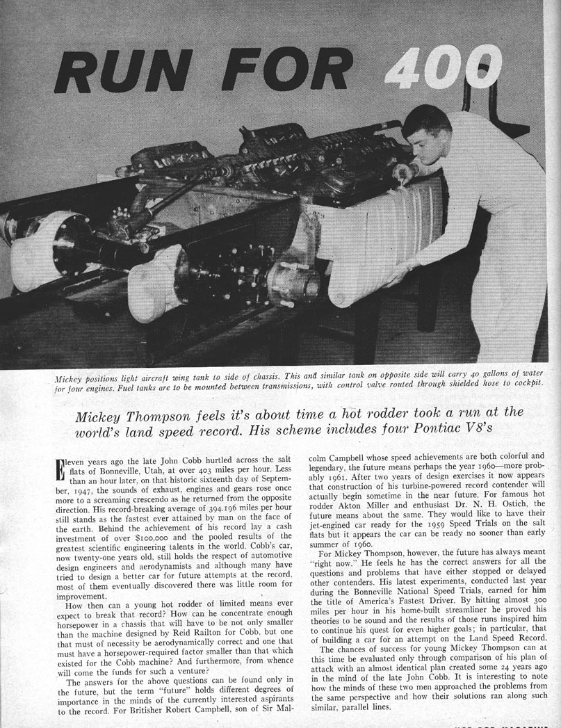

    dreracecar -
    "all four of the engines were pointing towards the center of the car, nose-to-nose"?
    I don't think so!! Check the construction pix in this article.

    Oops! Never mind.
    I thought you meant the centerline of the car. The engines are indeed 'nose-to-nose. My bad. )-:
    Still, the article and photos should offer some clarification.

  3. So we still don't know if 2 engines were actually run backwards do we? Stan292s pictures don't show/tell if the front ring gears were flipped. It is possible that 1 ring gear was each way so a pair of engines were contra rotating. The stamping on the engine in question suggests that this was the case. Interesting concept!

    One of the front engines and one of the rear engines are reverse rotation (at opposite corners of the ch***is). I have spoken with Jim Travis who did the restoration on this car and that is what he told me, for the reason mentioned earlier, to exert torque to the centerline of the ch***is.
