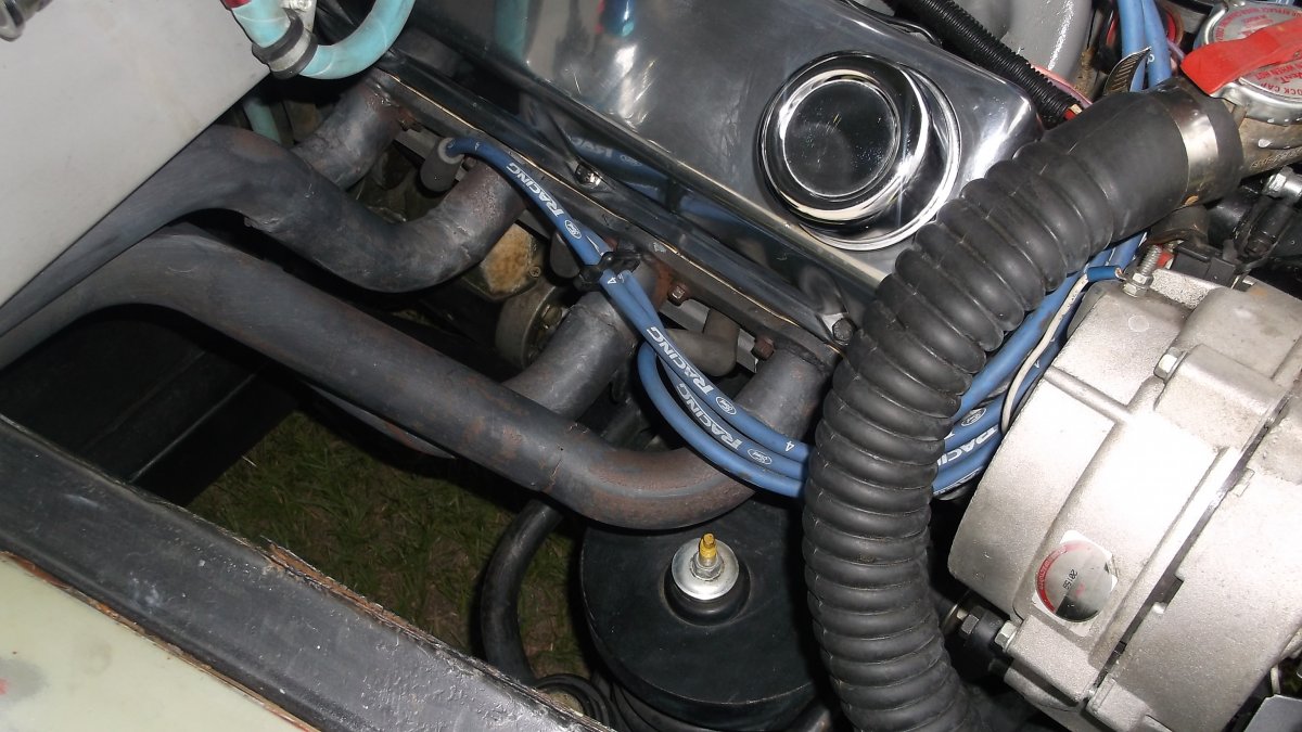

    In order to stuff the SBF into my Austin-Healey, I ended up using Sunbeam Tiger cast iron manifolds to get the clearance I need. The motor is a Ford 5.0L with Edelbrock RPM Air Gap, Holley SA 570 cfm and a Trick Flow Stage 1 cam. Heads are stock iron GT40P with a nice valve job. It dynoed at the crank at 345 with long tube open headers.
    The Tiger manifolds were for the Ford 260 and are pretty restrictive. Additionally, I had to make some restrictive bends like this to get everything to work:
    Obviously, I expected to lose some HP with this set-up, but after installation in the car with a T5 tranny, it dynoed at 199 at the wheels. That just seems way too much parasitic loss and without any further changes to the motor from the engine dyno, the only thing I can think of that would suck up that much HP is the exhaust. The rest of the dual exhaust is 2 1/4" pipe running through Spin Tech Cruiser mufflers.
    I've found some Summit block huggers that look like they will fit [​IMG]
    but not without a major amount of work, including engine out, reshaping the footwells and probably moving the engine and tranny back as well.
    So before going to all that trouble, I need some opinions about whether I'm barking up the right tree. Even if I took parasitic losses at the usual 20% I should be seeing 270 hp at the wheels. Is this exhaust really costing me 70 hp or so?

    Those were the optional Tiger cast iron Tri-Y headers. The ones I have were stock on the Tiger. One side was a special manifold just for the Tiger, the other was a standard Fairlane manifold.
    The block huggers exit at a different point on the chassis than the manifold which necessitated the 90 degree bend in the downpipe to avoid an engine tower mount
    I looked at every kind of manifold/header I could find when I did the swap and these were the only ones that would work. There is barely any clearance between the manifold and steering column as is. I only saw these blockhuggers recently and I probably would have given them a shot during the install.
    Here's an idea of how tight it is (I ground the portion of the manifold hitting the steering column to get the clearance I needed)
    If I try to use the block huggers, I'm going to have to move the engine and tranny back an inch and drop the motor down in order to get the front tube of the header under the steering column (I don't want to put a universl in the column) I just don't want to do all that work without a relatively big payoff.

    Agree with chevy57dude, pick up a set of stock 5.0 tubular manifolds or used 5.0 shorty headers. You should be able to find them locally cheap.
    Test fit those, at least they are rearward pointing and dont dump straight down causing the need for a tight 90 degree pipe.
    If you can weld, you may be able to pie cut the 4 into 1 area and adjust the angle on the flange (aftermarket headers, depends on what you get)
    Not sure where all the steering, etc is on those cars, what you need to work around. The manifolds you have now are rear dump, the ones you're looking at are center dump.
    As far as power, 5.0's have been making pretty good power with shorty headers for 30 years. Yours should be on par if its tuned well.
