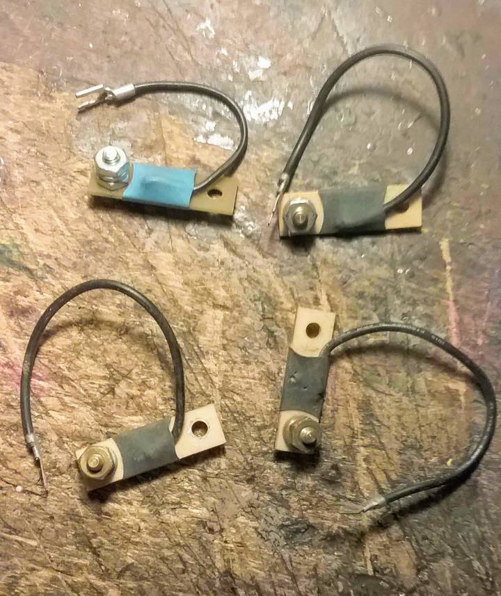

    Get a copy of this book ..it will tell you everything you need to know, and they even word it so you can understand it and they got picture's also. 1574131453237~2.jpeg 1574131538220~2.jpeg 1574131639044~2.jpeg

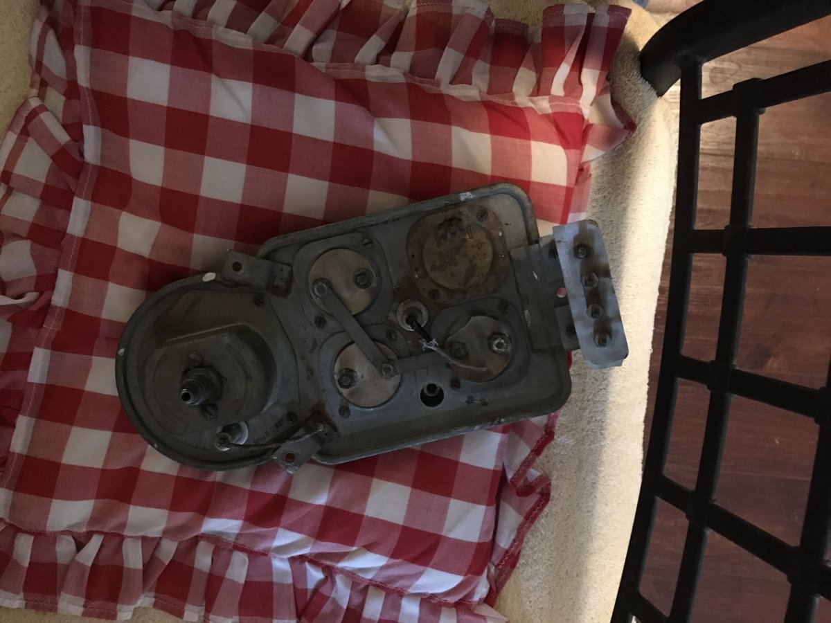

    Will just one of these reducers power all (3) gauges on my 49 Merc? 1V1006__ra_t.jpg

    I’m not sure what you are showing is off of, but as mentioned in the dash of Ford’s and Dodges up to the 80’s are 12 to 6 volt reducers. They work for all the dash gauges.

    Yup it will drop it for all the gauges, just run the power for all the gauges through it and your good. Thats how my 39 is set up right now.

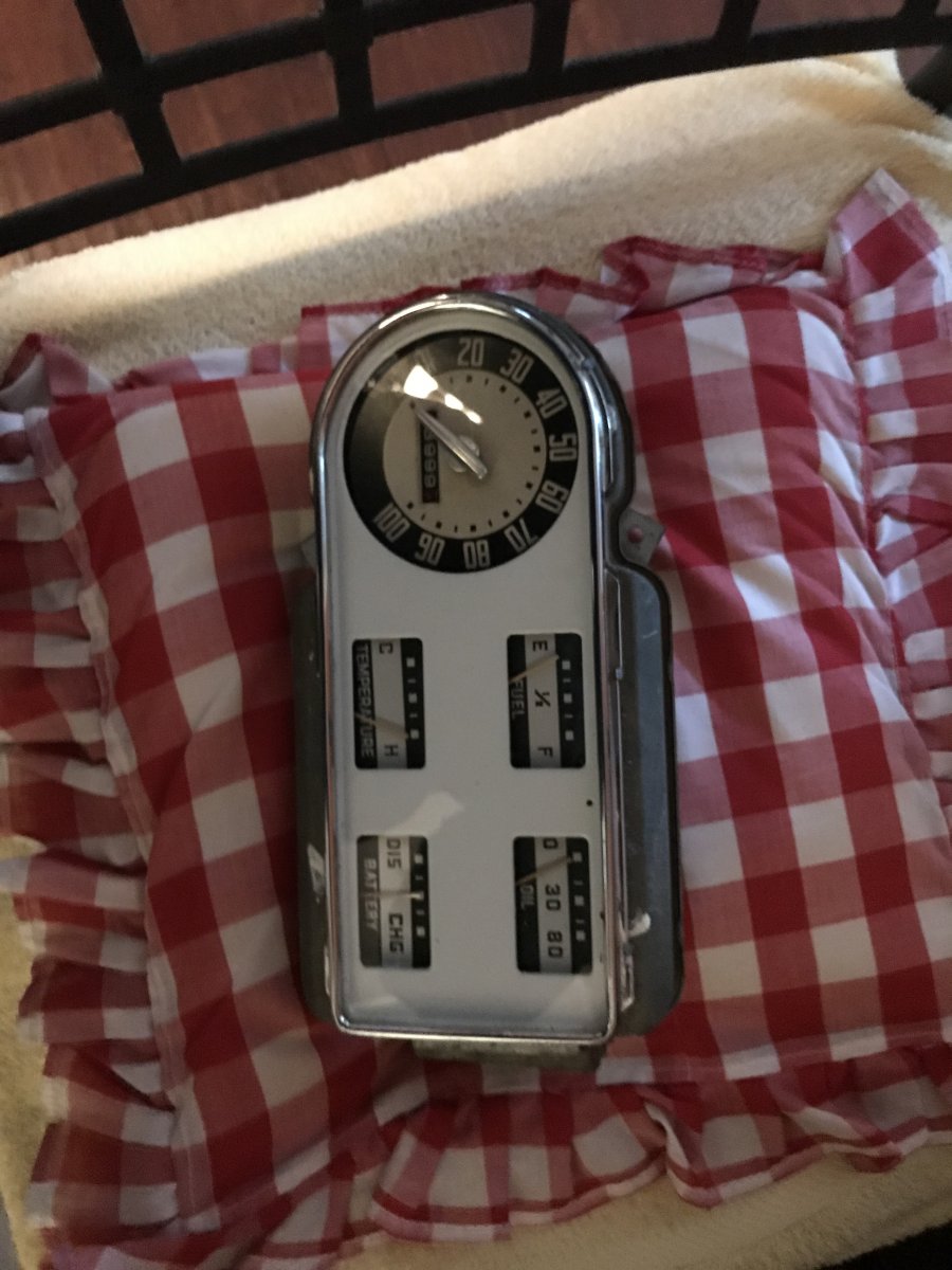

    This is my 1948 F1 . Debating weather to use it or a vintage looking separate speedo / quad gauge and make the stock dash cutout round on the right side. 2746256D-CAC1-4FD4-A863-3128197754C2.jpeg A2064155-B274-4616-AF46-F8E99D0B2A55.jpeg

    Use the original gauges, they are the reason we drive old cars, it's the look. Anyone can buy new gauges.
