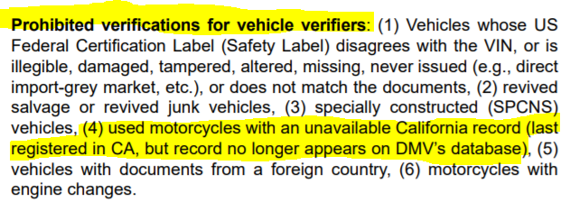

    California project car buyers be aware:
    The new form (REG31) for VIN (aka serial) verification took effect on 10/20/2018, as did the new rules.
    This is one of the amended sections:
    I may drop my bond, and not bother to renew my license. According to CHP and DMV rules, they want to see a complete vehicle (their interpretation of complete), operable (their interpretation of operable).
    I used to be able to to do them without supporting do***ents, that was between you, the owner, and the DMV. Now, I can't. You need to deal directly now, for that.
    From the new verifier's handbook:
    Supporting do***ents can be an old ***le, or old registration. Basically anything that proves it was once in the California system.
    Now, it seems, I can only verify cars that you could drive to AAA or the DMV anyways.
    Anyone who is holding a REG31 form from me, who did not use it before the rules changed may be out-of-luck. Nobody at the DMV seemed to know that this was coming, and many don't know that it did. I sure didn't.
    Your mileage may vary in our success, but my suggestion is to haul *** to the DMV and try now, before everyone gets trained on how to turn you down.

    Thanks Gimpy. So you can still do bikes? Wonder why that exclusion (said the guy with a bunch of them),
  6. gimpyshotrods
    Joined: May 20, 2009
    Posts: 24,516
    gimpyshotrods
    Only if it is still in California records. Otherwise, it has to go to DMV or CHP.
    Good thing this is not a primary source of income for me, 'cause I think than I'm done.

    That number 2 in the rules looks like it could be a killer---revived salvage or revived junk vehicles. Sounds as though it would be up to whoever is doing the looking at the DOT as to a vehicle put together from junked parts would p*** or not, independents like Gimpy couldn't look at them anymore. Am I seeing that right?

    Salvage/junk status is a ***le brand in CA. It does not mean that it came from behind a barn.
    It means that it was processed out of the system by a salvage yard or a dismantler, or previously declared a total loss.
    Either one means that it has a ***le, but needs a verification anyway. That, and a brake and light inspection (at an independent garage). Neither of those two ***le brands is a real issue, just more paperwork, and of course, a DMV or CHP inspection.
    Then again, that was not a rule change. Independent verifiers were never able to verify those.

    I'm thinking the "reviving a salvage vehicle" is probably at the heart of the issue and has nothing to do with old hot rods built from parts that you can do***ent.
    The theft / back ally rebuild rings go at it from two angles. Here they were stealing late model trucks off the lot or street, carefully stripping all of the removable parts off leaving a rolling ch***is and stripped cab that they dumped in a highly visible spot where the law was sure to be called and the rig would be quickly impounded. Then they bought the rig through the wrecked vehicle auction and took it back and put the same parts back on it. I'm not sure where they had them inspected and sold them but would think it was out of state in a state where the inspection process was a bit lax. The inspectors here take your car in a room with a hoist, close the door and put the car up on the hoist to go over it and can tell you things you didn't know about it even though you had it half apart before getting it inspected.
