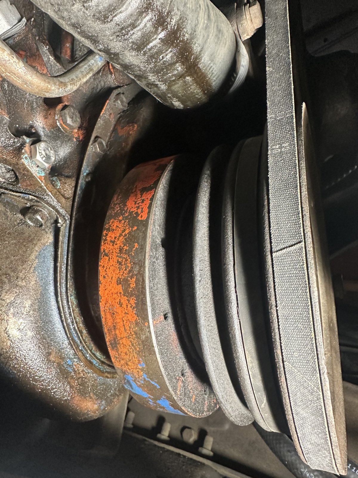

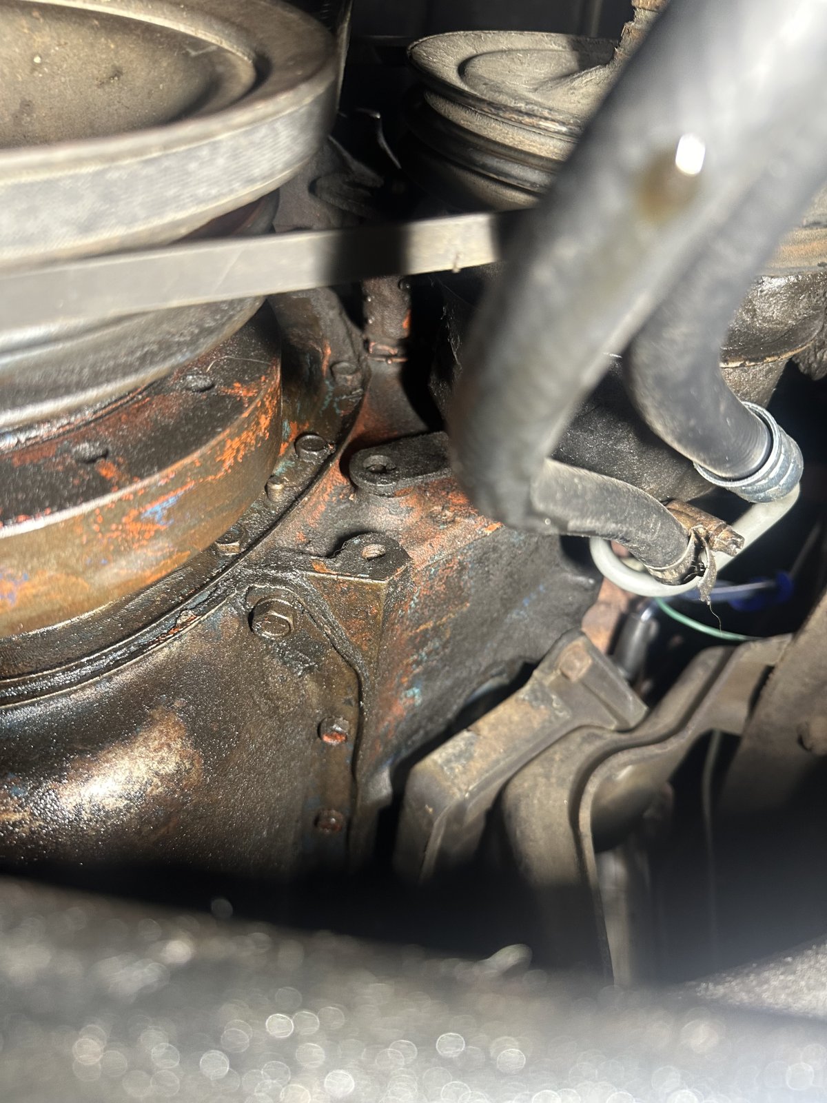

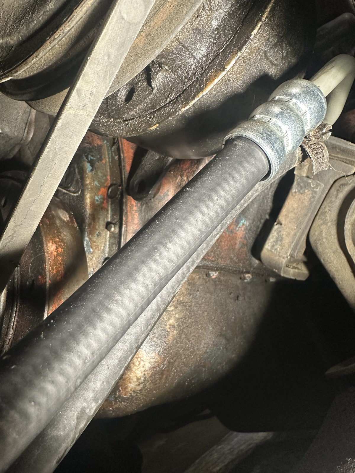

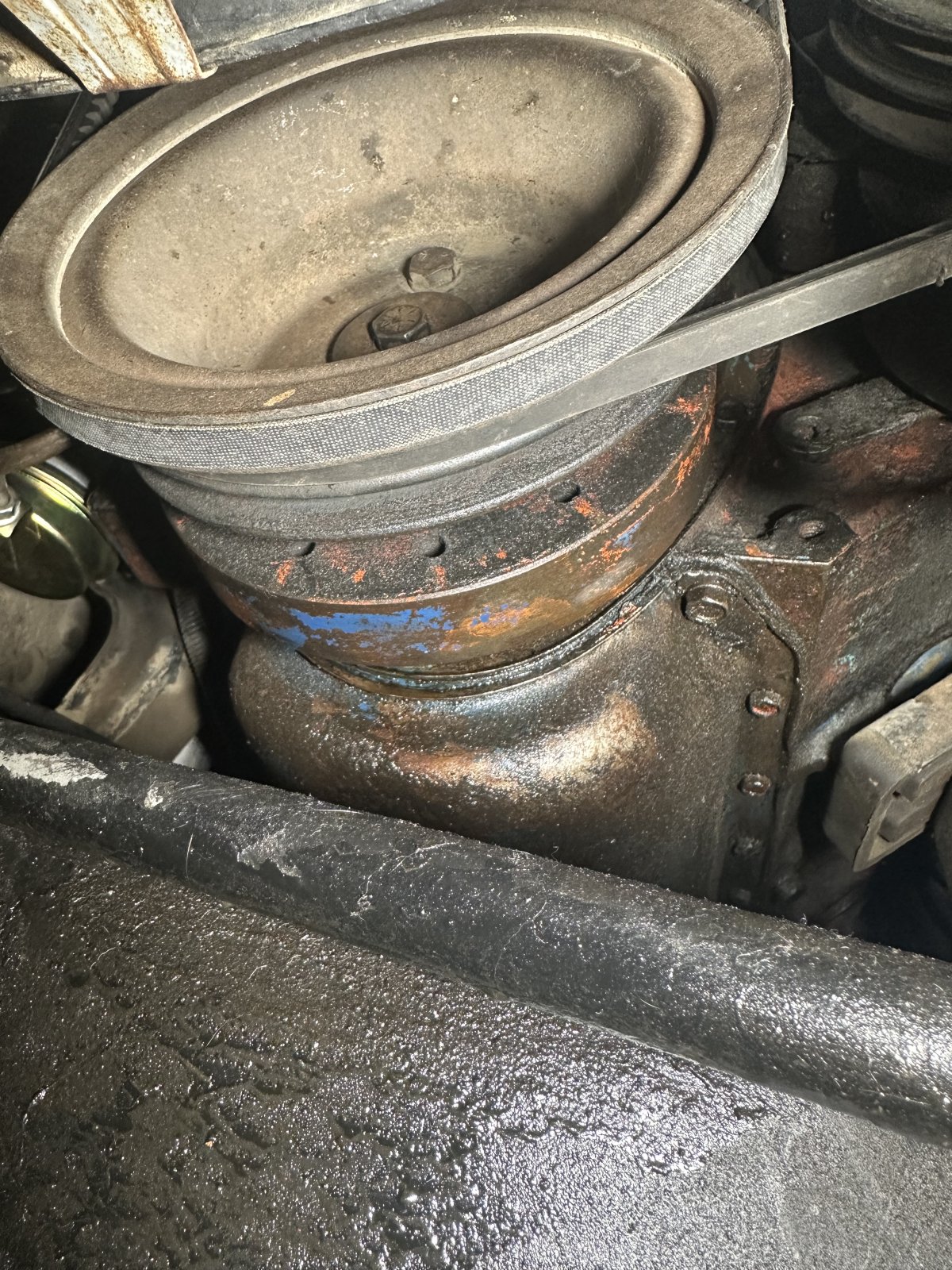

    Here is a photo dump... I don't see anything that makes it easy or clear someone was in there already or what kind of care the previous person had about the possibility of it having nylon gears... however someone felt like painting it orange.
    The only other comment is my timing mark is exactly off by 10 degrees. It hasn't shifted in the time I discovered it and made a new mark.. I verified this with a piston stop, so I don't know if its possible the previous owner did change the timing set and installed the harmonic balancer incorrectly.

    it's been worked on, you can see the lock washers on the pan and timing cover bolts. I'd be shocked if the original timing sprockets were still in there.

    Thanks for good pictures.
    Good move doing research first.
    Swapping camshafts these days can go sour unless you get rollers
    SDrocker and squirrel like this.

    might want to put that bolt back in where the power steering pump bracket attaches?

  25. Tow Truck Tom

    Davesblue50 and squirrel like this.

    I didn't take that out but yep I'll put a bolt in there!
