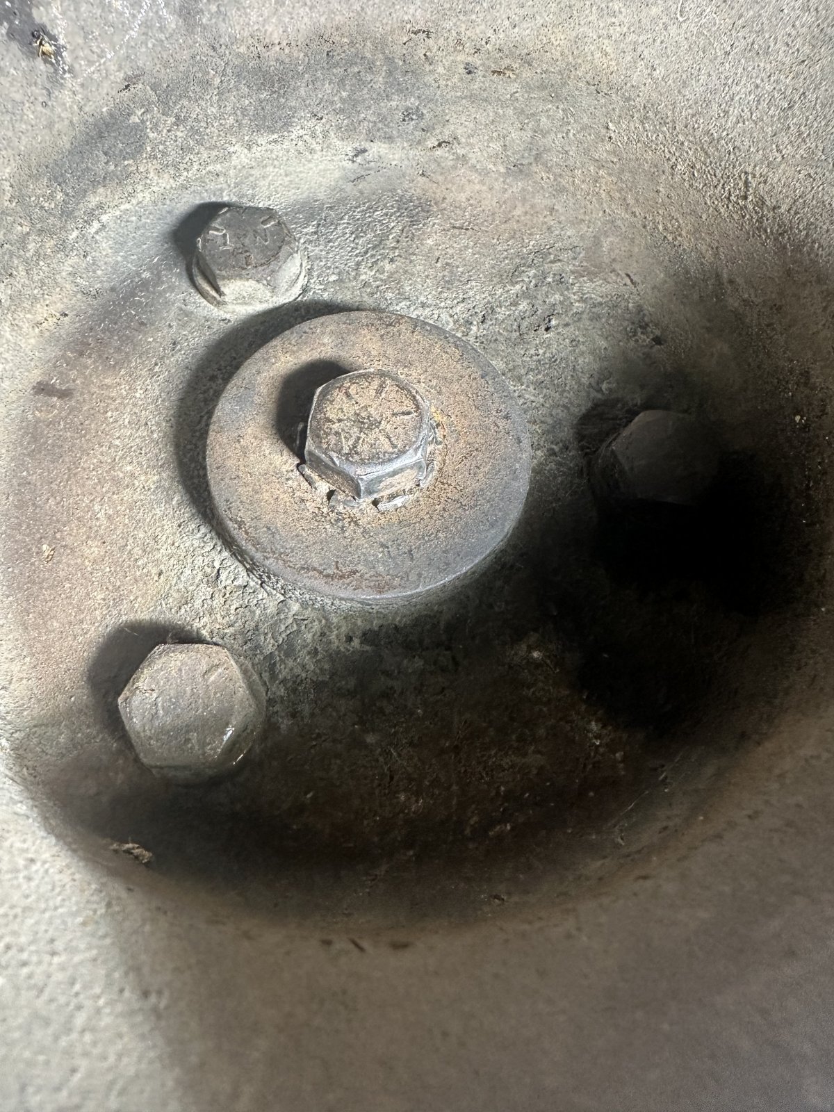

    I don't work on a lot of SBC stuff, but don't recall ever seeing the damper bolt have a locking tab washer under it. (click on "view attachment" above to see it.
    Did they come from the factory with that locking washer?

    Interesting and on top of that like I said in an earlier post the timing mark is off exactly 10 degrees. I verified this with a piston stop tool.

    I have seen the star lock washers on the crank bolt from the factory.

    I agree with @saltflats , I have a 350 horse 350 short block that has the washer on it.
