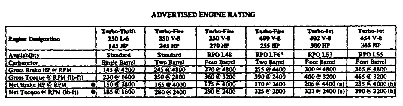

    The 350 engines in the 70s were available with 2bbl carbs in some cars, and in some trucks. These had heads with smaller valves (same large chambers though).
    Points were last used in 1974, they went to the HEI in 1975 on all of them.
    This is the torque and power ratings for the 1975 full size Chevy cars. The ratings are "NET", which means they compare with ratings back to 1972, but before that the ratings had been "GROSS", which was about 30% higher. So don't compare these numbers to 60s engine HP ratings without taking that into account
    The thing you might want to look at when you're deciding 2 or 4bbl is the torque rating of the engines. Turns out the torque rating is the same for the 2 and 4bbl version of the 1975 350 engine. But the HP is higher, but just a little, and both at the same RPM. It could be that this was limited on the 4bbl engine by the very restrictive early catalytic converter single exhaust. Even so, most of your driving is at lower RPM, and the 2bbl is making just as much torque as the 4bbl at these engine speeds, so you're not really likely to gain anything until you hold the pedal down, enough to get the engine well over 3000 rpm. How often do you do that? (yeah, that's where the action is, so I can sure understand the desire to improve it)
    If you're using the truck for transportation, then building up another engine to replace this might be a wise way to go, instead of trying to slowly increase performance of this one. Or not...depends on a lot of things that I don't know.
    I do know that my 62 Vette with the low performance 327 could sure use a bigger carb, intake, valves/ports, and exhaust to "wake it up" over 4000 RPM. But it turns out I'm pretty happy with how it runs and drives with the restrictive top end. It has just as much torque at the engine speeds I use 99.9% of the time while driving, as it would if I hopped it up.
    Tough call, but it's good to have realistic expectations about what you might gain with modifications.

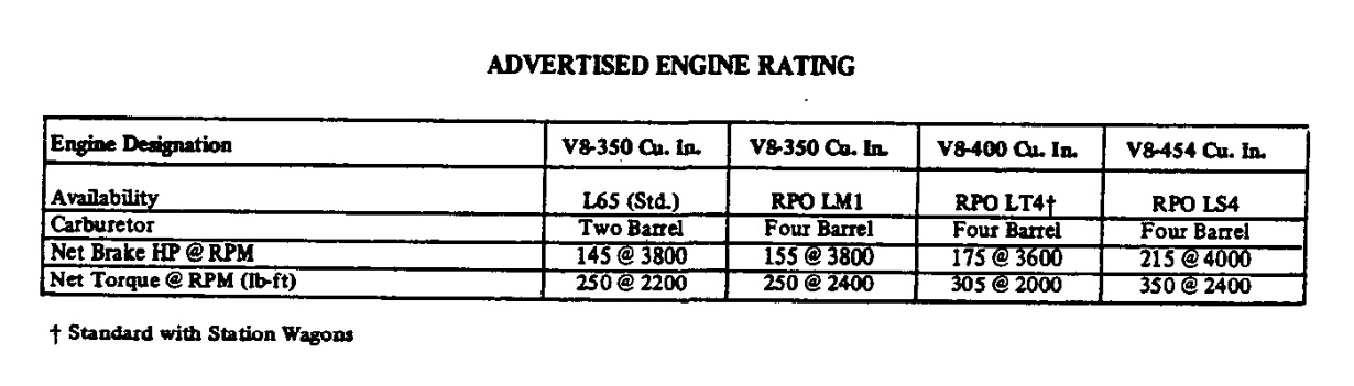

    Just to confuse you more, here's the same chart for 1971, with the gross and net ratings. The engines were pretty similar from 71 to 75, there were minor internal changes, but the biggest change was the addition of catalytic converters in 75.
    Keep in mind that it was really easy to wake up any of these engines by adding headers and a bigger cam. Swapping intakes and carbs usually didn't gain very much unless it started as a 2bbl engine, then the higher RPM power would increase noticeably. But if it started with a 4bbl, the improvement was not much different than running the original intake and Quadrajet carb.

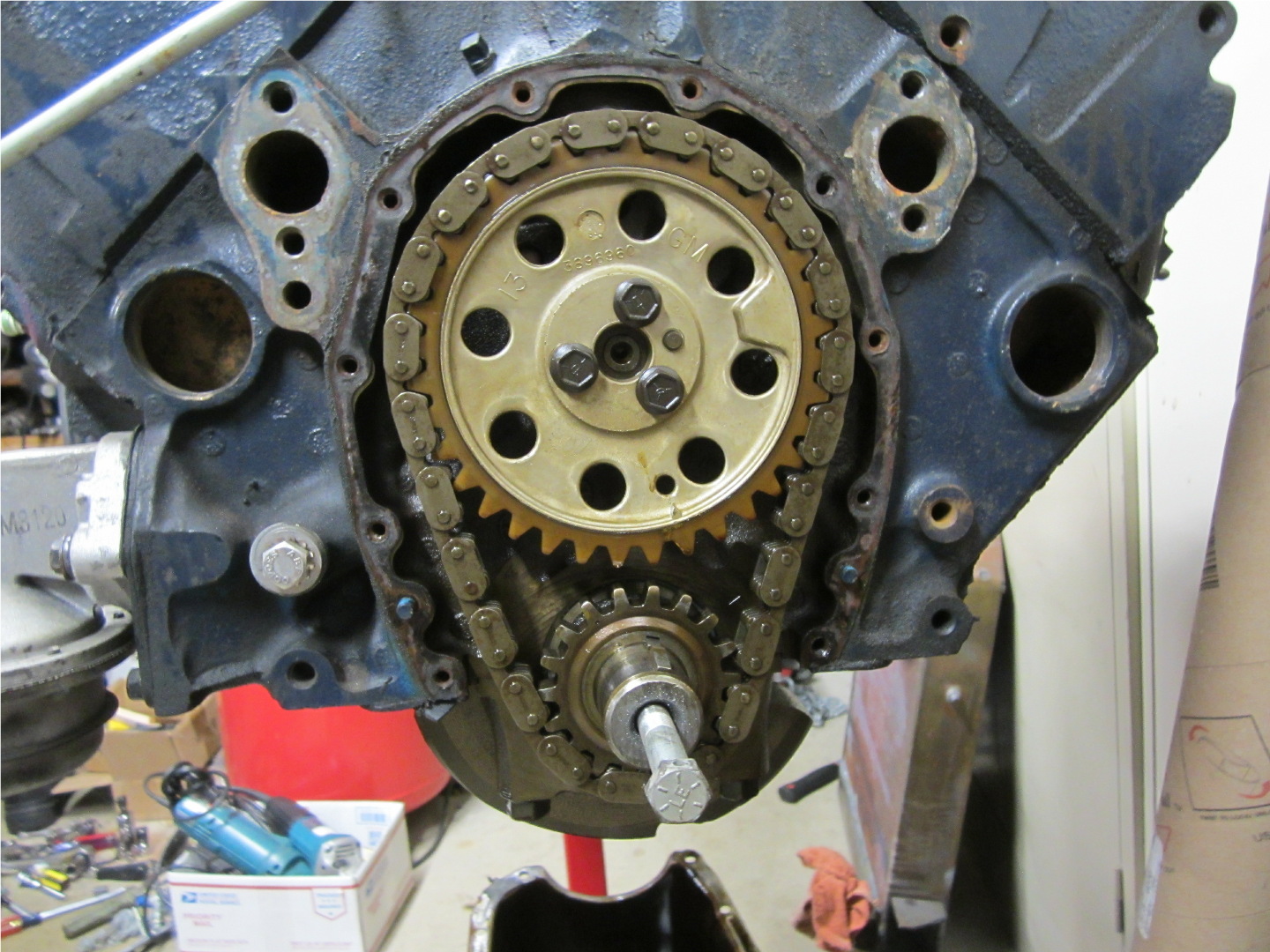

    You were right the cover had been off and I didn’t need to worry about the nylon gears! @The Chevy Pope check this..
    I noted a 10 degree offset at the harmonic balancer with the timing mark indicator on the timing cover when I found TDC using a piston stop. I compared the new harmonic balancer to the one I pulled off and bingo.. the new one looks where I expect zero to be.
    I set it at TDC #1 on compression stroke before taking off the timing cover….
    When I look at the new cloyes timing set parts the crank zero would be at 12 o’clock and the cam zero would be at 12 o’clock too. I think that’s correct at tdc #1 compression?
    there was a lot of slack in this chain though!!
    the bigger pain right now seems the oil pan… I’m going to have to take the starter out and see if I can drop the pan enough to work the one piece gasket in or even pull the pan all the way off if possible.

    That all looks normal to me....the sludge indicates the engine didn't get oil changes as often as it should have.
    When setting the cam timing on a SBC, it's normal to put the cam dot at 6:00, and the crank dot at 12:00, and totally ignore where the pistons are.
    But you have to get the engine back to TDC #1 firing position to get the distributor back in!

    Note two washer head bolts and one regular bolt with lock washer on the cam gear.
    No big deal but yeh, people been in there!
