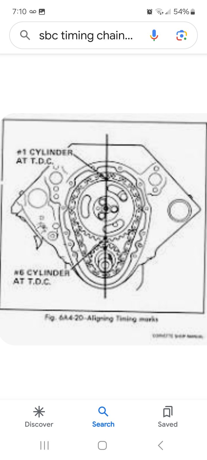

    Get the dots to line up, next to each other (6:00 on the cam, 12:00 on the crank), and then replace the timing set, with the dots at 6 and 12 as I mentioned. Ignore the position of the pistons when you are aligning the dots, only pay attention to the dots, have them next to each other, and in line.

    If you leave the dizzy in........ It is totally "in phase" with the cam timing.
    So it doesn't matter if the dots are at 6 o'clock or 12 o'clock. All that means is the crank has turned 360°
    Don't pull the dizzy, just set your timing later with a timing light.

    I dont know where the timing dot on the crank is when #1 is at tdc. If its at the top then great, if not forget the distributor and tdc and get the dot in the right place, and then the cam to match, as Squirrel has already said. Don't complicate it. Get the cam timing all wrong and it'll never run and probably bend valves trying. Worry about the distributor later; it might not be an issue.

    I pulled the chain and cam sprocket off but I can put the cam sprocket back on and get them to 6 and 12 o’clock … is the point of doing this because it minimizes the risk of being off a tooth by eyeballing both at 12 o’clock?

    Turn the crank 360 and they should line up if they're correct.

    Here is how the timing marks go .
    Need to be on top dead center

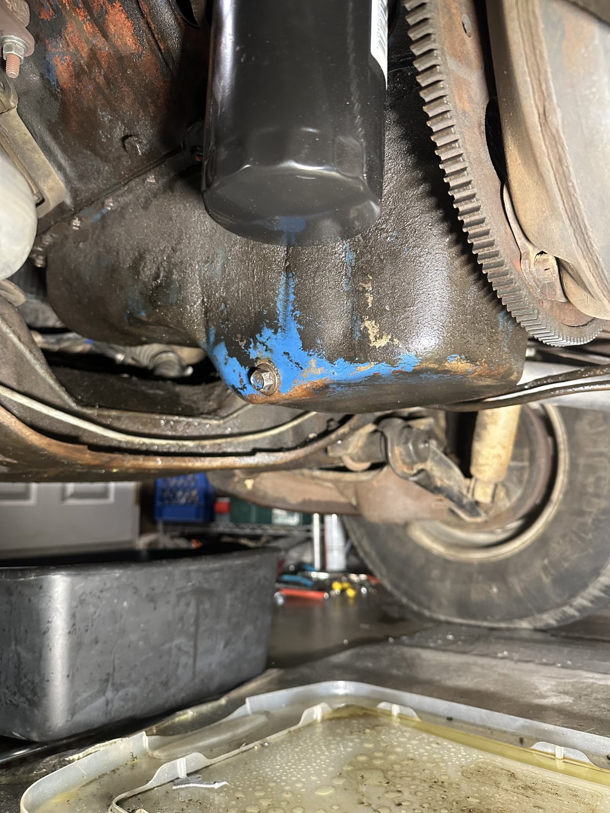

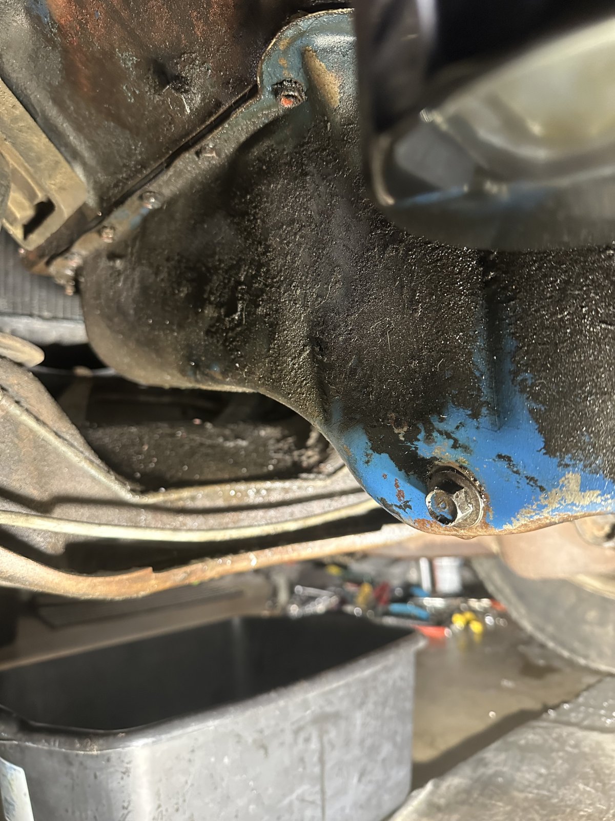

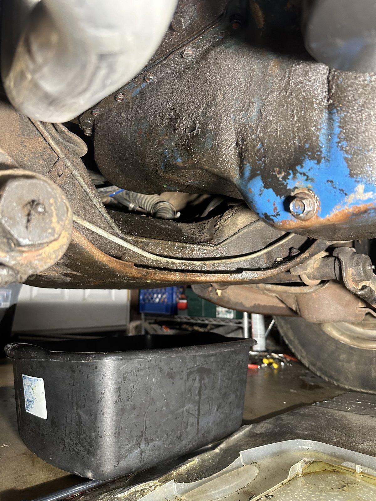

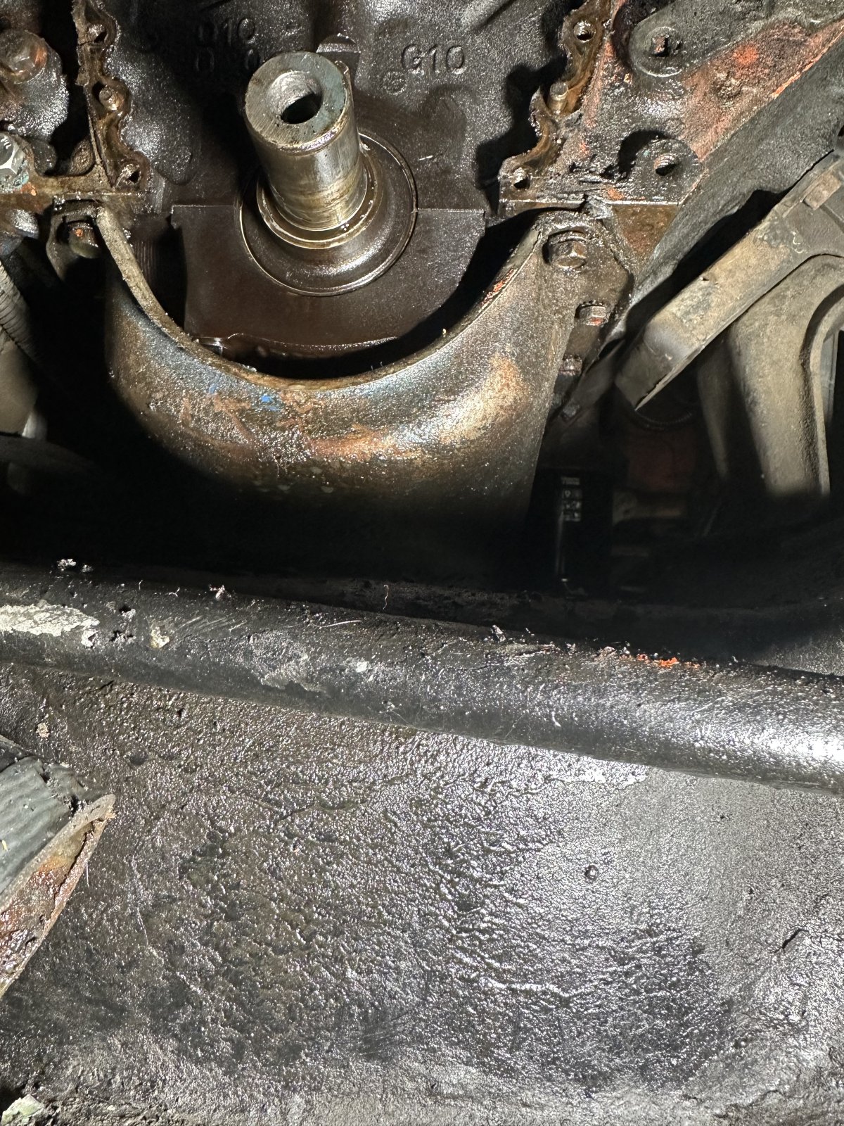

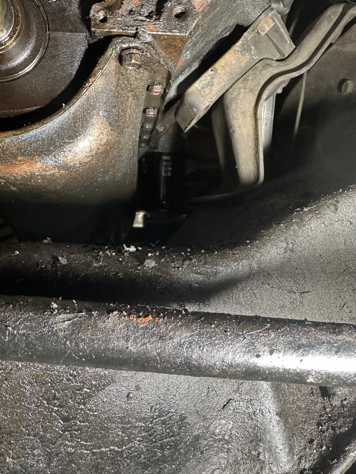

    Do these photos make it easier to tell if that pan can come out ? I am worried about loosening it up to just find out I can’t get it out without lifting the motor off the mounts which I can’t do.
    the one piece felpro gasket was $24.99 and maybe can be shipped back to rock auto if I don’t use it.

    that looks pretty easy to remove...well, not nearly as bad as some are.
    looks like the end of the pan gasket is gone, so you'll probably have to pull the pan.
    So much fun. I would have left it all alone, but then I'm lazy

    I did the pan on my 1970 C-10, years ago, block and floor jack under pan, little pressure so both long bolt's come out of motor mounts, raise a little bit so 2x4 sections went between mounts, lower jack, pan came right out. Watch firewall to dist. clearance.

    The 63-66 trucks have the engine sitting further back in the frame, compared to the 67-72 trucks. So it should be easier with the older ones.

    yep and as a result I had to suffer and rest my stomach in between the radiator and engine to reach far back when I did the #7 and #6 valve seals.. I hope I paid it forward and the oil pan comes out easy.

    Looks like it might come off if not since you already disturbed the gasket and have the bolts loose might as well try . might have to raise the engine up if not .
