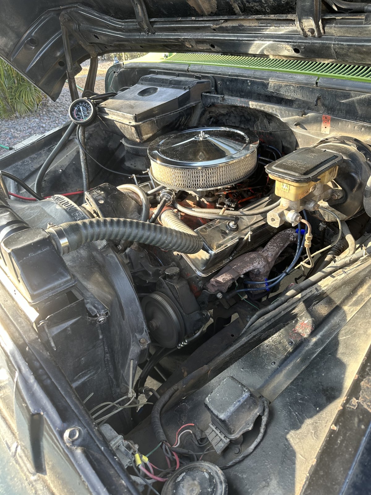

    Alright here we go.. last update to close this thread out... somehow I got it to 6 pages with my overthinking!
    I finished the timing chain set job and it was more a PITA than I thought it would be but no where close to as bad as the dual timing chain and guides I did on my daily driver (2009 Nissan Xterra).
    The oil pan and seal was very easy to work with, the crankshaft sprocket was a *******, even after putting it in the oven at 350 for 30 minute or using a high setting heat gun.. I had to use a harmonic balancer installer and some sockets (instead of pipe). The job took me 3 and a half days (not full days though) because being the clean/neat OCD freak I am every time I touched anything a ton of disgusting black cruddy grease would fall down and I couldn't fight the urge to clean it up.
    Thus far no leaks of oil from the timing cover or oil pan (it used to leak a lot!). No coolant leak. I replaced the belts while I was at it, new harmonic balancer, and all new coolant and new oil and filter, new idle mixture screws. I fixed the issue with the throttle linkage not having been set correctly and kickdown cable and now I can get to WOT.
    When fired up and let it warm up I checked timing and it was at 15 degrees (with vac canister plugged) and I left it there. I set the idle at 800 rpm and adjusted idle mixture screws and had a vacuum reading of 18.5 in Hg.
    I drove it to Fiesta Island not too far from me and then back home and when going up the moderately steep hill it did it no problem at all and I didn't have to press the pedal near the floor like before, I barely was touching the pedal. It felt torquey and similar to my daily driver which has a rating of 261 hp.
    I don't think I need more power for what I'm doing with this truck. So there it is, no more work to this truck planned other than install the electric divorced choke conversion kit I bought and brake job perhaps later in the year (flush fluid and change/check shoes and some lines that have rust buildup). Looking back at where I started with this truck in late 2016, I've done a fair bit. It used to shift awful, I could only steer well in one direction because the P/S gearbox was flexing the frame and it had stripped gears, it always had two spark plugs full of black oil, it would blow a lot of smoke out the exhaust, the mufflers were basically barely hanging on they were so rusted out, it would often stutter uphill or from take-off and leaked oil everywhere including trans fluid. Its way more drive-able now in my opinion after doing all the work to take care of those issues. It felt a bit better uphill but hard to know if thats from the 2G carb rebuild or the timing set. I read somewhere else someone with a sbc 350 noticed better power uphill after changing a timing set that had a lot of slack.

    Yep! Thanks.. already did tighten the rear a little more after the 1st bit of driving.. and had to take the drain pan bolt out and add a copper crush washer. I'll retorque after a couple cycles... (will have to take the starter out thats the only slight pain).
