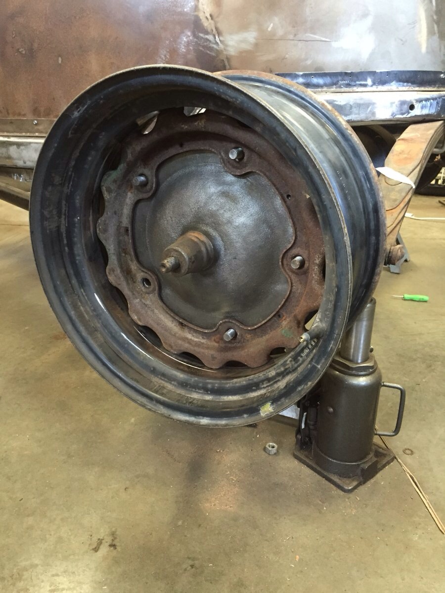

  1. So I decided to remove the rivets of the two wide five 16x3.5 wheels to change out the centers for 5x5.5
    Is there a certain center that I use to fit the wide 5 hoop? Seems this 16" I had is like half an inch smaller all around

    Your wide 5 are 16" correct? Any chance the "new" centers are from 15" wheels?
  3. I just went and measured, the new center is from a 16” wheel

    Might be able to roll a flat wide ring that takes up the space. Measure carefully and tack it in place . Then have it turned true in a large lathe till the center section you have can be tapped in place. Tack again and make sure it runs true. Then weld slowly to prevent warping and check to see that it stayed true. Thats the only thing I could come up with that would look kind of original.

    Why don't you just find 1940 16"x4" wheel. I can just about bet you or anyone else will not notice a half inch wider rim.
    I went the other direction and built wider wide five wheels. I know it's wider but not one person has noticed the wider hoop. Just my two cents. image.jpg

    Now that your 5 on 5 1/2" centers are out of their hoops split the hoops, trim excess off to get 3 1/2" and weld 2 halves of hoop back together. Now you can set back space where you want it as well.

  15. Found I could run 39 lincoln centers

  21. I've got a '40 center in a wide five 16x3.5 and its too small

    39 Lincoln Centers will fit those rims but they're pretty hard to find. The other option is finding a 16.3.5" that has a deeper drop center which is also hard to find.

    OK--so I quick measured some wheels. OD--gross outside diameter of the wheel and ID is the measure of the smallest inside diameter of the wheel (Where the center mounts). Steel wheels are either '40 style Ford for the 16" or for the 15" they are the F100 pickup style ran from mid '50s to mid '60s. I also measured a 16" wire.
    Ford Wheel
    type O.D. I.D.
    16" wide 5 17.5" 14.25"
    16" Steel 5 x 5.5 17.5" 13.75"
    15" steel 5x 5.5 16.5 12.75"
    16" wire 5 x 5.5 17.5" 14.125"
    Hope this helps!
