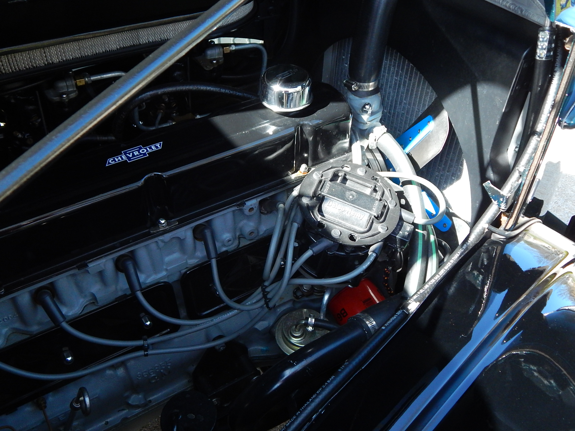

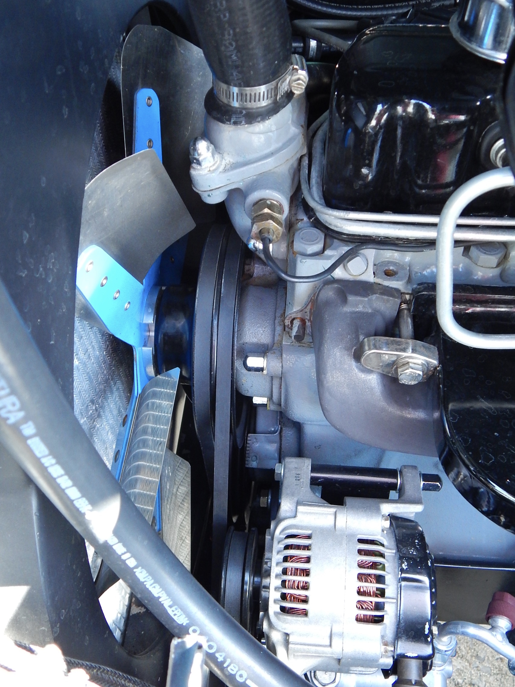

    I have this 17" fan on my 250 inline Chevy. I am having heating issues setting still with A/C on. On the road it runs 180* all day, set in a line for 4 or 5 minutes it starts climbing but not over 212* according to the gauge. Will a solid steel fan pull more air, and will the 250 pull it? DSCN1691.jpeg

    Weird that it would start doing this after being dialed in for so long. Might let it run and watch the fan to see if it’s flexing flat and not moving air now? I’ve had some of the black plastic ones really get out of shape after some years

    It's been doing this since the A/C was installed, the engine doesn't idle all that fast. It does have a shroud but being in a '37 truck, the shroud and fan are as wide as the radiator. If I have the room, I think I will try one.

    Low mount water pump is an issue, but the 17" fan covers a good portion of the core. I have the radiator moved forward and down as far as I can get it, but space is still tight. I went to the 17" thinking it would pull more air then a similar 15 or 16" I had, but it didn't, poor design I guess. DSCN1702.jpeg

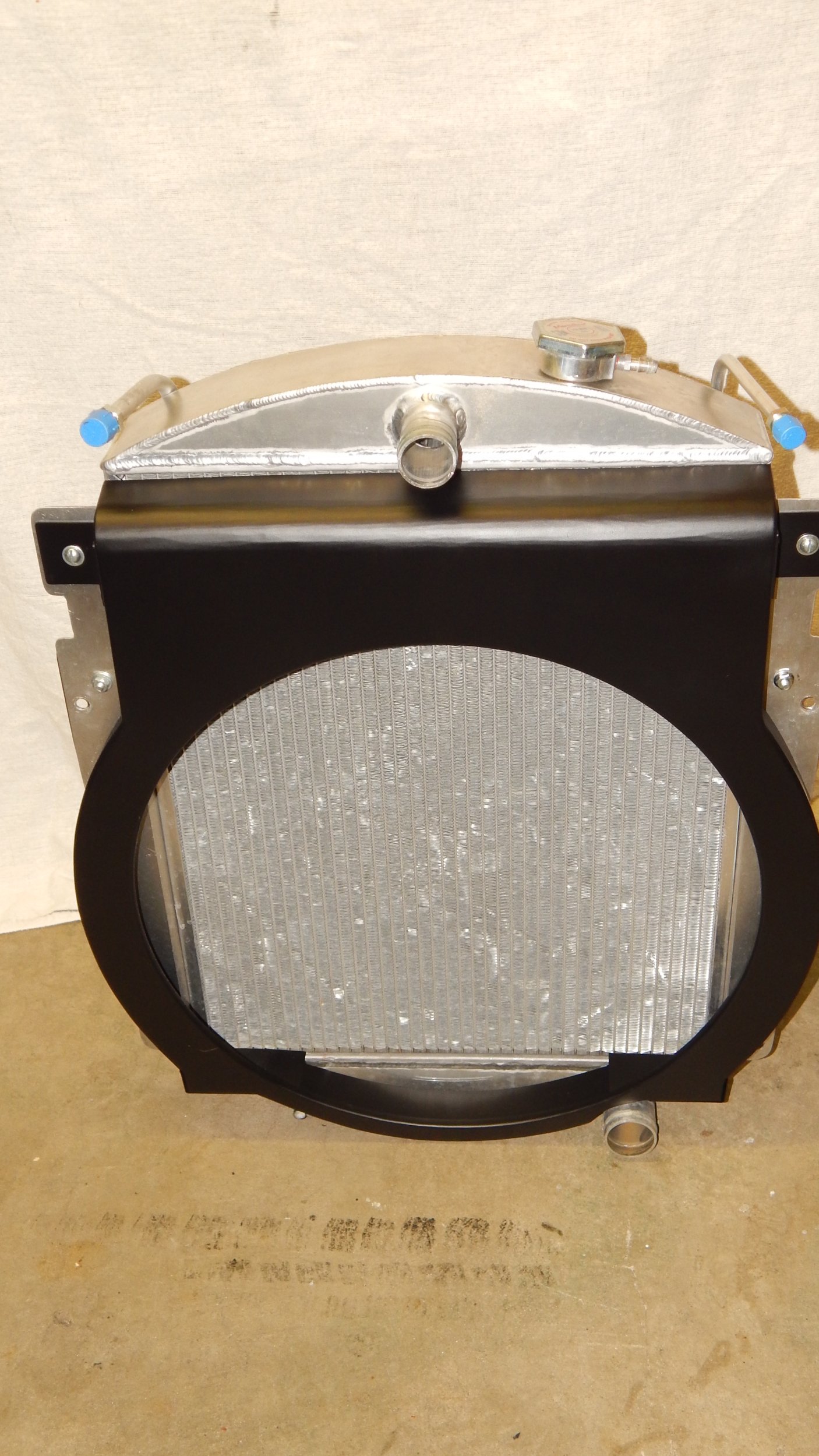

    thats a cool shroud!! bought , or built??? the fan has way enough coverage to make it work....how deep the fan is in the shroud make s a huge differance...I ve seen those flex fans flatten out in the shroud and actually block the air, they cavatate and make a wall of air inside the shroud.... with the towel test, it would **** the towl to the grille ... but not strong... then run up to 2000 rpms and it would drop....

  17. Per the photo, the radiator and shroud look fine for the task. The problem must be the fan. As has been suggested, go with a solid-type fan (no "flex" blades) and position it in the "sweet spot" of the shroud opening. Use spacers as needed to position the fan correctly in the shroud.
    Just Gary likes this.

    Problem is with the space between water pump and radiator, I don't have any! There is 2" from the nub of the water pump to the radiator fins, and a little more then that back to the balancer. This is a stock 250 engine, not a high rpm killer, while idling very little air movement can be felt around the engine. It won't hold paper to the grill at idle.
    I going to have about 1/2" from fan to radiator with one of the solid 6 blades, this will also put the fan about half into the shroud, and if I step down from 17" to 16" I will have roughly 1" clearance around the fan, as it is now, there is about 1/2" clearance with the 17". I used the flex fan because most of the blade is on the back side, the steel fans 75% of the blade is in front.
    My water pump pulley is a #3900434 ( '65 - '68 Chevrolet ), 7" diameter. My balancer is a dual groove with 1/4" spacing, there is also a dual groove with 1/2" spacing, I have a 5 3/4" diameter water pump pulley for the 1/2" spaced damper ( space between the belts ).
    A smaller pulley would help a bunch, I don't know much about the Chevrolet engines so if you know of a pulley smaller then 7" with the same spacing as the 3900434, let me know.

    It's an on going issue since adding a/c. Pretty sure it's related to the big water pump pulley not turning the fan or pump fast enough. The balancer is slightly smaller than the water pump pulley.
    Not sure how hot it would get if I just let it go on idling.
    I am doing everything I can to not put an electric fan on it, the radiator is as far forward and as low as I can get it. If I take out the 1/4" spacer at the fan, the blades hit the balancer. DSCN2920.JPG DSCN2914.JPG other option is to move the engine and trans back and shorten the driveline, not sure I'am ready for that yet.
