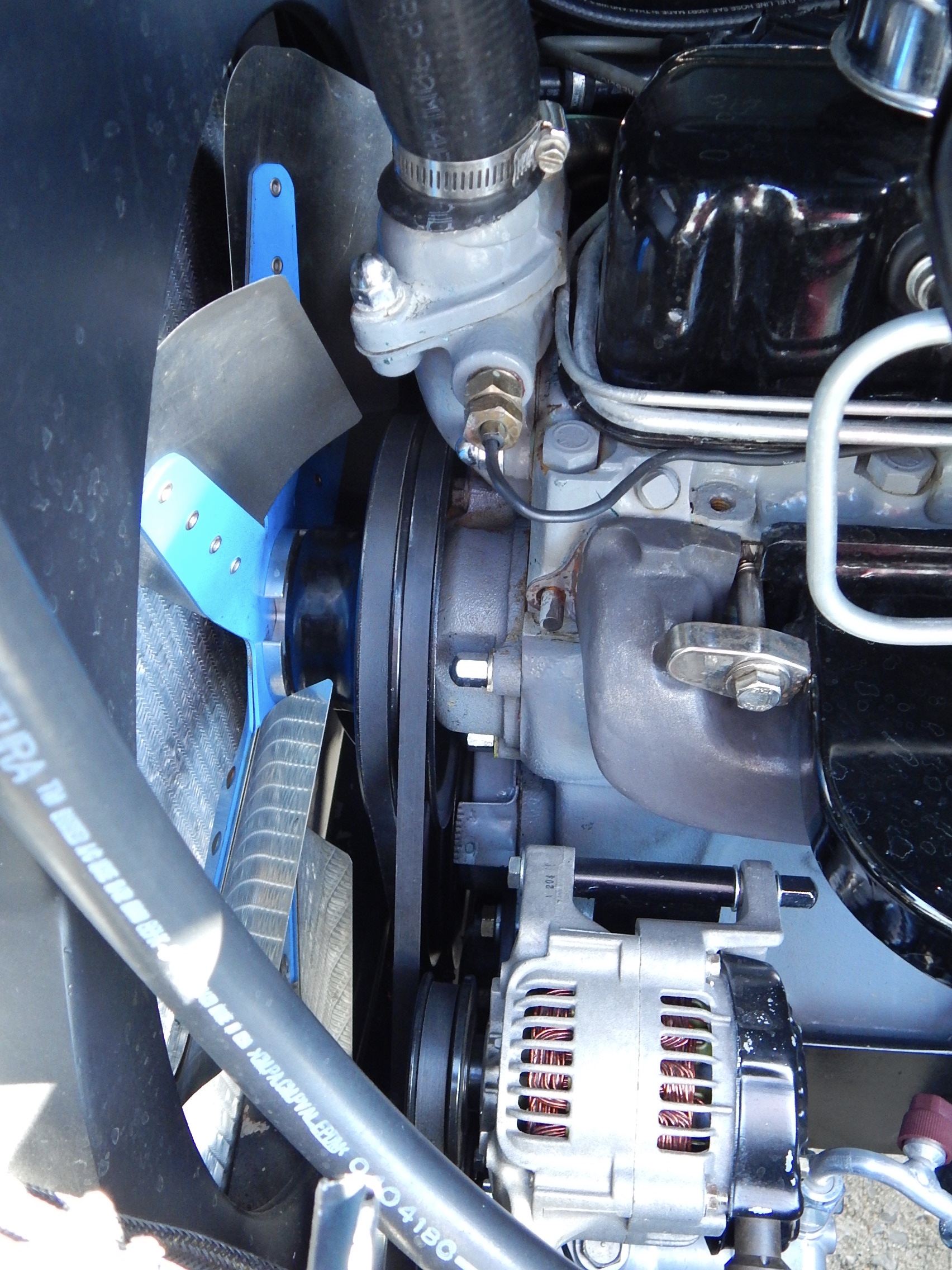

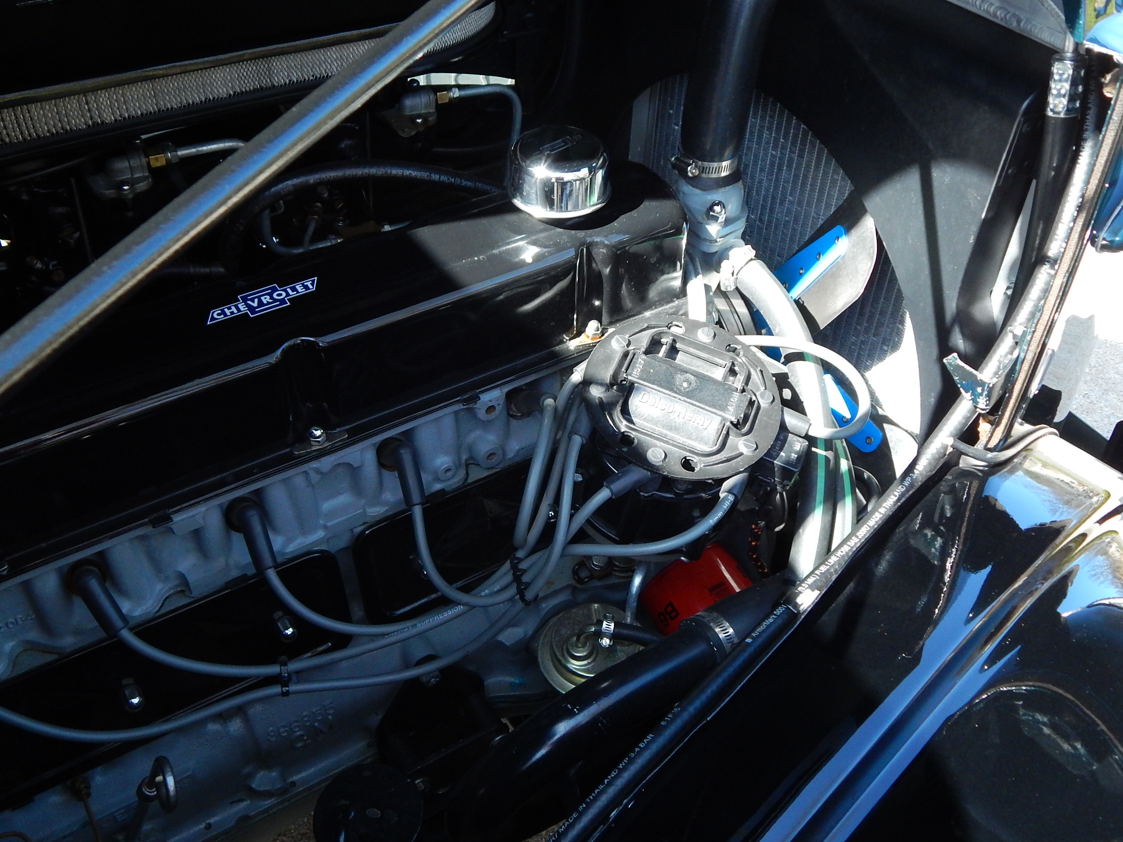

    looking at this pic...when that fan flattens all its doing is blocking air flow...

    The fan flattens at high speed. He writes it is a low speed/idle problem.

    The new fan from Speedway came yesterday, 24 hours from order to the door! Its pretty nice looking, and is a 50/50 split front to back, ( they should advertise that fact, it would be handy to know for guys with clearance issues ). I went with a 17" steel six blade replacing a 18" flex, a 6.25" diameter pulley replacing a 7.125" diameter, and making a new shroud for the smaller diameter fan. It will spin the water pump and fan a little more then 100 rpm faster. The new fan has a more aggressive pitch to the blades so I am hopeful this will work out.

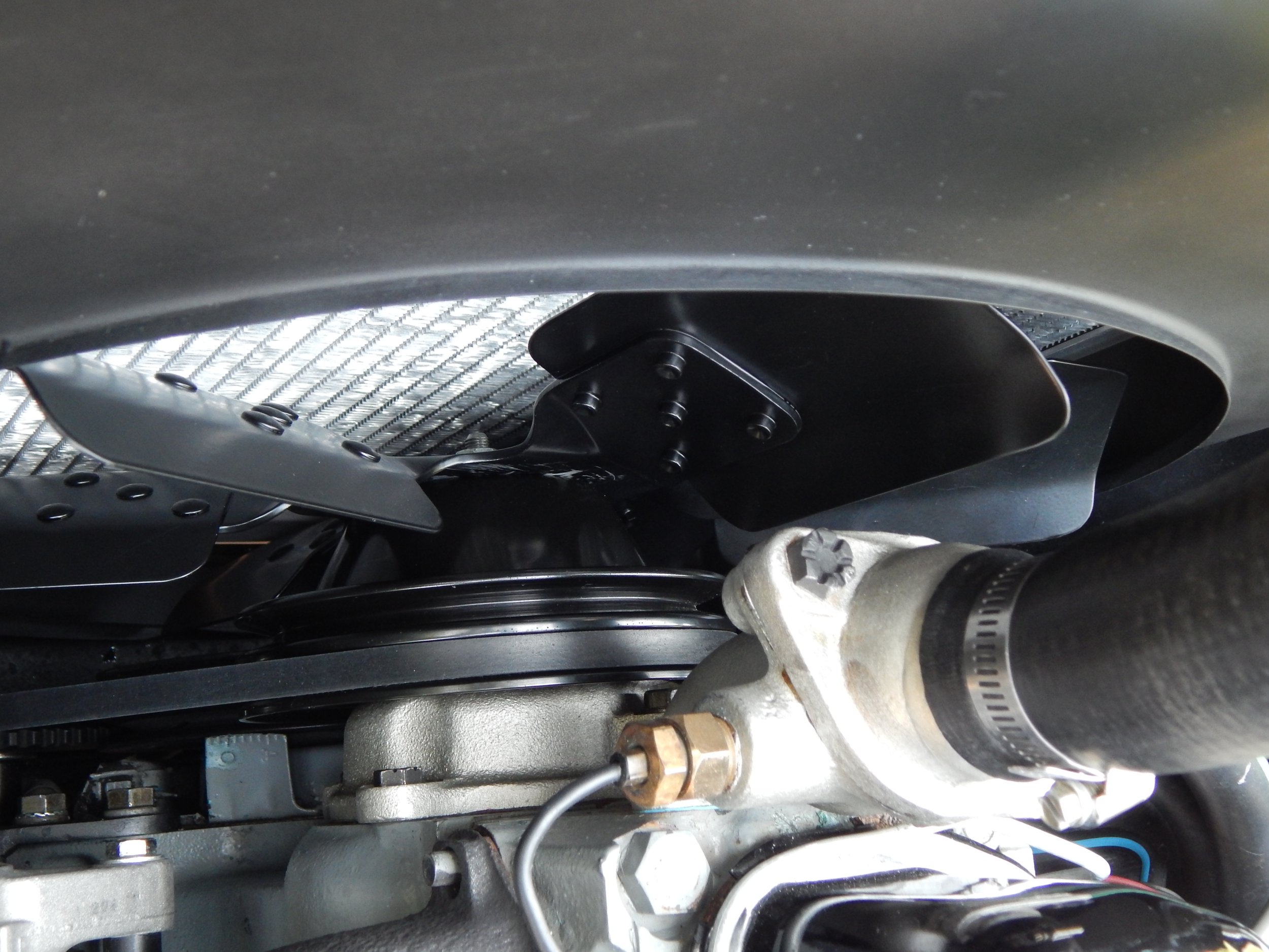

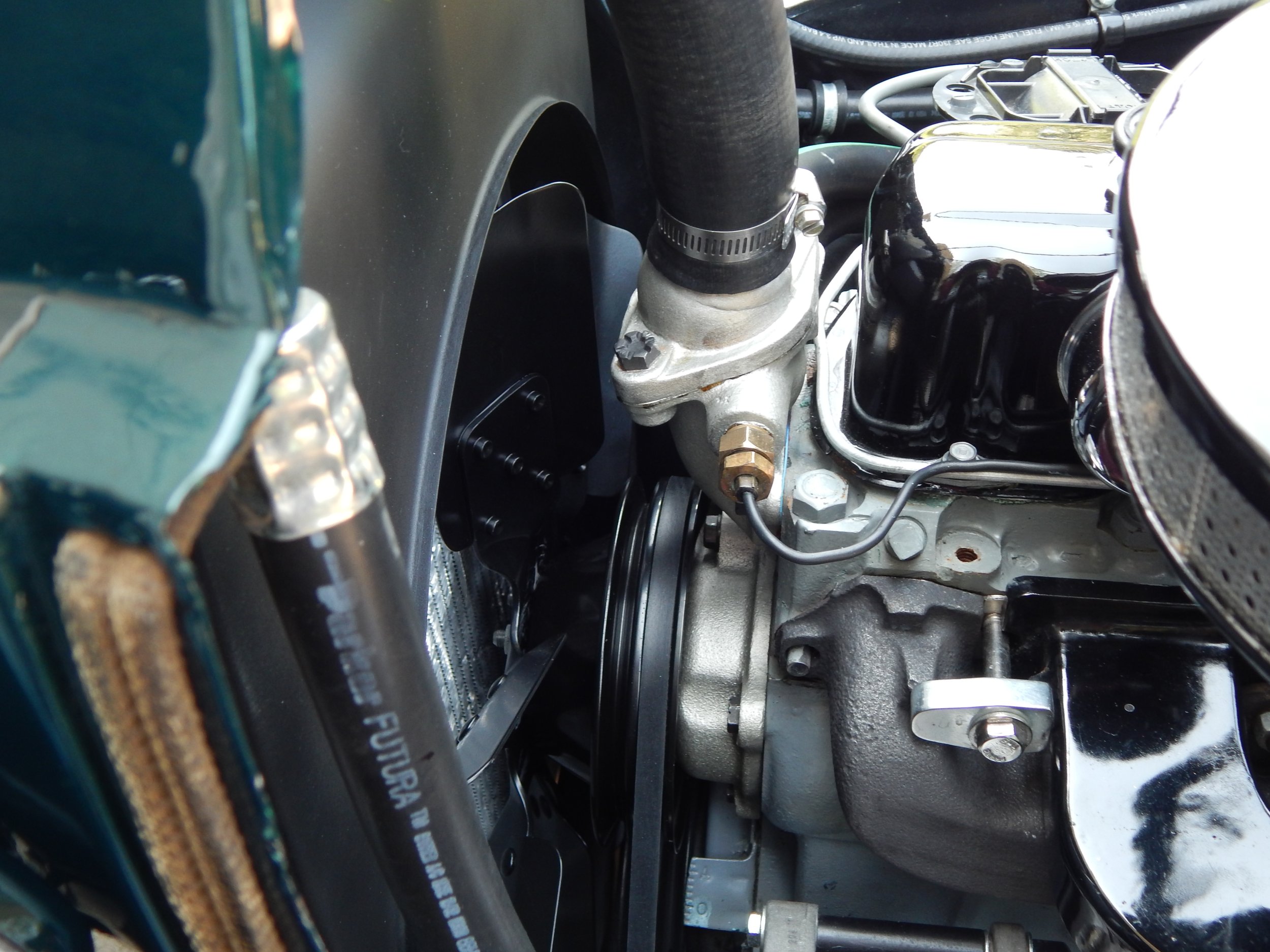

    So I finally had time and gathered all the parts need to finish this up. I purchased a Vintage Air 17", 6 blade, steel fan, a 6.25" water pump pulley, new water pump and sheet metal for a new shroud. I switched out a 18" flex fan and leaking water pump.
    I believe the problem has been solved, it never got over 185 setting idling for a while, though the hood was off. A/C was plenty cold and even cycled the compressor while idling. The smaller pulley will speed up the water pump and fan just under 100 rpm, so that helps a bunch. Shroud has a 17 3/4" diameter, and the fan is dead center of the opening. There's enough air blowing now you can actually feel it being pulled in the grill, the flex fan wouldn't do that. I do have rubber dams to go over the top of the radiator, had to pull them to get the hood ornament off so I could pull the hood out of the way. The Vintage Air fan blade has pitch from front to back, the flex fan blade was about 25% flat across the front and the rest was pitched. I believe that made the difference, at idle the flex blades couldn't have been flexing at 750 rpm. DSCN1231.JPG DSCN1235.JPG DSCN1236.JPG DSCN1237.JPG DSCN1239.JPG DSCN1242.JPG DSCN1234.JPG DSCN1263.JPG
