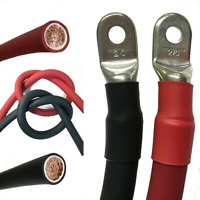

    I relocated my batt to the trunk in my '54 and used twenty feet of 1/0 copper welding cable. I got everything from these guys and can't say enough about them!
    https://www.batterycablesusa.com/
    Top quality 'made in usa' products, great prices and their shipping is crazy cheap! $3.97 flat rate! They've got everything you'll need.
