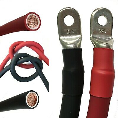

    Ebay for sure. When I was looking for cables for my car, I saw some good quality marine-use stuff. Granted most were short for trim tabs and engine tilts. I ended up having a local speed shop make mine up while I waited for $35.
