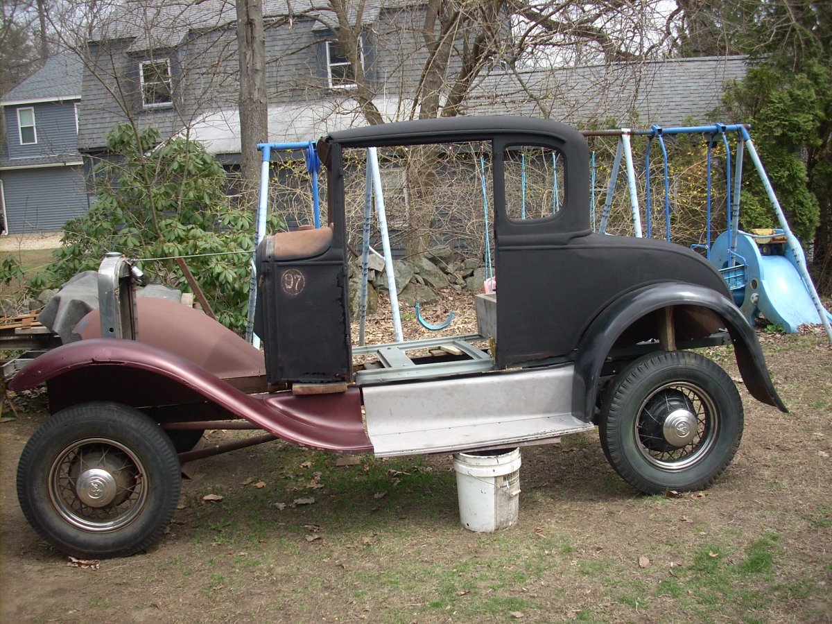

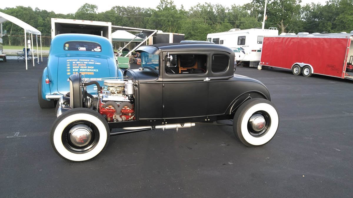

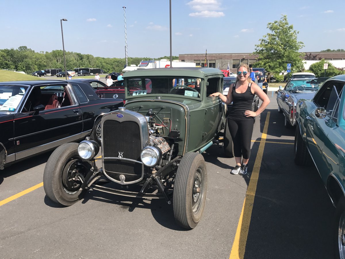

    IMG_20170723_134204.jpg My sons car, on A rails with a 3" chop. IMG_20170714_193955.jpg
    Blues4U and 31Vicky with a hemi like this.

    Zee the "A" rails. This is not done very often these days, but it lowers the car without having to cut much of the body.

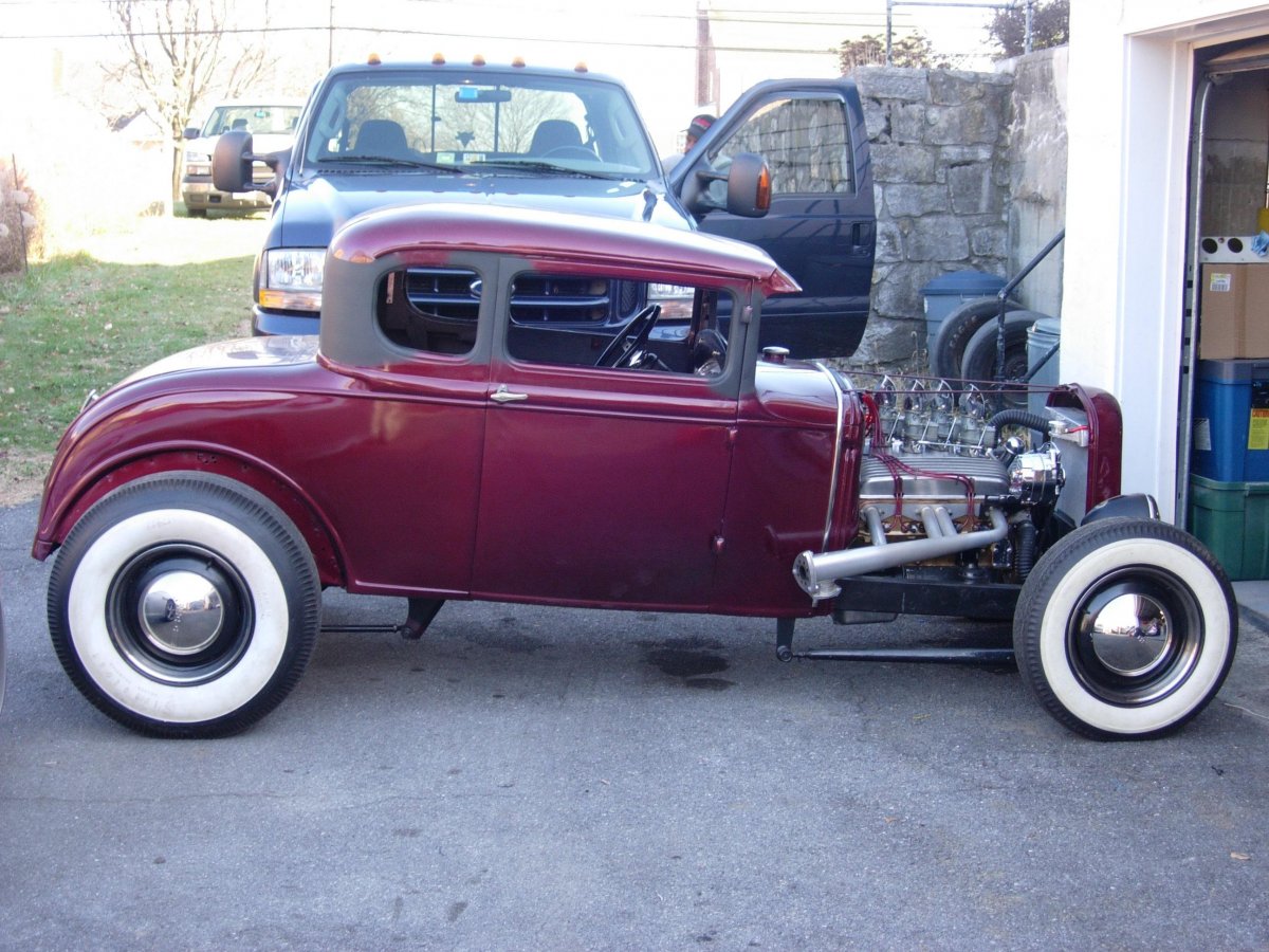

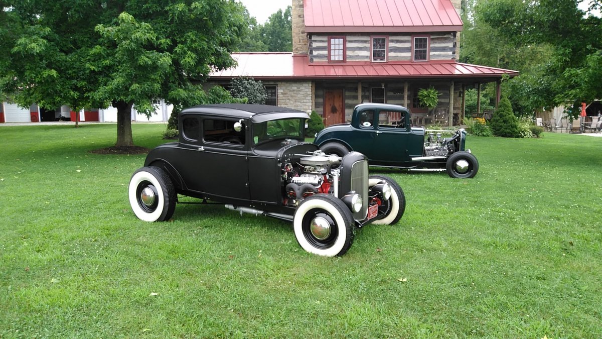

    IMG_0737.JPG IMG_0751.jpg I built this 2 years ago. 1930 with 3" chop, Zed width of frame, 32 K member, wishbone and pedals. Halibrand quickchange. Biggest challenge is F1 box and header, had to move box into frame and make up headers. I would not channel any car. Joe

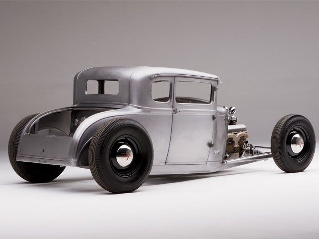

  15. I've always loved this car.
    It's lowered a pretty good amount though! Just right

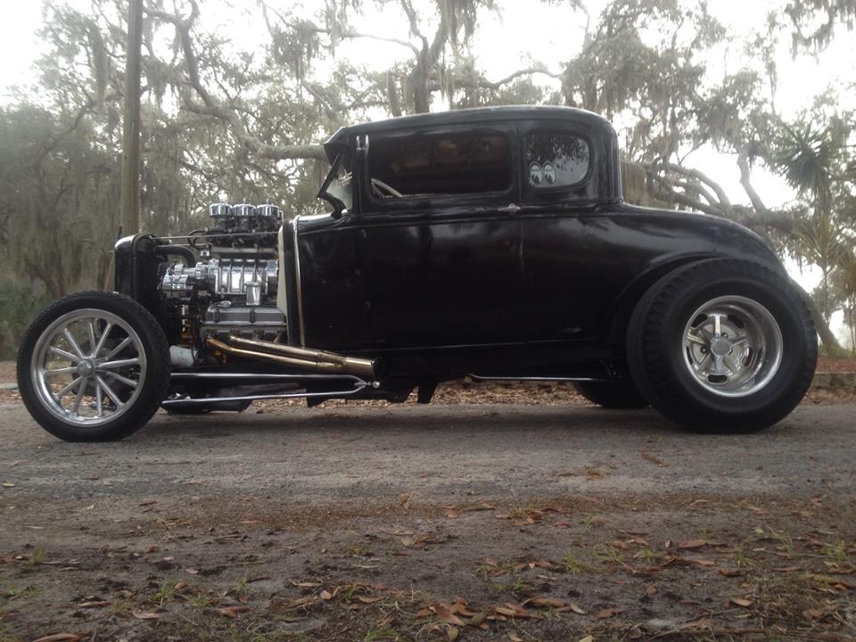

    That car looks sway backed &'broken.
    Like a 500lb gorilla and his 800 lb girlfriend busted the rear springs and bent the frame.
