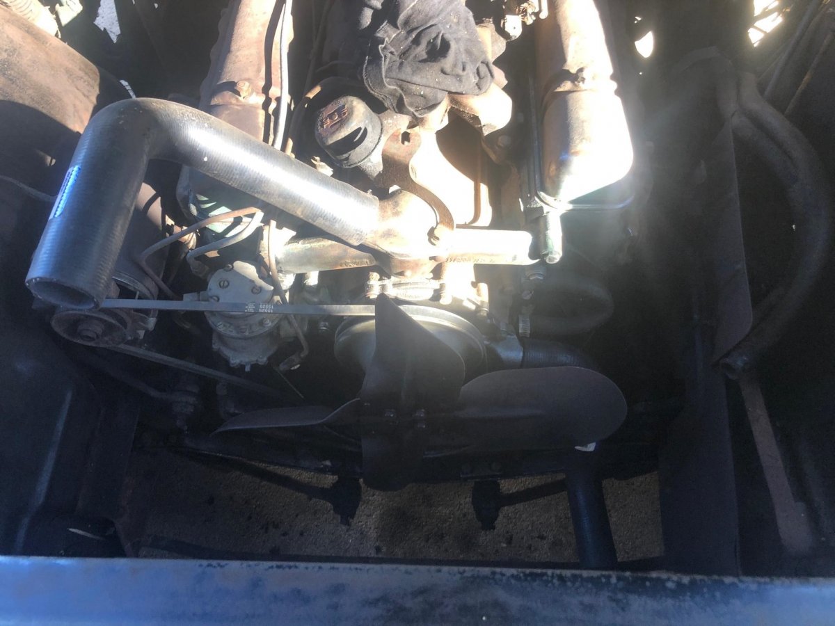

    did get it to start, no smoke and smooth, small tick from lifter otherwise for the short time i ran it , was real good. water leaks eveywhere. the trans cooler is 2 water lines from the water pump to the trans, pretty weird. carb, water pump and hose next

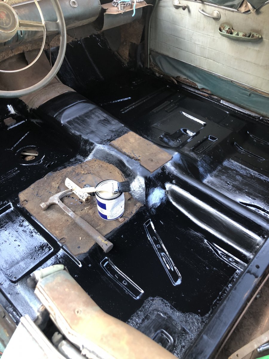

    floor came out nice, still have rear seat well and trunk encaspulated floor.JPG

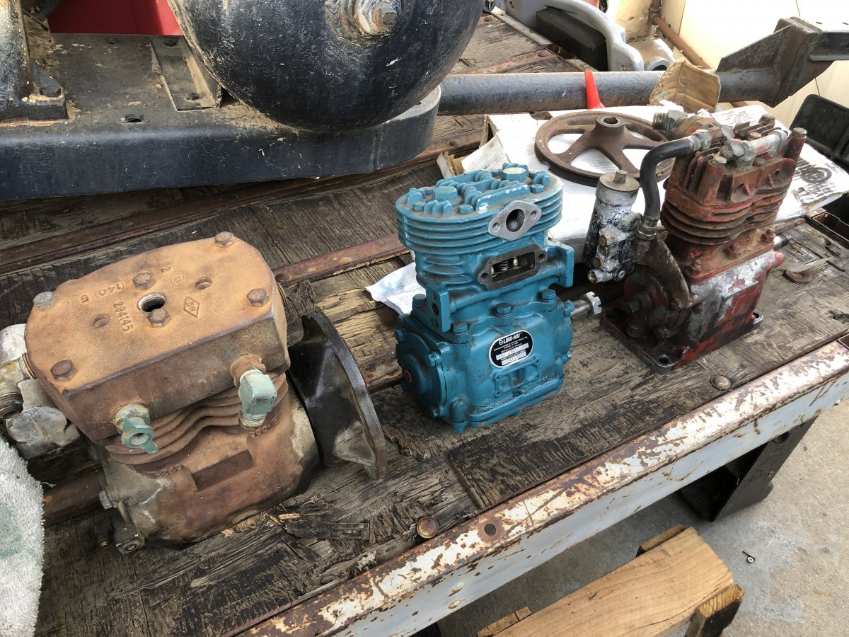

    floor coating is eastwood rust encapsulator, dig that roadmaster. today i changed the oil and filter, put a new water pump on, new belt and hoses... a little here and there getting closer.. waiting for carb and radiator to get back from shops. the other project has hit a problem my 53 flxable bus had a detriot diesel with a gear drivin air brake compressor i need one for my big block chevy with a pulley. any ideas? cant find a compressor with a pulley. new hose 54.jpg

    Belt Pulley driven air compressors were used on 50's and 60's gas burning big trucks like F700's and G60's. Any old truck junk yards around? May be something from a school bus? A good truck parts dealer should be able to find something you could use, they weren't that uncommon.

    yes that is what i need a good old junk yard

    If you have not finished building your BBC , you might want to install a high volume oil pump. Most belt driven air compressors oil from the engines oil pump. If I remember correctly there were some trucks with the belt driven air compressors on the 427 and 366 big block Chevies.

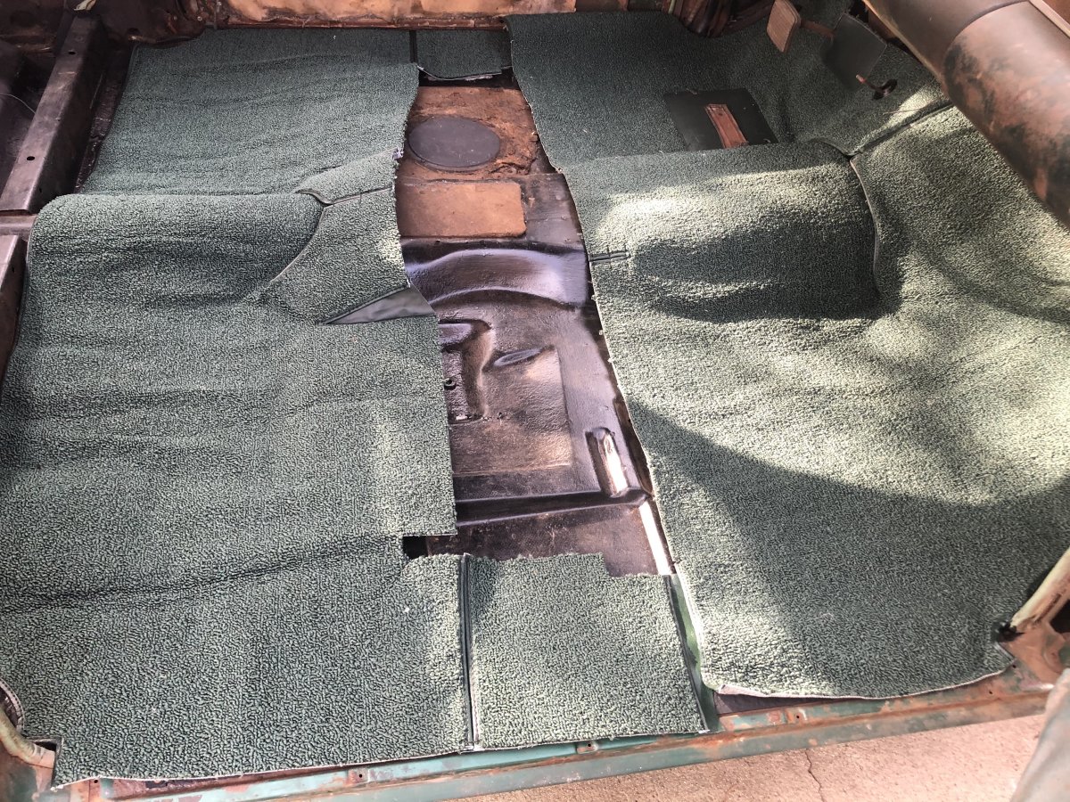

    got it sorted out, thanks. for the help, now back to the 54 new carpet, waiting on gas tank, sending unit and seats. IMG_2822.JPG IMG_2825.JPG IMG_2820.JPG
