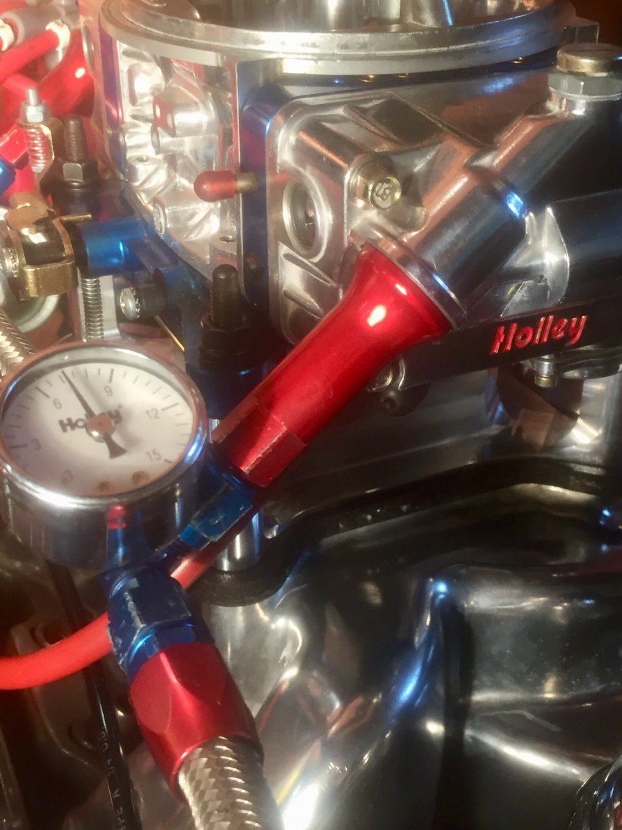

  8. 8E5D55AA-61F8-41C5-A5CE-9774B421BFB7.jpeg Timing is 25-26 idle, 35-36 all in at 1800.
    Full vacuum Advance.
    “Generally , you can cover up a stumble with accelerator pump cams or shooter changes .“
    This is what I had done. Way too much pump cam and shooter size was corrected by upsizing P jets 10%,
    3 sizes.
    Also didn’t know about specific pump cams Holley suggest for Pro linkage. Change to them helped.
    As far as weather/humidity effecting driveability, we’ll see as summertime is just around the corner. I’m pretty close to sea level here.
    Amen to drilling holes !
    I might play around with S plates. Holley says leave setting alone unless
    car has radical motor. My cam is 233/241, 530/545, 110’. IMO, not so radical ?
    I have full control of idle speed w/idle speed screw, and 1/4 turn of any idle mixture screw effects idle quality.
    Another ?, Holley says start with idle mixture screws 1.5 turns out, should be very close. Many have posted idle screws 1.5-2 turns out. I have never been able to run this rich on 3 different cars. All three cars (BBC, SBC, 400 Olds) and 4 different Holleys seem to like 3/4 turn only on idle mixture.
    What does this tell you ?
    A lot of fun, getting everything out of a DP Holley ! IMO, amazing pieces of engineering. Just wish I could predict the outcome of changes.
    Full access to secondary throttle plate adjustment , you can see a thumb screw just above pressure gauge.
    (For some reason, my pics always come out at top of post)

    Jenkins comp , if you're actually running with 7 lbs of fuel pressure ( picture) , you might try reducing that to 5-5.5 ,that plus your float heights can change idle / transition slot performance characteristics.

    RE: fuel pressure, I’m told these gauges might be off 2 or more #’s. Must admit gauge is more for “poser hot rod” looks
    than for reference. Hahaha.
    If fuel pressure drops, it’ll be at big end,
    not idle ? Gauge would have to be plumbed to back side of hood or dash
    to have any real value.
