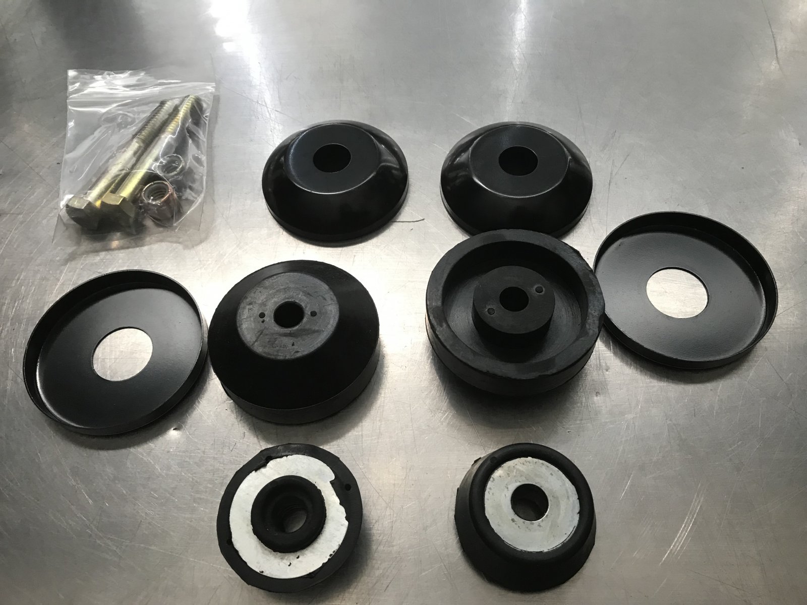

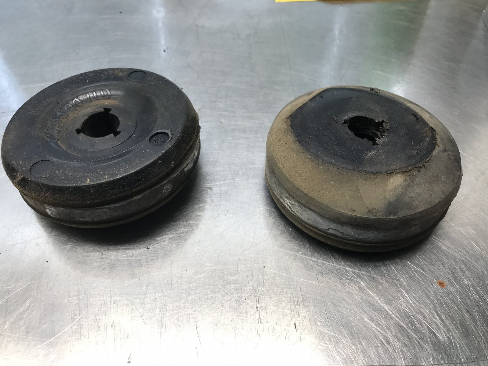

    Johnny…I used it and the bolts, big base and washers with the temporary cushions. They were not nearly as hard. 86AC1725-D6A2-4B22-B794-6E201393DC53.jpeg

    ^^^^^ See the little cushion that goes under the frame portion of the mount?
    Deuces likes this.

  9. 51pontiac
    Joined: Jun 12, 2009
    Posts: 519
    51pontiac
    from Alberta
    044FA42E-6F4F-4C37-844C-9CAB25392FC6.jpeg Yup..I had it in place on the old mounts and reused it with the temporary cushions. It works well as an isolator with the large hole. They were in ok shape, not nearly as hard as the biscuit.

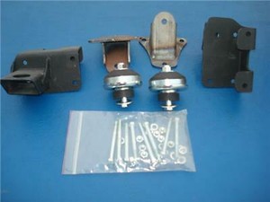

    They may not be the best one out there but you can buy the top and bottom pieced for a 52 Ford F-1 Motor mount from Rock Auto for pocket change. 1952 FORD F1 3.9L 239cid V8 Motor Mount | RockAuto
    You do need the cushion top and bottom of the mount on the frame. Otherwise when the cushion collapses a bit the bolt will move enough to bang on the bottom side of the mount on the frame.
    Easy to find locally and not very big are 55/57 Chevy motor mount biscuits. they will only work if you have a bolt size hole in the mount though. They won't work if you have a hole for the Ford mount to work with.

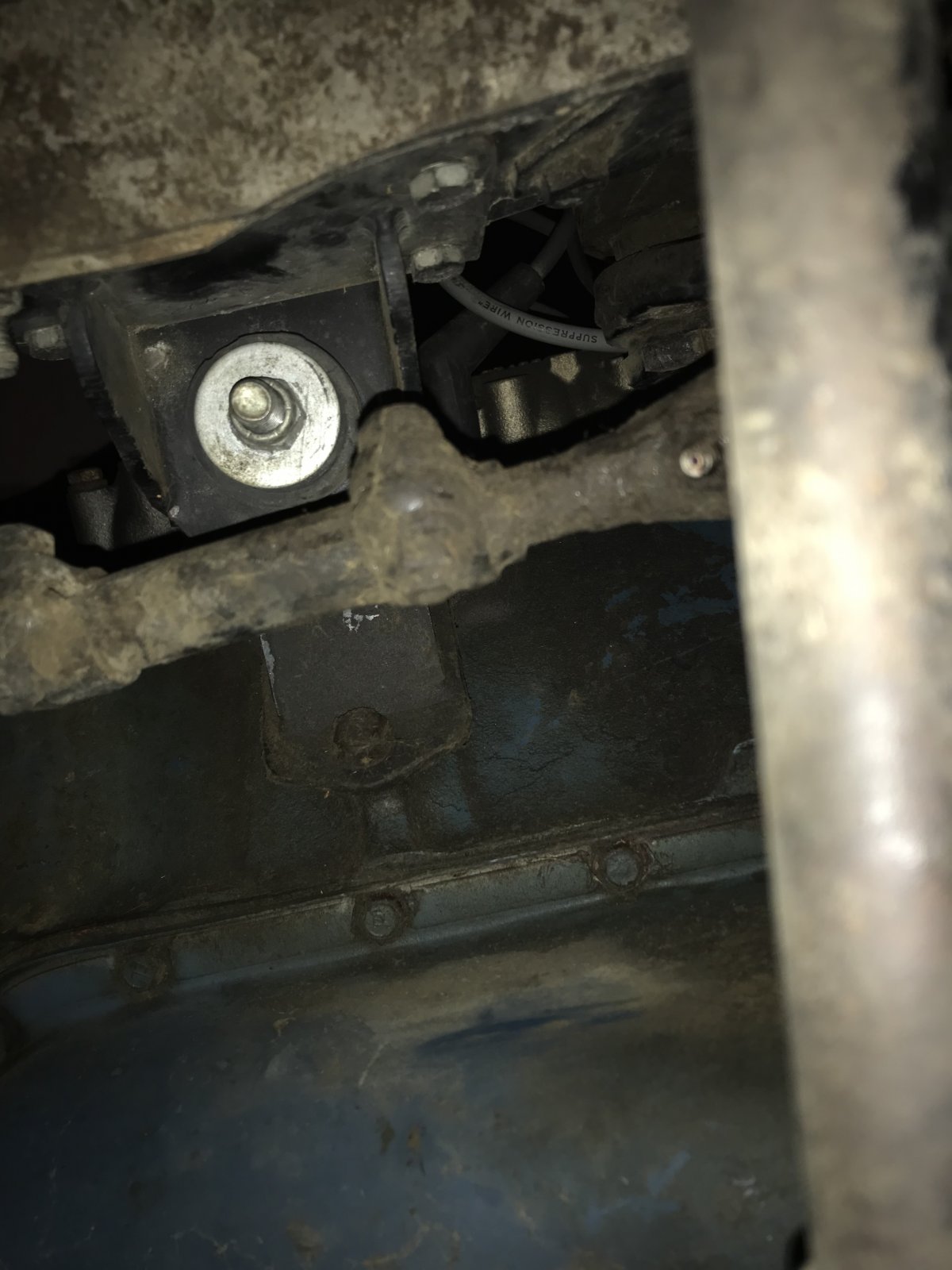

    478A6B7D-0DEC-46F4-B4D8-7618B37CFCB3.jpeg 62DE0B04-23D7-40CA-BDBD-025F1F0BEE39.jpeg Just to wrap this thread up I figured I would report that the new mounts ( transdapt 9314) are installed and work well. The car is now nice to drive, very little vibration transferred to body, frame or steering. As well, it is now running nice thanks to the complete tune up. Still a few details to tidy up but it is definitely drivable now so it should see some miles on it before the snow falls.
    Big thanks to all who threw in their 2 cents…it was appreciated!
