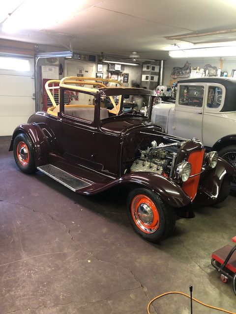

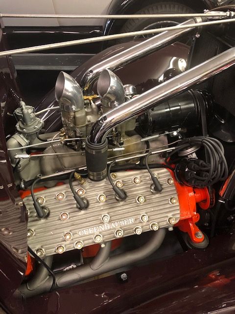

    IMG_5261.jpeg IMG_5261.jpeg Losing water? 48 flatly new build! Today I did a radiator carbon test on a warm motor went well test stayed green no yellow. Had re-torqued alum heads to 55ft-lb in sequence prior to test. As I was doing test on the new Br***work radiator I noticed with cap on and rapped the RPM’s up I could get water to puke out of down tube from over Flo ? And it really flowed quite a bit. This could be the culprit. Wondering why.. then as watching that the left new water pump from speedway (high flow)was sending a faint pulley spray on fender? After shutting off motor and removed the new radiator cap to my amazement I watch the water slowly rise in neck and trickle out?. Figure with what had ran out on floor it should be low! I’m new at flatheads this is puzzling. Thinking a compression test might be needed. But oil is very clean and plugs are new. Any ideas ? motor was not hot. IMG_5262.jpeg I have drove it 40/60 miles round trip and had to add a gallon or so of water. But really no sign of where it go’s other than later today finding the radiator dump tube flushing out. Thank you fellow rodders !

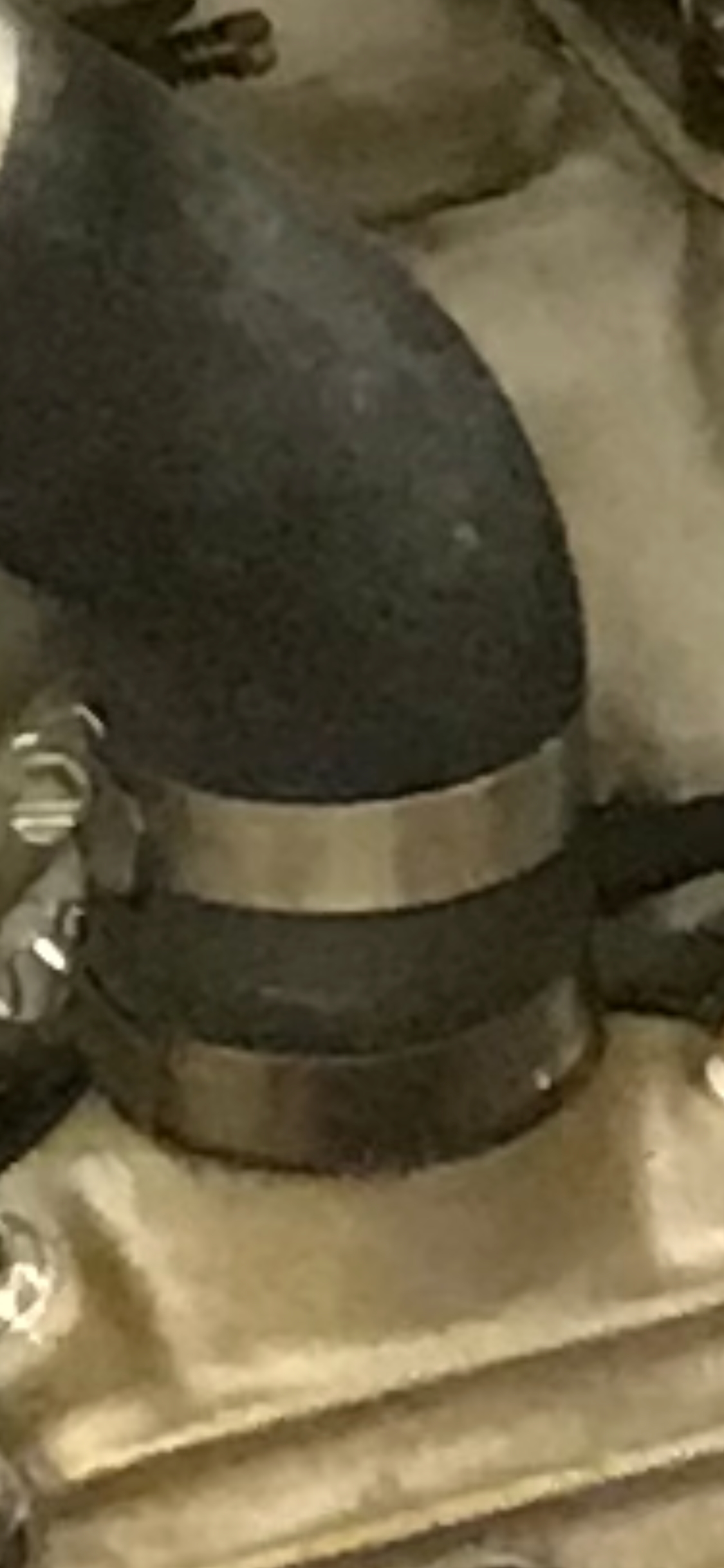

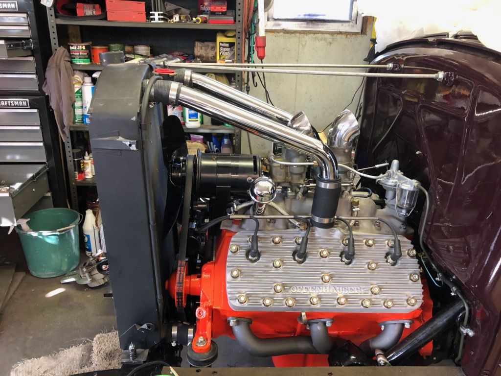

    block /head, I used the hose clamp to hold the Sat against the outlet so it could not capsize , Same can be done with all rubber , you could allso take a pipe & snug fit inside hose , a-just depth & only use 1 clamp @ outlet , Just @ time I was Lazy IMG_2728.png

    I'm running a 4 core Br***works radiator on my 8BA powered A with early heads and haven't lost any water, I do have 160 degree thermostats on both sides. I did install an expansion tank and run a 6 pound radiator cap. You have a real problem if you're losing a gallon of water in 60 miles, I would think you should be able to tell where the leak is unless it's internal and going out the exhaust. The expansion tank is in the first picture, I have several thousand miles on the car and have never had to add water.

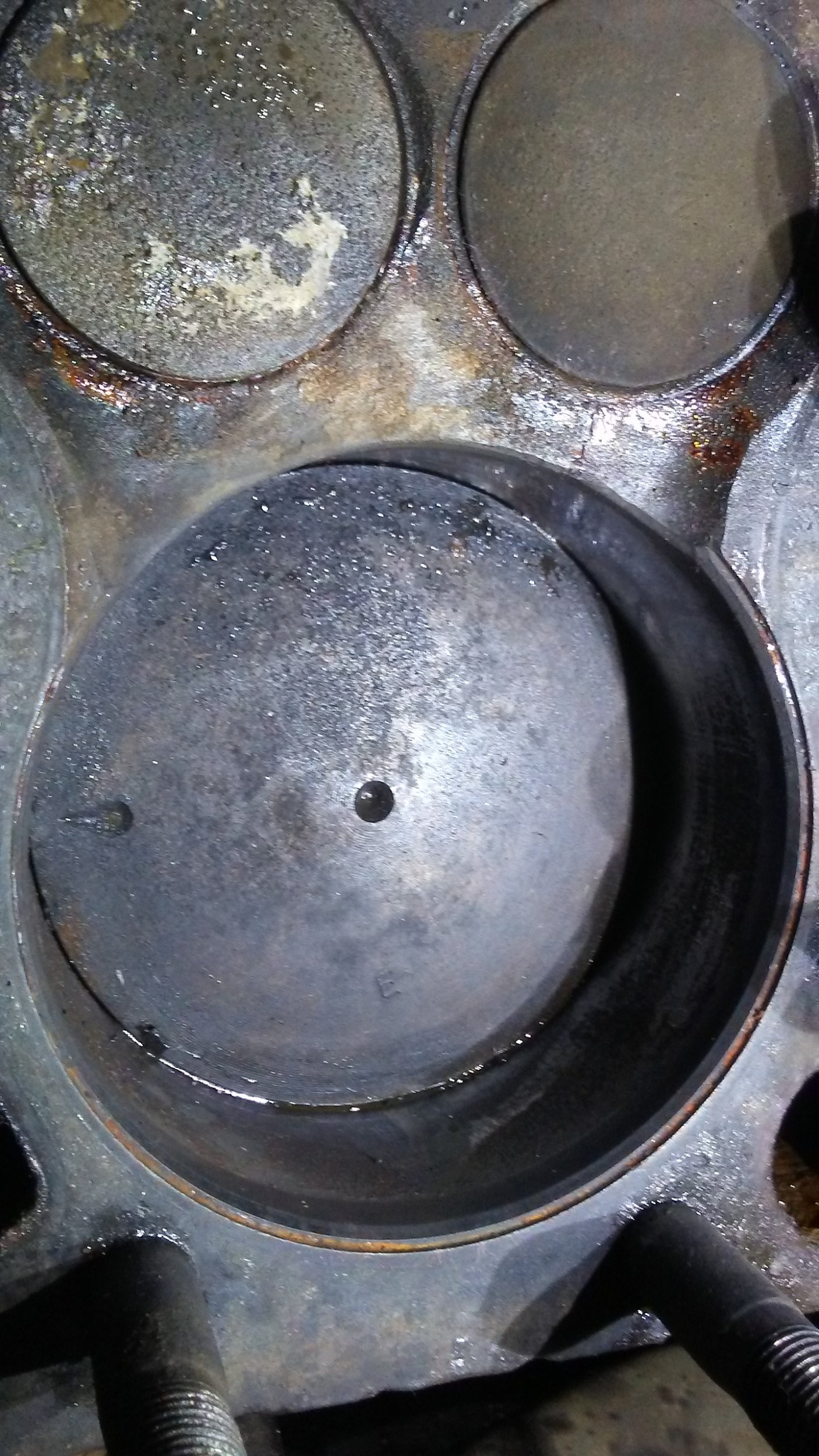

    The 59AB in my 40 would mysteriously loose water until it would overheat.
    Tried and tried, to no avail, to find it.
    The autopsy when it blew finally showed the culprit.
    See the crack between the valve and cylinder.
    Worst case scenario, hope that yours is easy.
