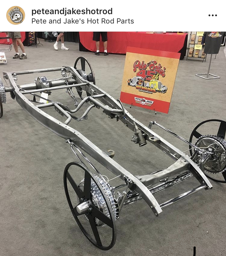

    Did anyone take a close look at a ch***is that was in the PeteNJake booth with the Borgeson Saginaw side steering setup? Was the steering box mounted to a separate bracket that they had made? Any pics of the box and mount?

    I was over there a few days ago I’ll check this afternoon to see if I got a better photo that shows

    Looks like it’s just bolted to the boxing plate with a spacer on the top bolt to angle it correctly. I’ll look for a clear photo or get one later

    Same geometry as the Mustang boxes used to do, but using a newer box?

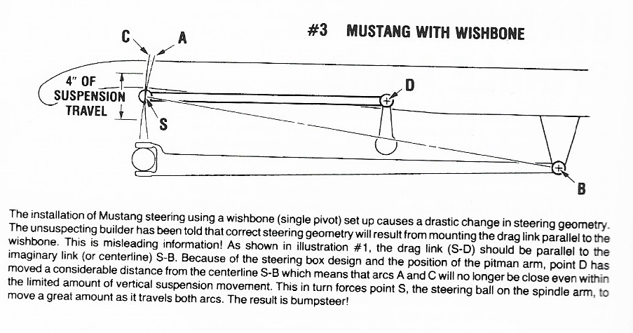

    So; how is that set-up different than this "bumpsteer" drawing from their catalog?
    mgtstumpy and chryslerfan55 like this.

    My question as well. Their show ch***is is a single mount locator (hairpins) yet with the S-D vs S-B relationship not right.
    Borgeson does make this box with a "reverse" directional orientation, allowing the pitman arm to mount pointing down (vs. up as shown) yet would, I believe, produce the proper turning scenario, i.e. turn wheel to the right, box pulls on the steering arm...you go right. Don't know whether the pitman arm is indexable to allow this.
  13. gearheadbill
    Joined: Oct 11, 2002
    Posts: 1,339
    gearheadbill
    Spoke(e-mail) with the Borgeson tech dept. the pitman arm is splined and can be indexed to run vertically down which, using the correct box, will produce the proper relationship, similar to using an early Ford-style box.
    Still doesn’t explain the setup shown on the pictured ch***is. Confused as to why, if it doesn’t work properly, a major iconic supplier would be promoting it. Must be more to the story.

    Yeah the longer arch probably helps. This ch***is is pretty low I’m not sure how far the pitman would drop indexed the other way but it would probably be pretty damn low.

    Tim, those pics are not the same ch***is. You've got a regular Vega steering there, and the subject is a side steer box.

    Ah so it is! They are nearly identical other than the steering. Hadn’t noticed that they had two at the show.
    Wonder if the one in question was ordered that way as it was and maybe delivered at the nats? It didn’t appear to be at the shop after the show.
