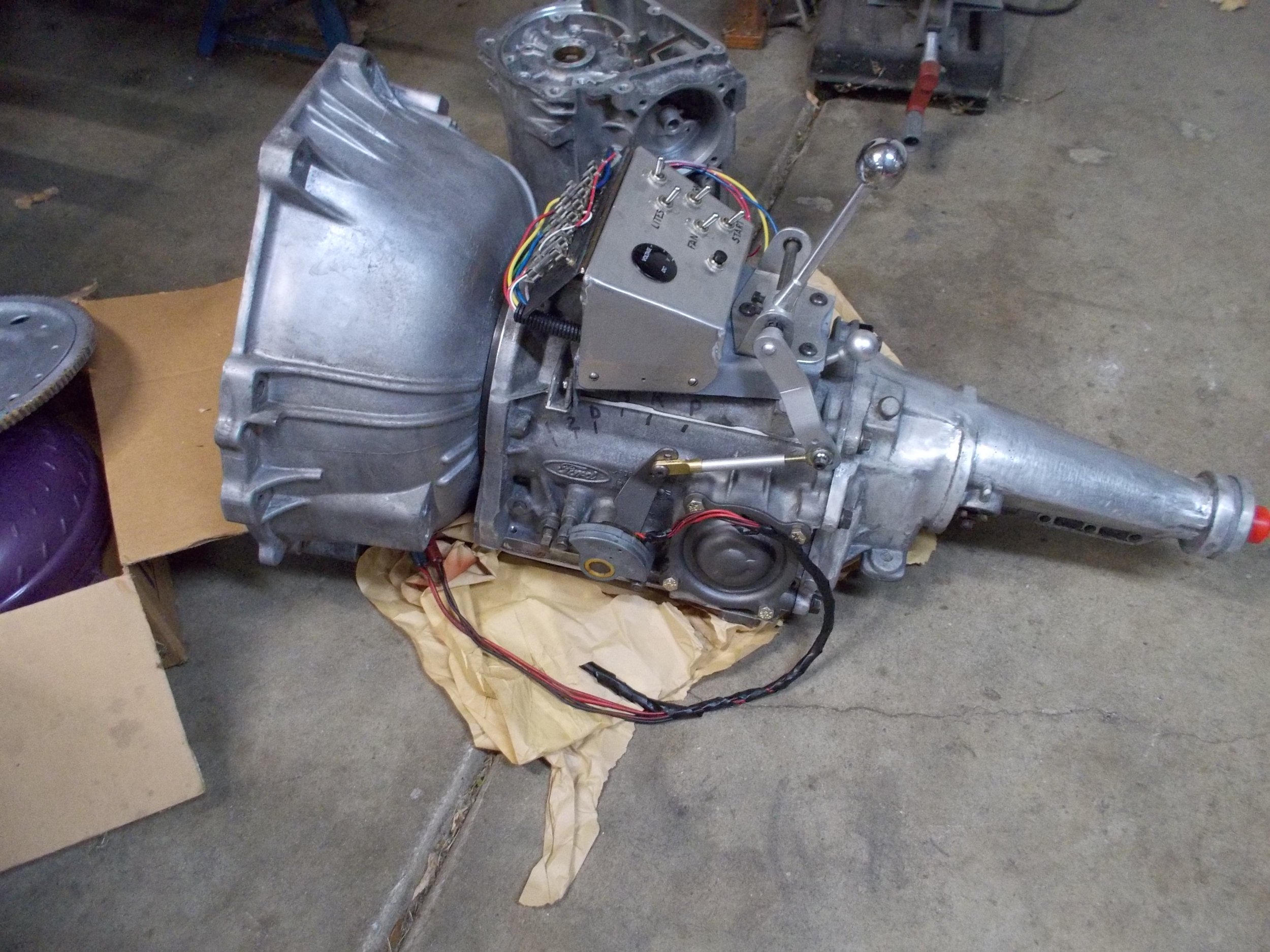

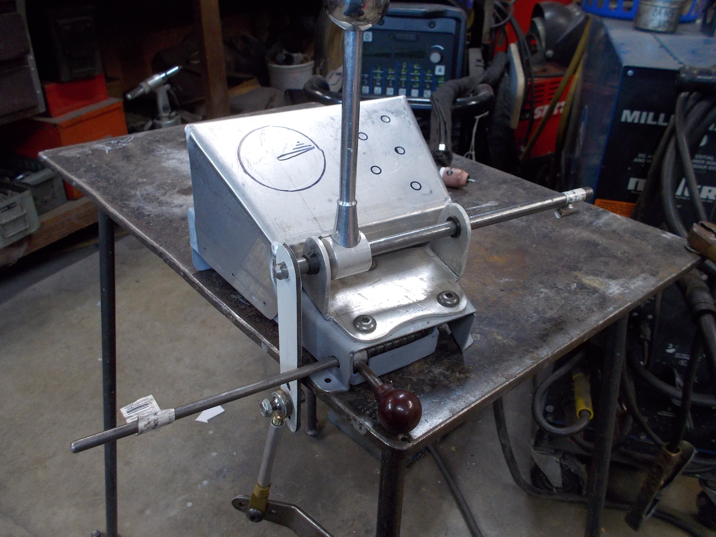

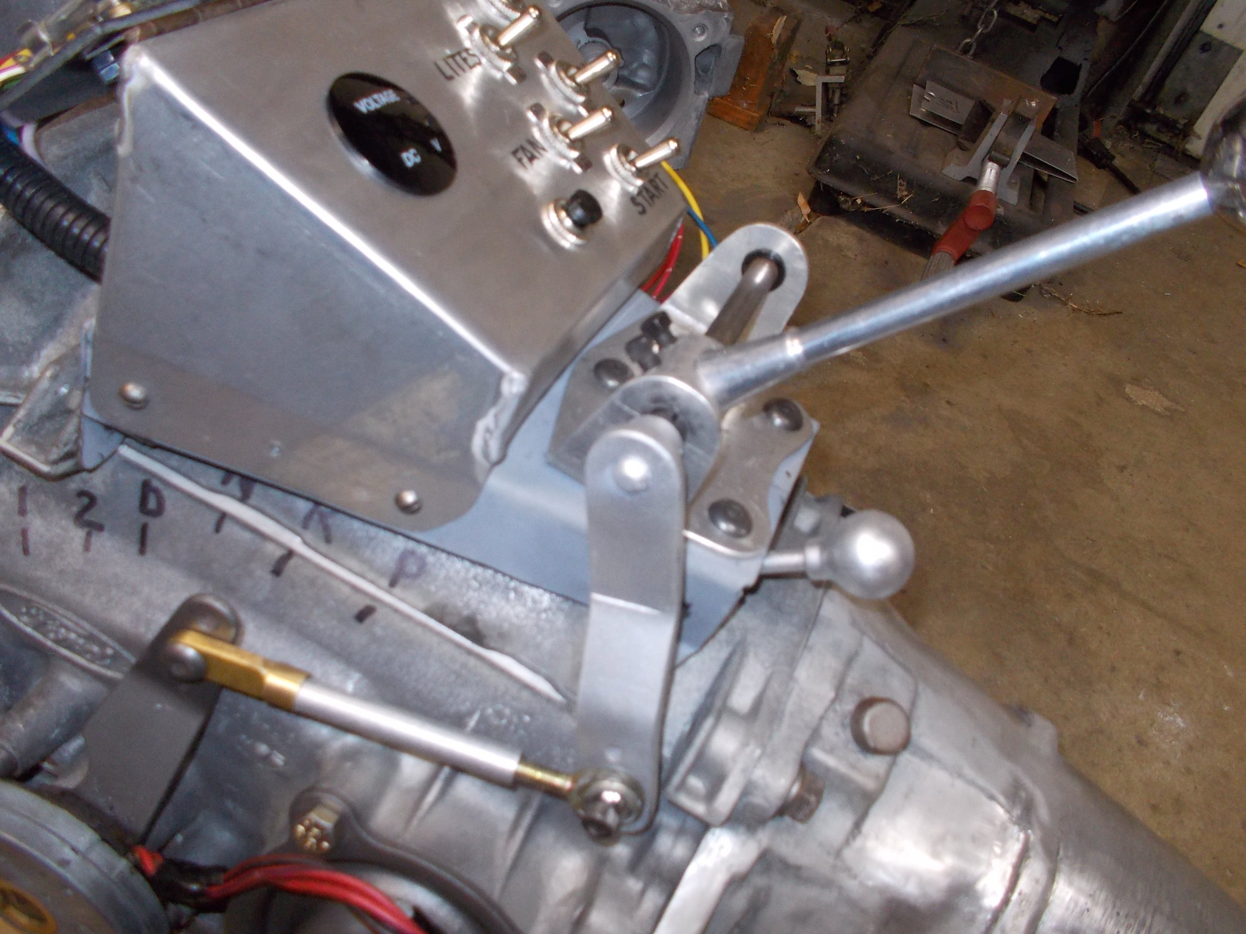

    If it is to be a single seater space is at a premium. Do not use a manual. You will have to have the shifter between your legs. BTDT. Not good for street driving.
    I used an inline six / C4 auto on my latest build. Check out my complete build below. Mine will be street legal too.

    My single seat speedster has the T5 between my legs, but will create a linkage so it looks more period correct with shifter on outside of body. Not hard to do from the little research I’ve done. Couldn’t imagine shifting between my legs while driving.
