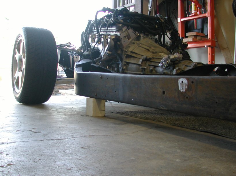

    Mercury Charlie's frame is not something I would see myself buying. Now if I won the lottery that would be a different story. Then I would be building a Merc that I would show, tilted up with a full length mirror underneath. So if I am going to paint that frame candy red or just chrome the entire frame, I would certainly appreciate all the welds being ground,etc.
  23. My Merc has a 80's GM frame under it, was told Bonneville but am not sure. Sure looks like a lot of work, I'd rather change the frame then do what the build did to do all that work.
  24. axle
    Posts: 4,013
    axle
    from Drag City
    Nice work Mercury Charlie ! Its no wonder you're one of the heavy hitters in the Merc industry !
  25. oldebob
    Joined: Oct 21, 2008
    Posts: 782
    oldebob
    from Spokane WA
    I would take a look at a 80's up Ford Crown Vic for a frame and donor parts. It's late model pieces and it has a full frame . The pre 89 ones have a 351Windsor. OB
  26. CharlieLed
    Joined: Feb 21, 2003
    Posts: 2,464
    CharlieLed
    I grafted a 1992 ZR1 Corvette C4 IFS/frame clip onto my Merc and fabricated the rear frame section to accomodate the C4 IRS as well. It worked out well except for the fact that the engine has to sit back a good ways to clear the rack and pinion...seems a shame to have to mod the firewall for engine clearance when the engine bay on these cars is so big to start with.
