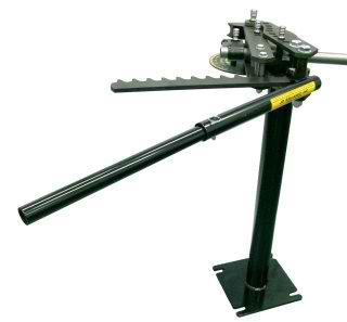

    Something like this..

    the Baileigh is not much different than the JD in concept, either is a great bender. I use a JD now, I would consider the Baileigh for my own purchase with the ratchet workings it has.

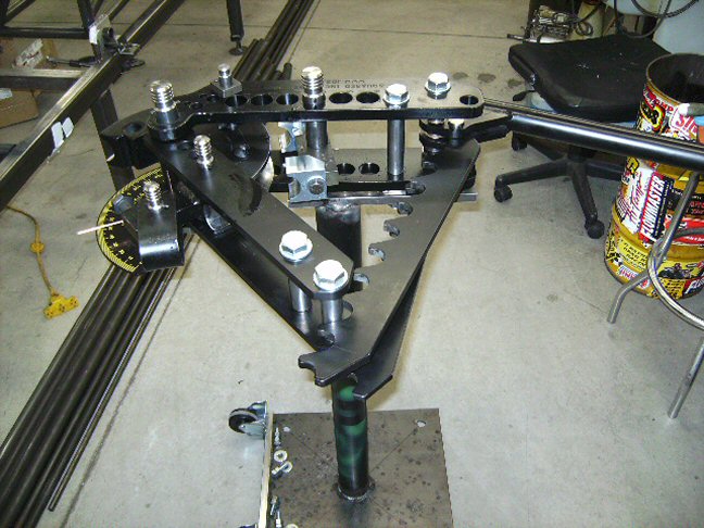

    I have the JD squared model 32 bender like pictured above. I like the anti spring back features of the lower jaw and the pin that follows along the die. Look at those two improvements and you will see what I mean.
    I was working on this tonight with it.

  18. JD or Pro would be a good choice. We use that style every day, to the point where we are replacing parts every 6 months or so...not a knock on the benders, they are being used by 40-50 students just learning how they work... The Baleigh unit you pictured looks good because you don't have to reset the bend arm when you run out of ratchet, but I'd make sure you have AMPLE room to walk around that giant "saw blade" ratchet!

    I have to agree, the ratchet is nice! The locking base plate does look bit big, but I think the ratchet system is much safer then pulling on a sweeping type pull handle..

    Very cool Glen, thanks for the pics... cool project and thank you for the info!

    ya, if you look at the model 32 you can see the second set of notch jaws on the bottom, that is to prevent spring back while you take another bite with your bar. The top also has a pin that slips in and out of the die itself as you move around the die.....so you can take another bite with your two notched jaws when you get around to 80 degrees or so.
    the pins are also upgraded to 1.25 over the model 2
    Here is a demo: http://www.youtube.com/watch?v=_P1MBhBjiqI
