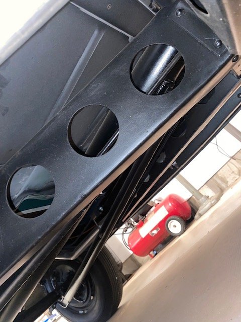

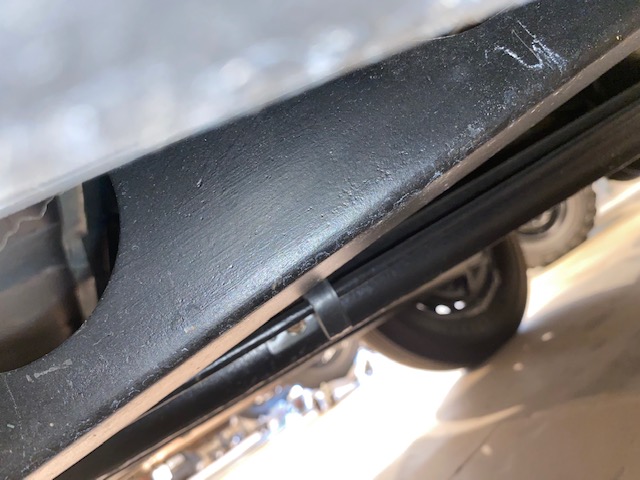

  5. 36and63
    Joined: Mar 21, 2017
    Posts: 77
    36and63
    from Wisconsin
    IMG_4270 (1).jpg IMG_4274.jpg I really like the Eastwood Ch***is paint - used on three frames now all with really nice results. pics are from my 36 pickup that was done around 6 years ago and really holding up well.
    Almostdone and mad mikey like this.

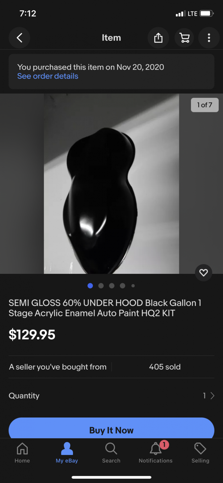

    Joined: Mar 6, 2006
    Posts: 1,579
    dsiddons
    from Indiana
    I painted my entire car with this stuff. It’s on eBay and found it laid down real nice and mocked GM under hood paint .
