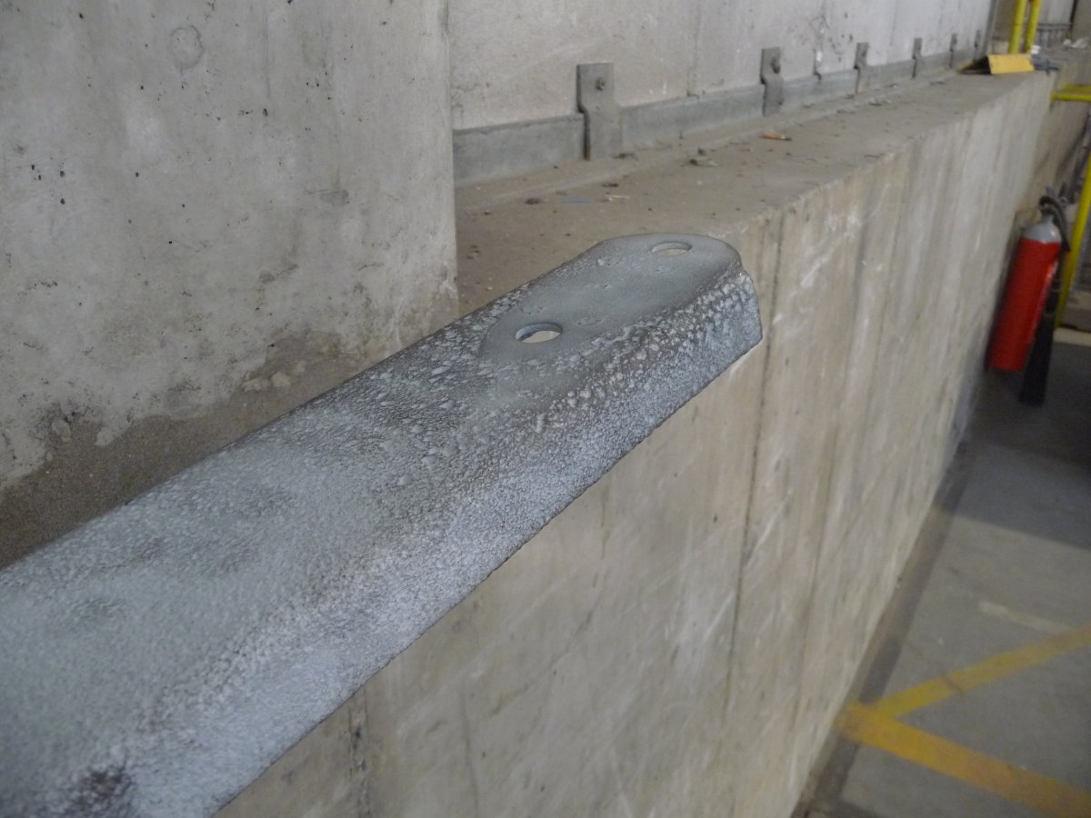

  5. Sorry for the late reply.
    It's like this process :

    Metal spraying.
    Haven't seen that process done for a while. Pretty neat.

    I would be not happy the way the metallizing was done, normaly after sandblasting, there should be no trace of rust . The surface now, looks not like everything was metallized properly.
    I do Sandblasting for profession since 30 years. Anyhow, if the look of your ride, should be oldstyle ; leave the imperfections, paint it 2 k and show the age.... just my two cents:)

  12. The "rust" you see, is done by handling the ch***is to work on it, come from jackstands, tools and dirty by our hands.
    I can tell, there's no more rust on it.
    The result I'm looking for is something like the Henderson roadster.
    Simple, not especially a show car but must look nice.

  26. Thanks you all for your replies !
    Metallization isn't a wrong method. For a brand new ch***is, it will be perfect.
    You can let the bare metal in the rain for life, it will never be rusty !
    But mine is 87 years old and was damaged by rust.
    It was blasted on september and still in bare metal now.
    We cleaned up the surface with this brush with a good result.
    The problem is when you apply the acid on the metal, it's impossible to clean the asperities properly.
    The acid stay in the holes and lead don't stick.
    I think, it will be sand blasted again, but without any treatment next.

    It's allways difficult to tell from pic's without all facts.
    We have restored manny vintage cars, Jeeps and Land Rover's with brand new ch***is that where metalsprayed and encountered this very problem . In the years before we used to go the liquid ammonia-way and leave it for 2-3 weeks to the elements in the garden but we have developed further, in the last 10 years or so, it proved to be effectiv to Spray liquid ammonia:
    mix 10 liter of normal water with half a liter of liqud ammonia ( Salmiak 25% at the drogist-shop) 1 s**** of dishwascher soap, mix well, use a scrubspongepad and rub the surface well in the detail-area too, until a gray foam developes, after 10 minutes leaving this foam rinse well with normal water. After complete dry start to paint with primer soon ..
    ( sinc salt develope quick without noticing ).
    paint it with RUCO reaction primer or something similar . then go on with 2K filler and 2K topcoat. We had no flaking off or anything, eaven though we use the cars for heavy off-road and pressure-wash for decades.
    Don't forget that the metalised process is not raching the hollow rooms and backcut areas, they have to be treated differentley, for which we use Anti corrosion-grease for steeleropes to flood the hollows : Liqui Moly 6173 or Mike Sanders, just to name a fiew.
