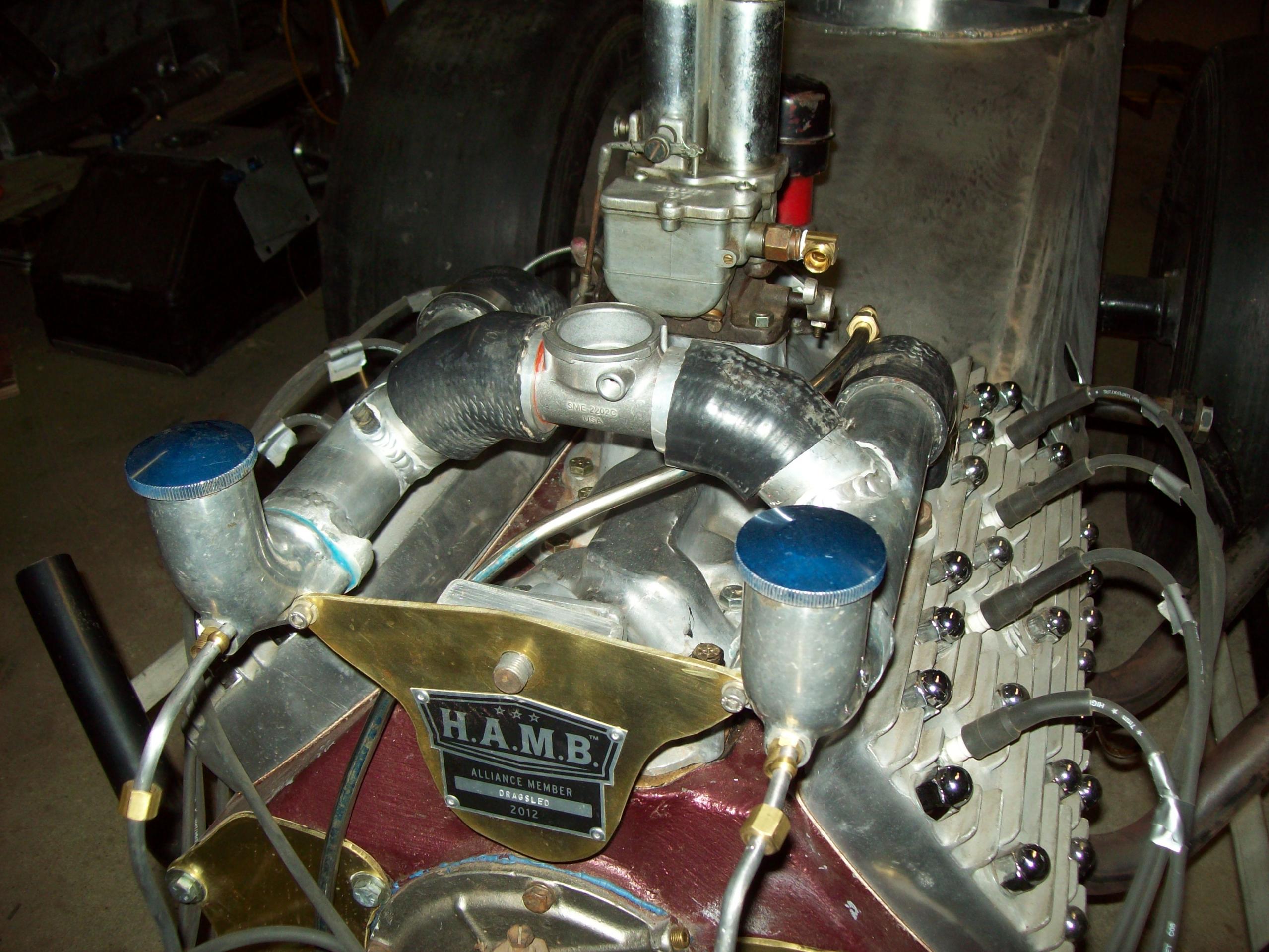

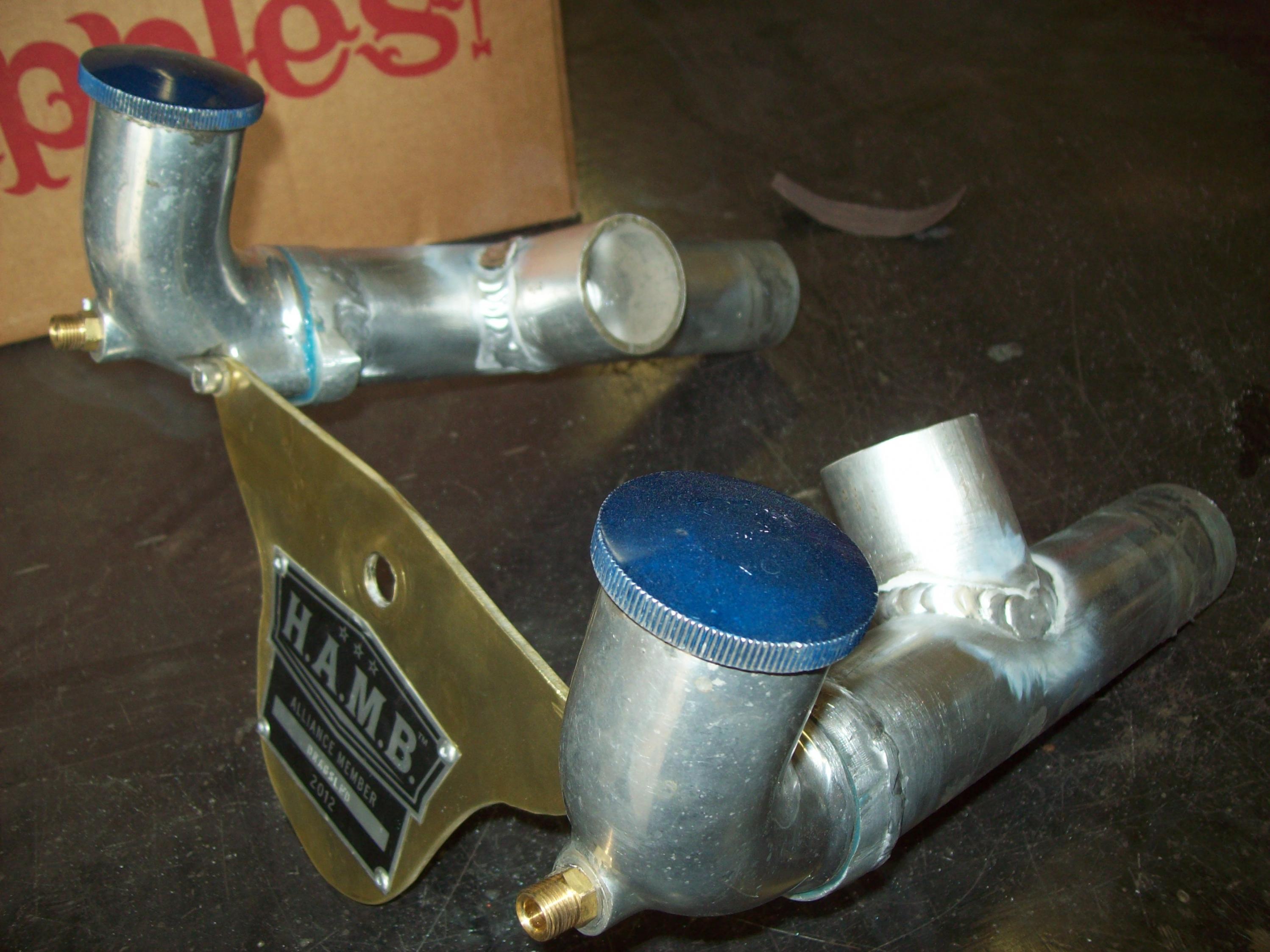

    Nothing real exciting, buildt a overflo tank, out of some rectangler Alum tubeing, had a nice round one made from the cut off extra sec of my fuel tank but blew a couple holes in it tiging up the seam:mad: Still trying to get the hang of this tiging Alum, Steel and stainless not to bad Alum VERY hit and miss , mostly miss:eek:, Man good thing all I have left to mount in the front frame rails is the battery, space is getting very limited up there,,, Tim Jones
  16. roseville carl
    Joined: Dec 29, 2008
    Posts: 5,213
    roseville carl
    Uh Tim please explain the operation of your overflow, looks like you are tied into your fill lines??
    Looks like you need to tie the fill lines together and use a radiator cap with a vent on it, I have an extra alum 1 1/2" ***y if you are interested.........
  17. dragsled
    Joined: May 12, 2011
    Posts: 1,975
    dragsled
    from Panama IA
    Hi Carl , The water fill tubes I used were for a 426 water block, on the hemi's we ran, the overflo tubes ran into the headers, I was remembering I needed a overflo tank now incase of a boilover so I ran the lines to a catch tank, I planned on only runing enough water to fill the block and heads, the small lines are above that point, do you not think this will work as I'm thinking:confused:? I have all winter to redisign it if need be:D, Tim Jones

    Here is what I was talking about Tim if you want it send me a PM with your address
  20. dragsled
    Posts: 1,975
    dragsled
    from Panama IA
    Thanks carl, Before I have you send it out, I'll try mine, Right now I have the fuel lines off the car, replaceing the rubber lines I used to start the motor, putting hard lines on it, short one fitting tho so it might be a couple days before I can try it, Are you thinking the water will boil out too quick with my setup? Tim Jones
  21. dragsled
    Posts: 1,975
    dragsled
    from Panama IA
    Sent you a PM Carl, The more I thought about it the more your idea made sense, Plus I get to do some more fabrcating and more Alum Tig practice:D Thanks Tim Jones

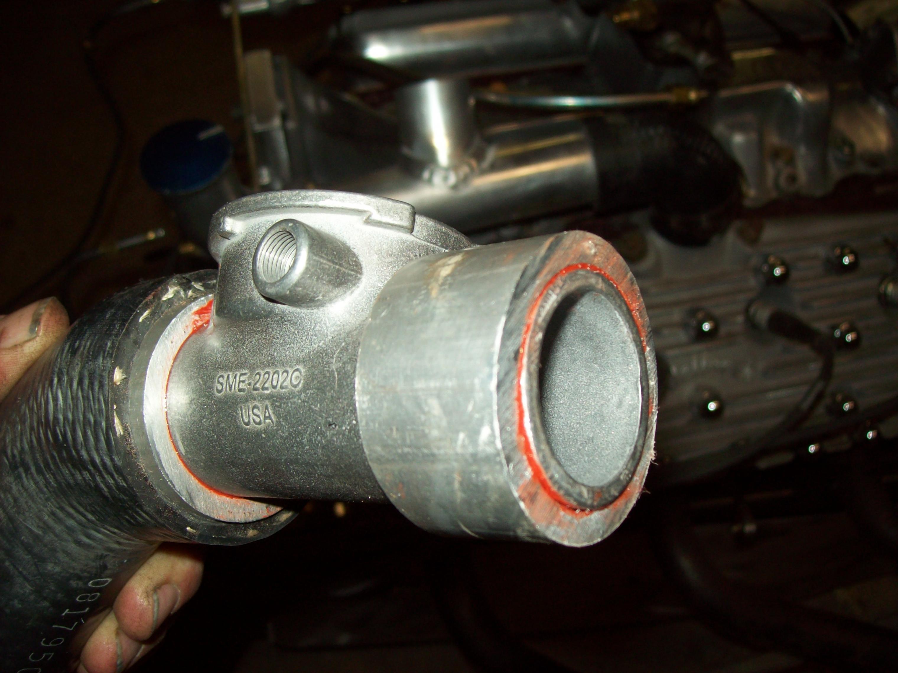

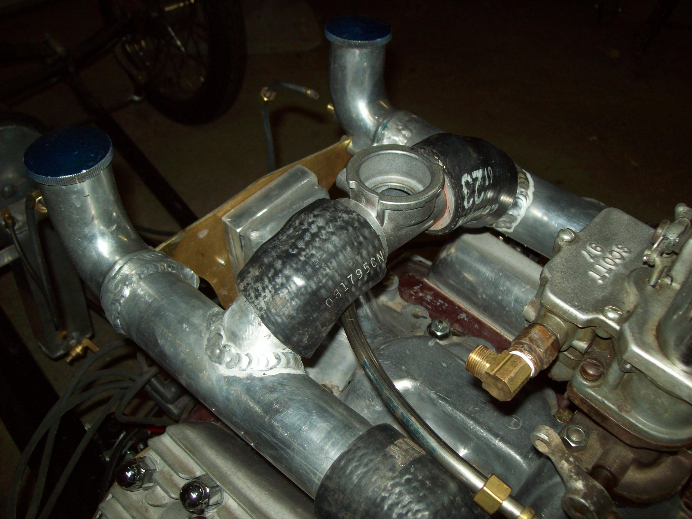

    Got a few things done this week Worked on the water overflo ,adapting the in line fill neck Carl sent out into my setup , Garret Day tiged the new lines to my water lines for me , then I drilled the holes out, and Because the inlets on the neck were smaller than my alum water lines ,I ground the sealing lip off the edge of the neck and pressed on two pieces of my alum tubeing too make up the differance in size, still need to pumb the overflo to the puke tank, came out pretty well, Tim Jones

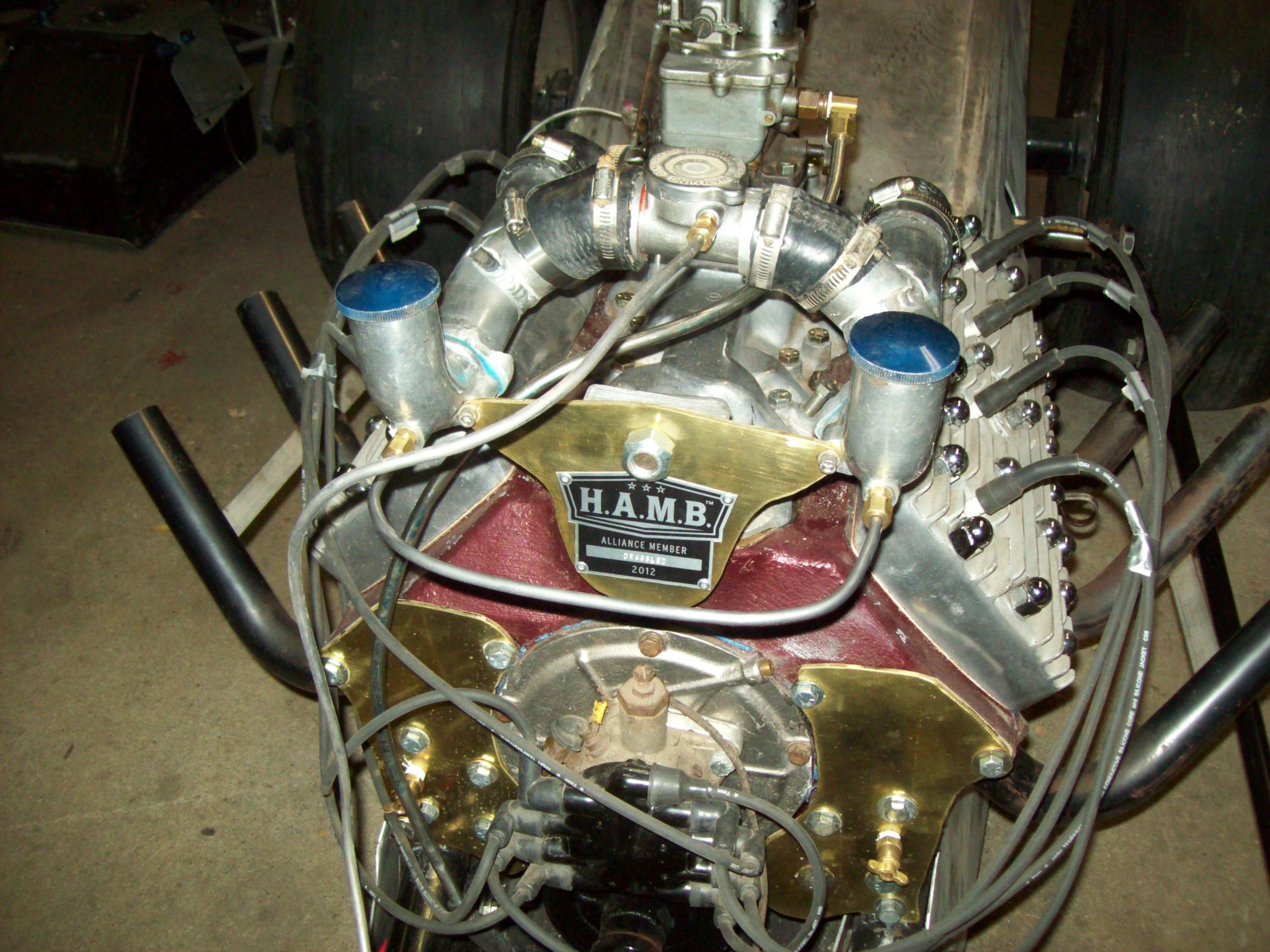

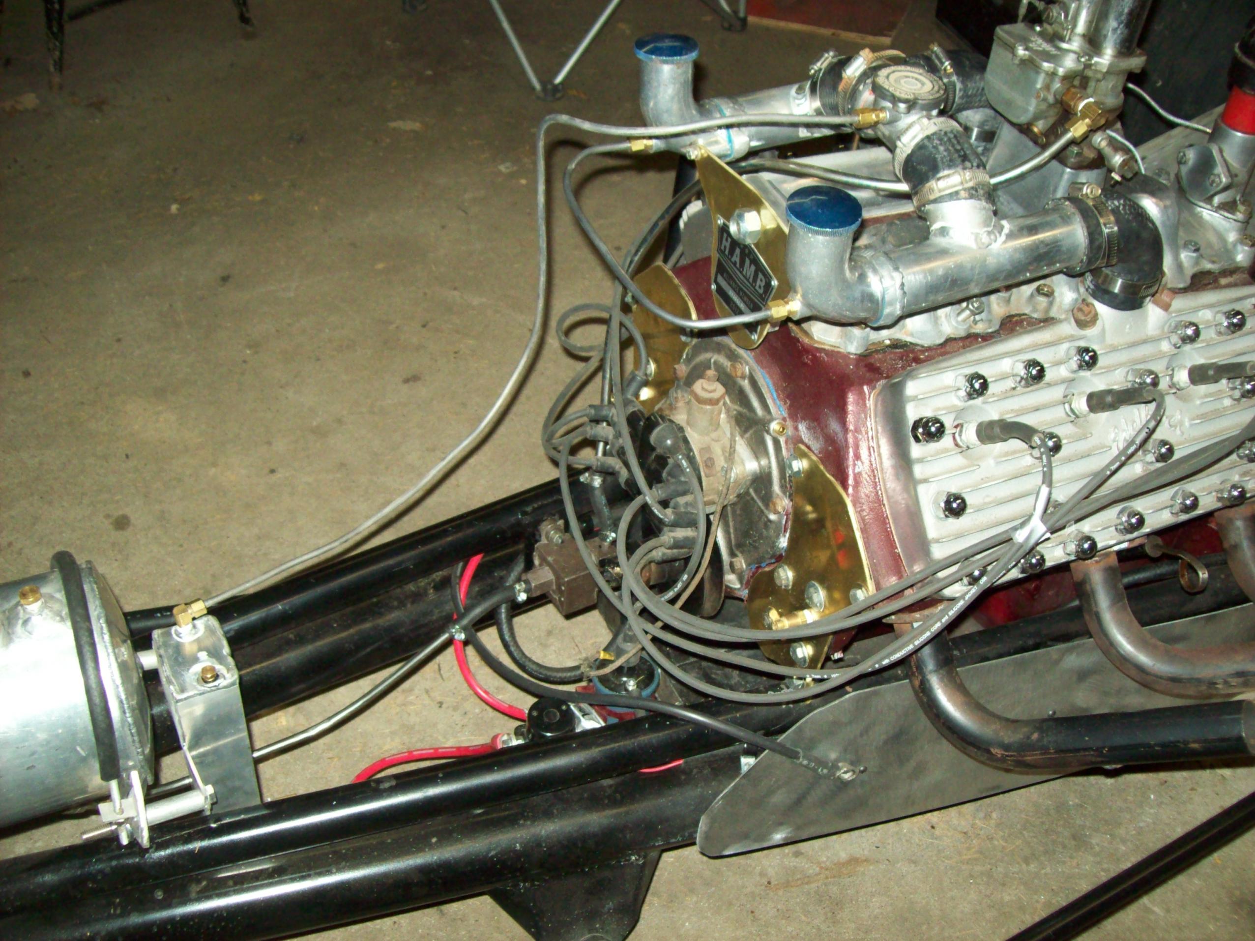

    also this week got the wiring all ****oned up and secured, My friend Henry started makeing my crank hub for the other motor, Kept the shop nice and warm with the woodburner , Tim Jones

    Got the overflo lines all plumbed in, I'll fill it with water over my weekend and try it out,, Tim Jones
