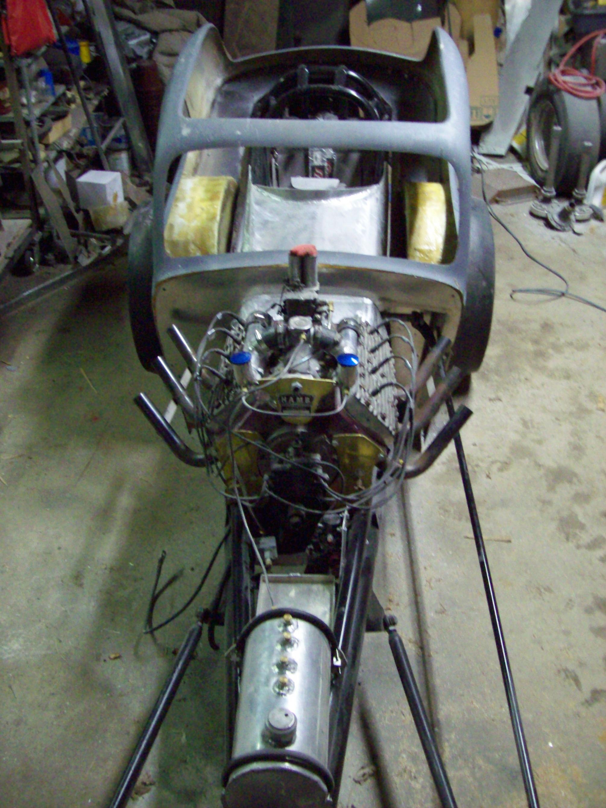

    Had some good weather lately, So got out in the shop early today and got the front tinwork ****oned up, While the peanut gallery cheered me on:D,,,,, Tim Jones

    the Next project of the day was adding another brace to the inside wheelwells, Because I used the cut outs from the side of the body they followed the shape or conture of the body, this made them arch out towards the tires, So I added a brace to the rail of the tinwork that runs along the weelwells to pull them in shape, Used a clamp and a block of wood to sweeze it all together , also heated the fibergl*** while sweezeing it so I wouldn't break or crack the fibergl***, Then ran a bunch of bolts along it to hold it all in place,,,,,, Tim Jones

    Well I still don't have any money to buy the new third member and other parts for the dragster,So I'm back to makin stuff for it again, I was looking at the fibergl*** wheelwell humps and decided to make some alum ones to match up with the tinwork ,me and my buddy Huck got them rolled and tacked together today, unfortunely the welder gods weren't on my side today, couldn't get a good bead going for the life of me today, so I figuered I go home check the fit and try tomorrow ,Still very hit and miss on my alum tig welding, Here's what I have so far, BTW the the pieces of wood on the car are because the body is loose from the hinges right now,,,,, Tim Jones

    Busy day today, 3 pups got new homes , Plus they took a wrong turn and got about a half mile down a dirt ( mud this time of year) Road and got stuck to the floorboards , Took the trusty ole Dragster hauler down and pulled them back to the gravel road, Wasn't sure If I could get down it let alone pull them out, that thing is a powerhouse!!:D But back to the dragster, got the gl*** tubs cut out and got the alum ones fitted,, just have to weld them to the rest of the tin work, Needed to gl*** in some mounting tabs to hold them to the body , so I waxed up the alum tubs and gl***ed right on the top of them, after the gl*** cured popped them loose , and had the perfect fit, Here's some pics Tim Jones

    Well got the tinwork mounted back in the car, put all the body panels back on the dragster and spent yesterday and this AM t******* and tweaking the tin to slide over the dragster body, good thing I have a winch in the ceiling ,raised the body up and down dozens of times, rolled her outside for some pics, Tim Jones
