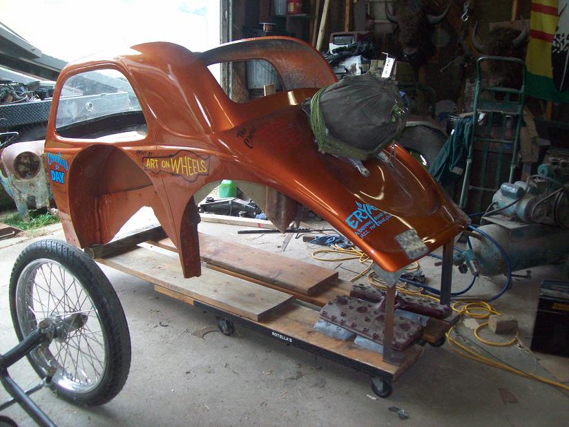

    Since I'm going to pull the motor and repair the block I decided to take strip the car to do a couple other things I've been wanting to do this winter, add some side bars by my legs, and that means changeing the steering alittle to remove the trans,plus I sure I'll come up with more to keep me busy this winter:D, Here's some pics of taking the body off, Always good to have some old flathead heads around for counter balance, looks like the pup claimed the body and stand as her new dog house:rolleyes:,,,, Tim Jones

    Tim, it's abit strange, as you think everything is done, NOOO. then it's something that needs to be moved or altered;):)!?
    What are you gone do with the Flathead?
    K
    Taildragger&fenderless
