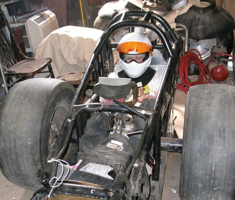

    Thanks for the info Carl,,, Being the chances of my daugther Brandy getting in the seat of this thing, ( Plus I like my feet also) I'm adding some extra tubeing in the leg area, Here's some pics of the tubeing placement, Any Ch***is guys , want to offer their thoughts,,Lines are not to scale just looking at placement,, also I never liked the feel of the steering u joints so I'm going to mount the box on a swing out bar, to get it out of the way when removeing the trans,, Plus a pic of the muts laying on their Bark-o-lounger in the dog yard,,,, Tim Jones

    Tim do you have a copy of the NHRA rule book? good pics of what ya should have in there...........

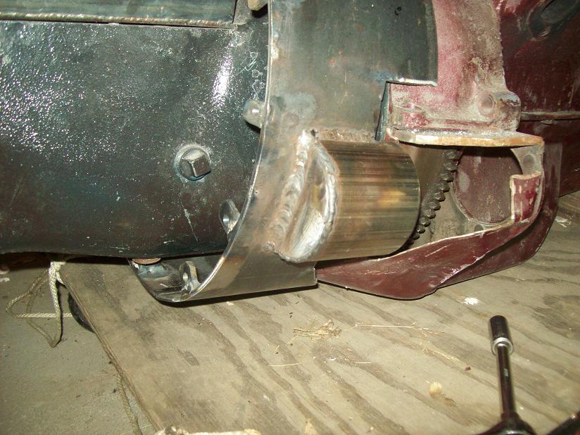

    Just old rule books, but I do have a set SFI specs for a funny car ,I'll just have to find it, , We started building a bellhousing yesterday, rolled a 6 inch wide piece of plate steel for the main part, our roller at work is a hand crank one :( kicked my old ***, but it came out nice, we,ll weld up the inside seam today, then I'll bring a block and trans into work to finsh the mounting pieces and back section, won't be nhra legal but safer than nothing:D I took pics on someone else's camara, so it will be a couple days before I can post those, I'll shoot a couple of the finshed main ring today,,,,, Tim Jones

    I would think about putting an "X" in the trans bay as it would put the welds in the corners. If you did it like the pic shown it put a large welded area in the center on a straight tube and some distortion and pull could upset driveline alignment

    Thanks for the input Bruce, this what you had in mind?,, Tim Jones

    Here's some pics of the bellhousing start, and Our hand roller,,, the x brace in the can was to keep it all straight while welding the seam, plus my drawing of what I had in mind,, Probally will change a bunch before it's done:confused:,, Everything I do is a work in progress,,,, Tim Jones

    Yes, By welding into the corners the tendency to pull at the weld is minimal and you wont lose alignment.

    Thanks , looks like it will add alittle more protection also, I want this car to have the look of an old style car on the outside , But be as safe as I can make it with todays knowledge,, Tim Jones

    Did a quick test fit of the bellhousing, still have to do some cutting to get the fit on the engine side,Plus I'll cut the rear cover plate tomorrow,,,, Tim Jones

    kjell and buddy, The type block I have makes it alittle harder to do the ****tershield , but anything is better than nothing:eek:, got busy at work today so only had time to do some cut outs fitting the shield to the block, Dam job is always interfering with race car work:D, this week I,ll make the bubbles for where we did the cut outs on the ****tershield, after that we'll do the mounting tabs inside the can, plus the rear cover,, Tim Jones

    Got alot done on the ****tershield ,last weekend we worked on the rear cover ,My friend Beth (lizbeth) on the Hamb, has been helping me do alot of work lately ( she wants to kick me out of the seat of this thing ) between her and my daugther Brandy I don't have a chance:(,, , We got all the mounting tabs drilled and tapped or the rear cover, doesn't fit too bad over the trans, all that's left is to cover the places we cut out for clearance and starter pocket, the trans mounting tabs inside the can, plus lenghten the shaft that the clutch pedal is on,,,, Tim Jones

    Got somemore down over the last couple days, Got the inside mounting tabs done, the cover plate for the clutchshaft done,,, made a sleeve to extend the throwout shaft and the starter pocket, now just have check the fit on the motor and pan I use on the race motor at home,, here's some more pics,,now I just have to clean up some places I cut out for clearance:D,, I won't beable to use the motor plate because of the ****tershield,, so we'll have to make some different rear motor mounts:) ,,,,Tim Jones

    We got alittle more done on the can, Made a couple plates to cover what was cut out for clearance on the side,starter pocket and cleaned up some edges,,Looks like Beth is gonna have to do alot of this by herself after the T-Rex got done with me:eek::D:D Tim Jones
