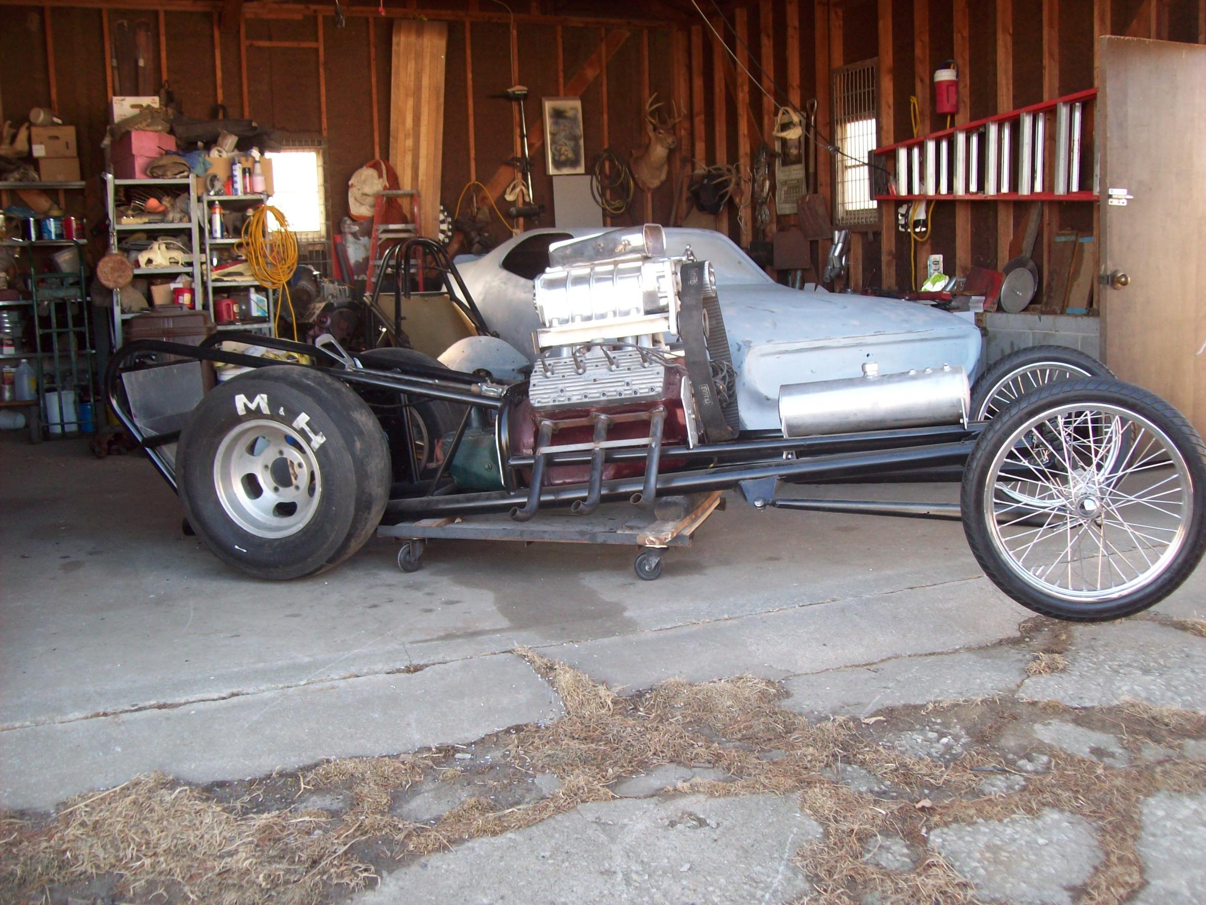

    Well,, Iowa winter boredom set in ,decided to start building a blower manifold for the flathead, Yeah I know I can go buy one ,But with limited funds and the mindset of, If I think I can build it, I'll at least try,Plus with the money I save doing it myself I can pick up a 3 71 or a 4 71 blower, So I started with a 1/2 inch thick Alum plate for the base, marked out a pattern with a intake gasket and started drilling and grinding the port holes , and grinding and grinding and still more grinding

    Great work Tim:)
    Your dragster is coming along nicely:)
    As for the intake, that's what we are going to do for the next step, mayby next boring winter:D!
    You might consider not to grind so much material off on the outside towards the heads, as
    you might end up enlargeing the ports, maby "D" ports?
    We ended up welding on material to be able to move the ports outward.
    Br
    Kjell
    Taildragger&fenderless

    Thanks for the heads up Kjell ,I haven't cut the corners or the sides down yet, welded the runners last week, but haven't loaded new pics yet, tried different angles before finding ones that didn't overlap eachother , working on tubes for the bolt holes that run next to the intake runners yesterday and today Thanks Tim Jones

    Sorry for the lack of pics Carl had to get to work this AM, Here's pics of cutting the runners, 25 degrees seemed to work best ,Welded the runners on , Our welders at work are trying to teach me how to Tig alum, so you'll have to over look my welds,Man they got their work cutout for them, after welding the runners I drilled 3/4 inch holes from the bottom of the manifold, so i could install tubes for the manifold bolts that the port runners overlaped ,I'm inventing as i go on this deal, layed the heads on the motor to see what I had for clearance Fenderless My intake bolts will be under the Plenum instead of through the Plenum under the blower, atleast that my plan right now , Could change though ,My design has changed a few times just getting to this point Thanks Tim Jones

    Hi Carl thanks for the coment on the welds , I'll get better with practice The Plenum is my next step ,I figured I better have a burst panel if i'm gonna race it ,got one on the way from Good Vibrations they sell one you can weld on to what you have

    Well back to the flattie dragster, Yeah!:D My burst panel parts came today plus the blower base gasket, now i can get some stuff done, got all my marks on where I need to put holes in the plate and Plenum , looks like I'll be doing some triming on the blower base plate as well ,I decided that when I trim the sides of the blower base plate I'll leave enough room to use a 6-71 just incase someday I want to build a killer flathead, Hey a guy has to dream Right?:rolleyes: Hey Carl your not kidding Garrett has some talent, Best of all he's not even a car guy ,so when I come up with some hair brain idea I never hear Oh I don't think that will work:mad:, he just says Cool man, I'm in Thanks Tim Jones

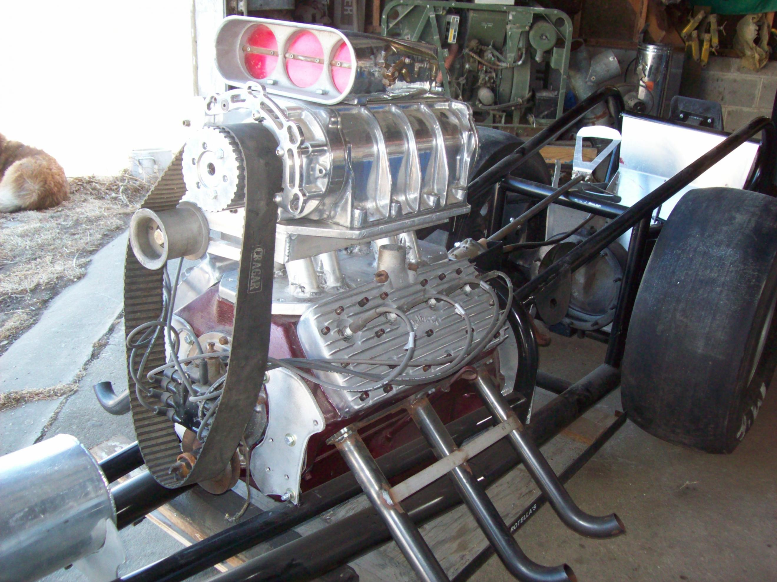

    Well got a few minutes today to use the plasma cutter, tapped my bolt holes tonite , gonna try to finsh some grinding and weld the base plate for the blower on tomorrow , might have to stay late to get it done , Now if I had a 4-71 I'd be set, got to admit the 6-71 looks pretty nice on there, Also picked up a sweet chrome push bar
  28. roseville carl
    Joined: Dec 29, 2008
    Posts: 5,213
    roseville carl
    Yea that 671 does look good on there, might be worth considering..........

    Burst panel pic, Leaning towards the 6-71 also Carl
  30. dragsled
    Joined: May 12, 2011
    Posts: 1,975
    dragsled
    from Panama IA
