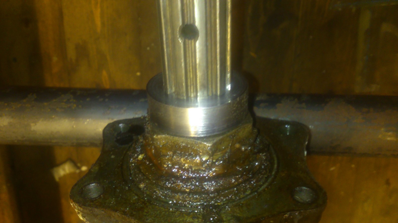

  27. TheTumbleweeds
    Joined: Jul 29, 2010
    Posts: 539
    TheTumbleweeds
    from Sweden
    DSC_2540.jpg DSC_2545.jpg DSC_2546.jpg Lucky it was a easy solved problem for you with the coupler. I got a advice to build a collar, to prevent same kind of issue you had. So it can't travel on splines :)
  28. dreracecar
    Joined: Aug 27, 2009
    Posts: 3,476
    dreracecar
    from so-cal
    Shaft collars will only work if either the shaft is part of the trans output or seperate from both output and male coupler. the only way to make your arraingment work is to put a back stop/shim inside the female coupler to limit reward travel, either a wood or alu donut
