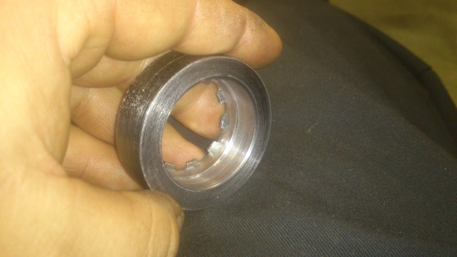

    No not a dumb question at all, I have a splined shaft comming off the rear, and the same spline shaft comming out of the trans, They are joined together by a coupleing device that slides over the two shafts, the coupler slid forward onto the trans shaft, releaseing the rear shaft causeing no drive to the rearend ,I'm going to use two shaft lock rings on each side of the coupler to hold it in place, and use a shim to hold all in place as Bruce subjested, Hopes this made sense

    , Will Do! I'll get some flat strap iron and get it all welded up this week, Thanks for the coupler info

    Thanks Tim, that makes sense, I thought it was the shaft that was moving and couldn't figure out how that would happen. Thanks for schooling me on that. Good to hear it was not a bigger deal and there was no damage.

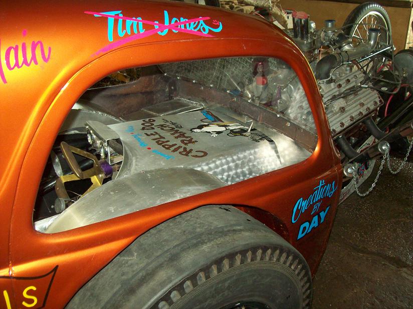

    Well Dragster driveing 101 got rained out today, but I got a few things done anyway, Got the headers st****d together , So Beth won't have the attack of the killer zoomies to deal with:D, Added a saddled bearing to help stabilize the steering, supposed to be dry tomorrow, so we'll see how it goes 102_0513.jpg 102_0510.jpg 102_0530.jpg 102_0531.jpg 102_0512.jpg

    The cars ready to roll tomorrow, Forgot to show pics of the coupler fix, two clamps on each side , alum spacer between the shafts to hold all in place, still used the allen set screws also, 102_0543.jpg 102_0540.jpg 102_0541.jpg

    Nice job Tim, could you post a pic of the graphics on the nose please?

    Thanks also, I'll post the art work and the nose and cowl , Were going to add a D to the end of the cripple in the name on the pieces

    Dang Tim, it looks great and I like the graphics on the nose. Get well and you guys go out and have some fun!
