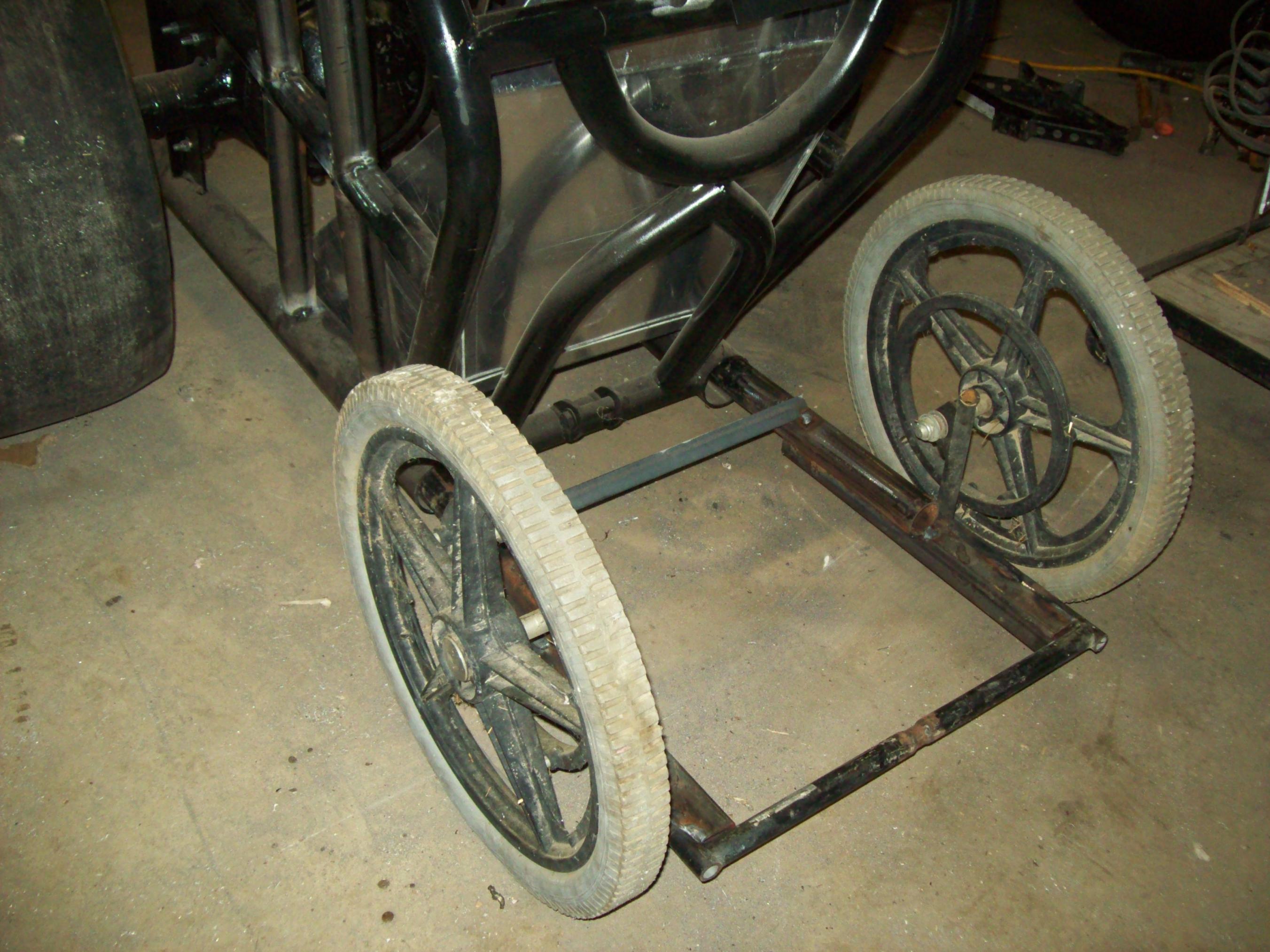

    from Panama IA

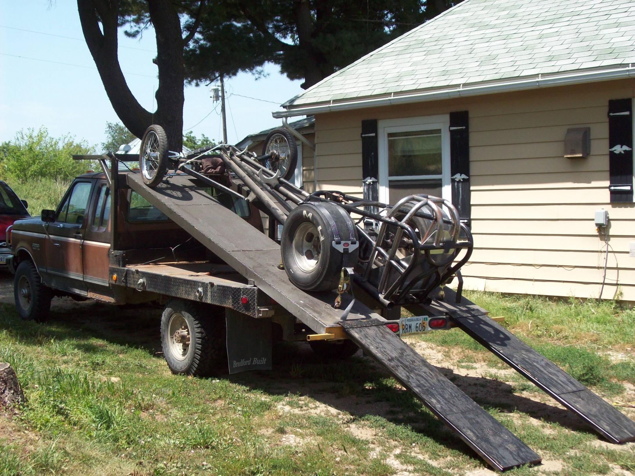

    Because i didn't want to build 8 foot long ramps, I buildt a set of wheels that fit in the lower frame rails to keep the frame from dragging on the ground while loading the car, looks kinda crazy but it works good, when installed the rear tires are about 2 inchs off the ground ,Hmm? might work good for warming up the car before runs, I think the new and improved set will be a little closer in
  15. dragsled
    Joined: May 12, 2011
    Posts: 1,975
    dragsled
    from Panama IA
    Car loaded and ready to get the new pieces tiged up this weekend
  16. Calkins
    Joined: Jun 20, 2009
    Posts: 362
    Calkins
    This car and ramp truck make me smile! :)

  18. roseville carl
    Joined: Dec 29, 2008
    Posts: 5,213
    roseville carl
    Humm Tim now ifn u can find a F1 body to replace the truck????????

    from Panama IA
    I'm already keeping an eye out for one for it:D Tim Jones Thanks Robert and Justin

    from Norway
    Cool idea Tim:) What about taking it one step futher, and also make into a starter trolly, then you need one less person when towing to the starting lane:)?

    from Panama IA
    Don't give me any ideas Kjell , I have a hard enough time staying focused on one thing:D Had to do alittle creative thinking with my tie down straps , they were a little long for hook mount placement,Added some wood spacers, works fine now, got the car to the shop to start welding the new pieces, Garret couldn't make it , so I welded in a few brackets and some of the lower uprights, I'll leave the cage for Garret , that way I know it's right . Tim Jones

    from Long beach
    Looks pretty cool Tim. I really likes the car carrier. I just might have to put a flatbed on the '62. :)
