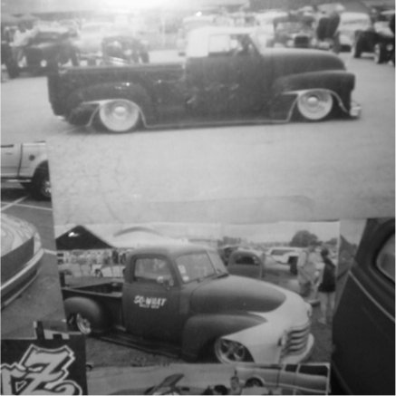

    Here ya go clark,,,,,, hanging on my wall for a looong time..

    I used a long wheelbase frame and removed 7 inches from the frame at the factory lap. You could use a short wheelbase frame and remove some of the front of the bed. I used a S10 Blazer gas tank and a Blazer rear end. My truck, (WZ JUNK) has a shorter bed because I wanted it that way. I am interested in how the So What trucks are lowered. I channel the truck I am working on as much as it was easy to do.

    My truck is the one with the white front end. The bumper on that thing touches the ground with the airbags emptied. The deal is, my cab is mounted 5 inches above the frame rails. This was done so I didn't have to put a ****** tunnel in the floor. My interior was done so I didn't want to screw it up. Any of us would be more than happy to answer any questions about the conversion. Maybe Clark and I can get some real pics and measurments on the Techomatic board.

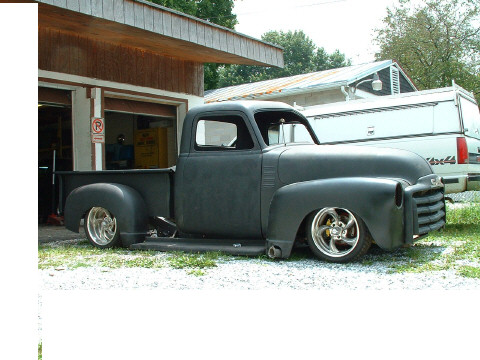

    Is this it? Onelow48's truck-I'm pretty sure on a blazer frame.
  14. Onelow48's truck is on an S-10 longbed frame. The only reason we mount the body's a couple inches off the frame is to keep from having a big ****** hump.

    Not a Blazer frame. Long bed s-10. Looks much better with
    a bumper A?
  16. the headlights help too [​IMG]

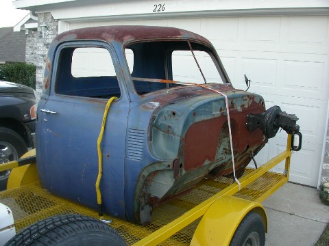

    The pictures on here got me fired up about mine again. I'd bought the S10 frame several years ago, just never really followed through with it.
    Today, I brought the cab home and got to work. I didn't get too much done to it, just hung the brake pedal and master cylinder and column.
    More work tomorrow

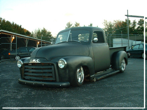

    Here is the pic that moved me to build mine.

    yeah it looks alot better with a front bumper..
    the best deal with onelows truck is that the cab was one of the so what "set up pieces".
