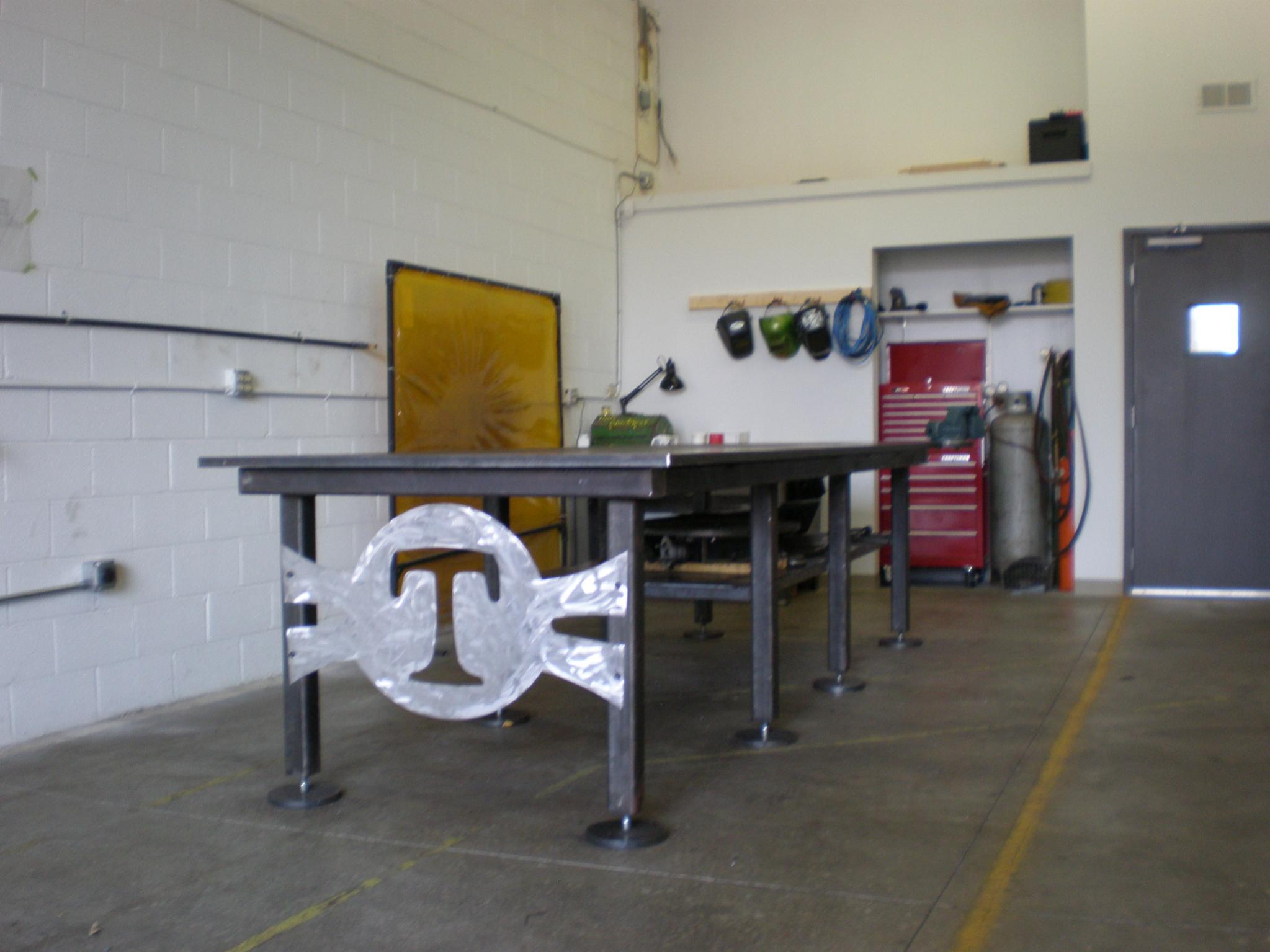

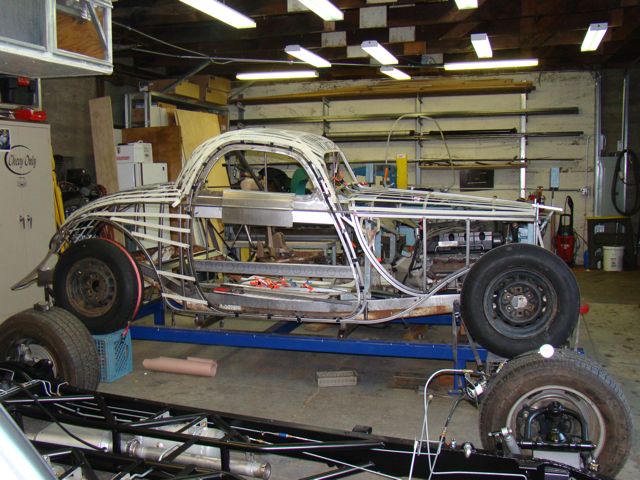

    Here is my table. Very strong all 4 x 4 box tube with adjustable feet.

  8. Here's mine, also 4 x 4 tubing with adj. legs.

    Thanks for the kind words 5756r! Like you said wood will move. My advice is to spend the extra money and build a steel table. I don't have that much money in mine. Maybe $300 to $400 and a day or two. In the long run it will pay for itself. On a steel table once you jig something up its going to stay in place! You can get pretty aggressive with things and know that your not going to bump or tweek something out of place. Plus once you get your ride height set, tire heights and all the cross members set its kinda like connecting the dots. It makes it so easy. Takes all the guess work out of it.

    Yep exact same tables we used at Troy's. The only thing I did different with mine is make it so the legs unbolt and the table drops down to 12" tall. With the bottom legs on the table its 3 foot tall. Like at Troy's the bottom legs also have trailer hubs on the rear of it and a center pivot in the front so I can bolt tires on it and the entire table acts as a wagon. Makes it really nice for moving and also loading on a trailer if the need be. The table itself is 72 inches wide and 15 foot long. Troy's were all 18 foot long. It was always pretty crazy taking an entire car off a 3 foot tall table at Troy's so I made my table so that it can be brought down to just a foot and its easy to get a fully ***embled car on and off.

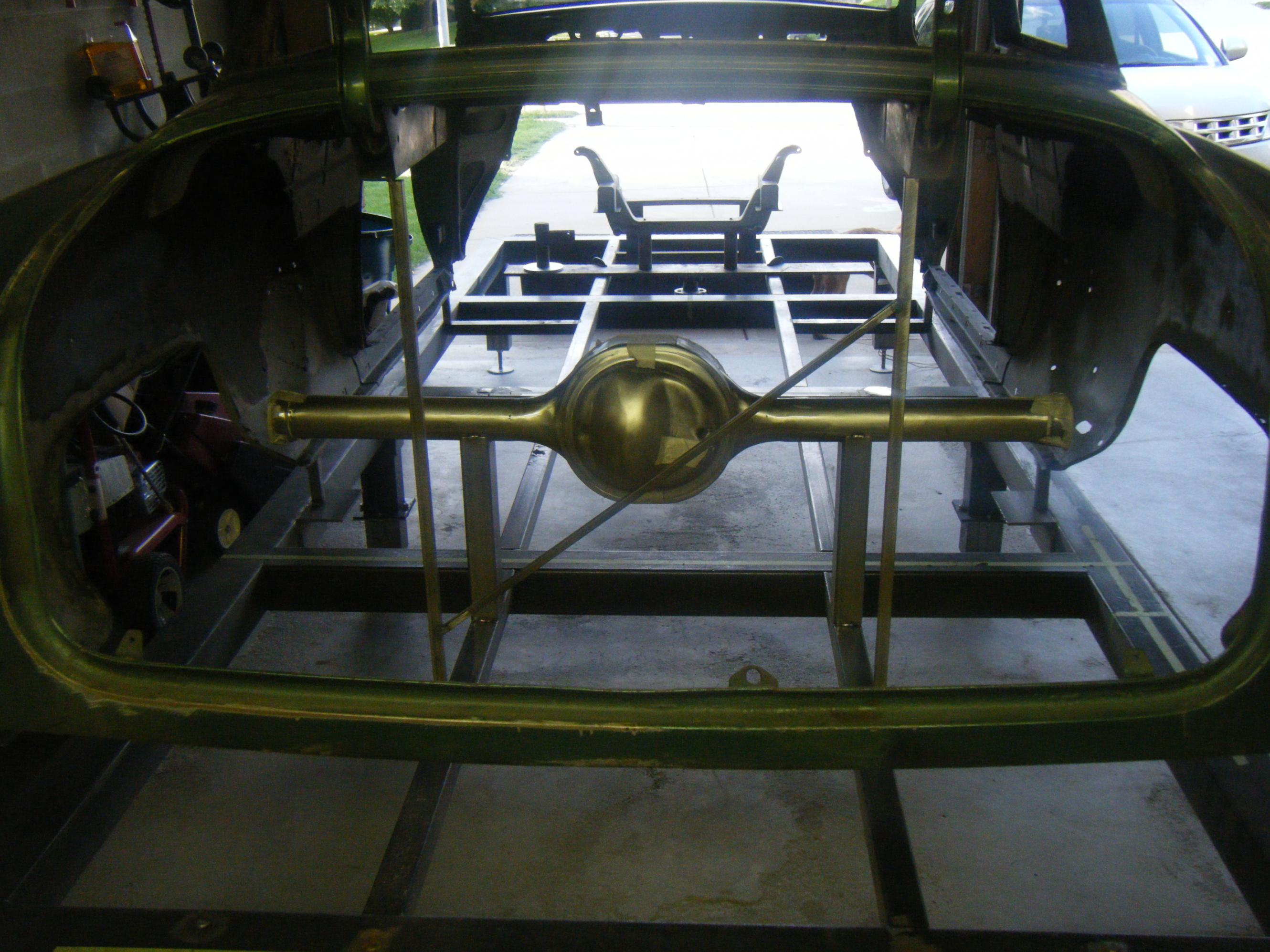

  18. mikeyfrombc
    Joined: Jan 17, 2009
    Posts: 92
    mikeyfrombc
    [​IMG][​IMG]
    here,s a couple of the set-up i built when i was doing the 25.4 backhalf on my 75 vega , plans are to skin the top with 3/8" plate down the road

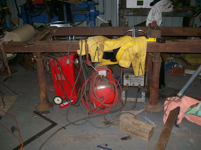

  20. I built mine from lightweight 8" wide flange sections salvaged from a rooftop AC unit. Sized to minimize cutting and maximize length (8'-9" x 34" x 40" tall). Surplus castors and 3/4" leveling bolts. Total cost, $80 and beer.

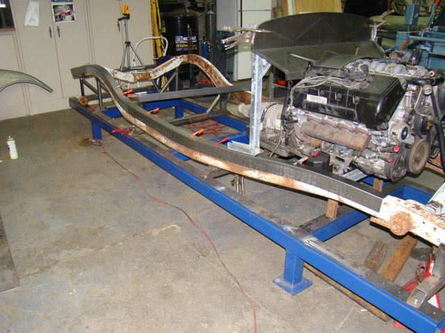

    Here's mine. The main bed is welded together with removeable legs. The cross bars with vertical supports are made to fit a 33-4 frame, ut are removable. Future plans are to make set of supports up to do Model A's, 32's and 35-40's. I used a straight original frame, a professionally boxed frame, and Wescott measurments to determine what to fab the standoffs to.

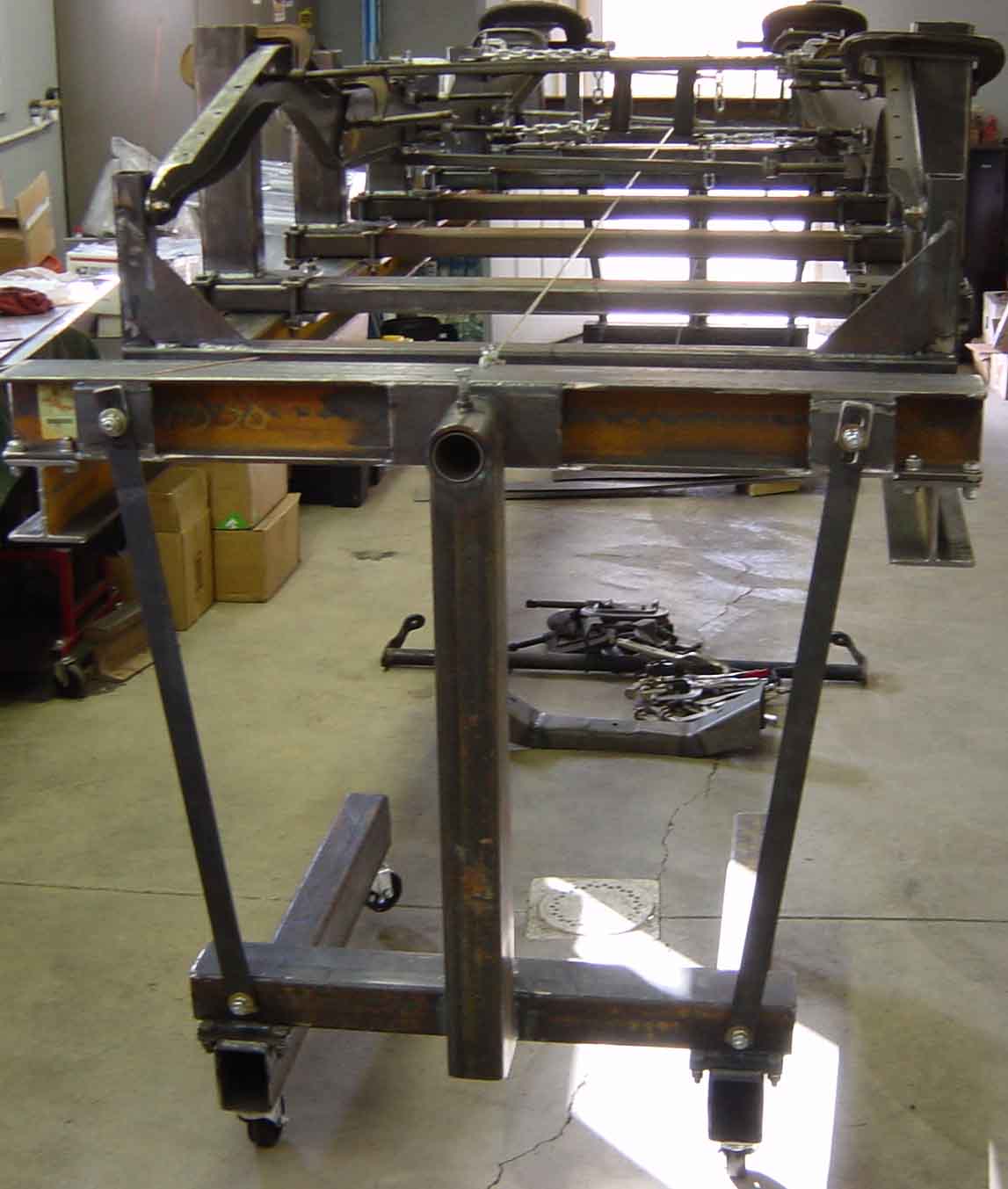

  27. I made mine as my first welding project with a new TIG welder - was a great experience. I probably spent about $1500 on steel - as steel was REALLY high at the time. Decided to make the ends like engine stands - so I can rotate the entire ch***is to weld at any angle. This was a REALLY great idea in that there are so many places you need to weld if you're starting from scratch - like I did on my 34 frame. I made the ends exactly the same as engine stands, so I can use them for that purpose later on.
    Also, I made all the cross tubes with sliding mounts to pickup the frame rails - that way it can be adjusted to ANY frame. I know I'll be doing a 40 Merc, a 32, etc -- might as well make things adjustable.
    Here are some pictures - hope it helps somebody!
