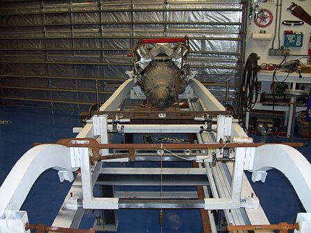

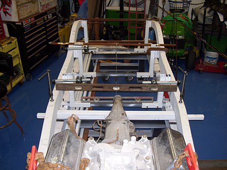

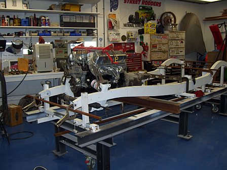

    I used I beam on mine and made all the fixtures adjustable. Has 4 casters for mobility and 6 legs have leveling jacks so as get it dead on.

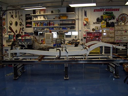

    with the crunch of the economy a "celette" bench might be a good alternative.
    Here is my table:
    the aluminum blocks pictured below are cut down the center of the hole so they clamp onto the tubing and hold it secure.

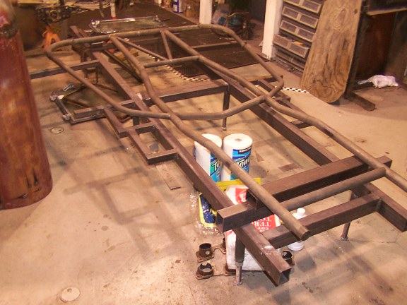

    I keep them as basic as possible. I don't think of them as a 'jig' because a jig is used for repe***ive work - there are jigs in this thread - they are 'work fixtures'. So the basic structure has to be simple, strong, square, true, level. Not wide, i think mine is 30"ish, so you can get inside it. All steel i have worked with (except for milspec) is imprecise, clamp a 1 X 3 to the side of a level 2 X 3 and i guarantee the 1 X 3 won't be plumb. For that reason i don't bolt anything to the work fixture, i figure what i need and where then tack weld arms, legs, whatever i need. When i am done with that facet of the project i knock them off.
    I have been doing this stuff for 20 years and have all kinds of different tables with milled and machined slots, fixtures, clamps built into the table and all manner of devices for adjustability and came to the conclusion that if one size fits all then it don't really fit nothin. If it is important enough for me to build a frame then i can take the time to build a work fixture for just that frame.
    I have seen a couple tables here i'd like to have, they all have a thick surface plate and lots of drilled holes for clamping.
    The pic of mine is from a while ago. The frame is the start of a chrome-moly tube ch***is (round-tube part), the work fixture is the rectangular tube.

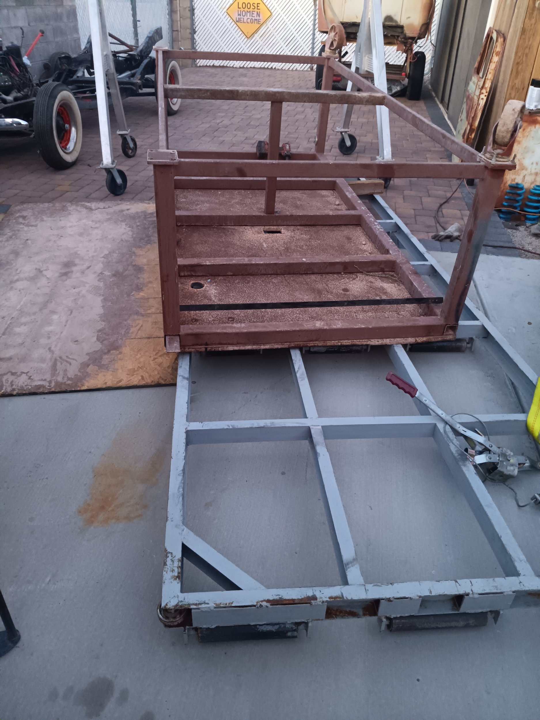

    I know its an old thread.

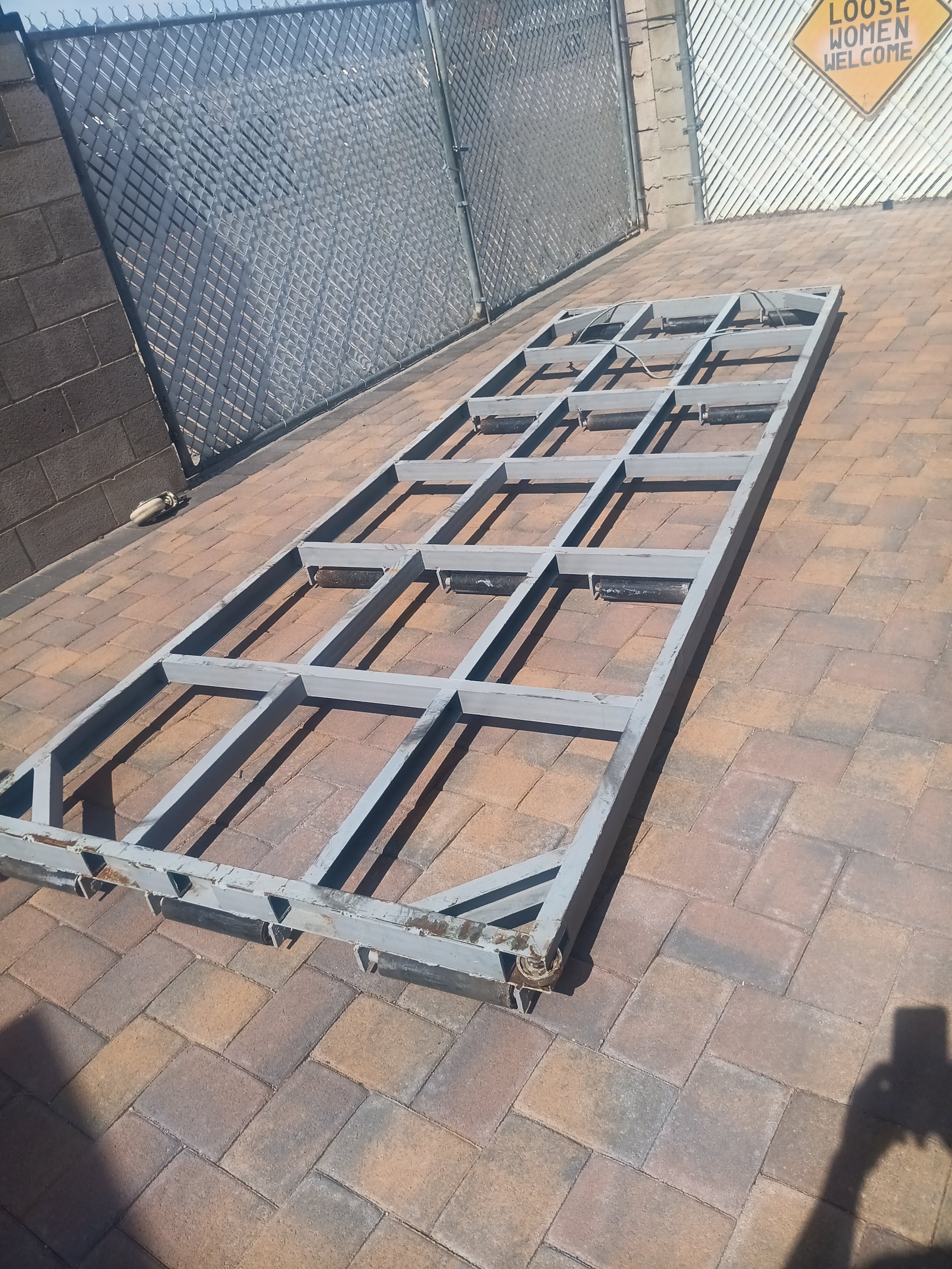

    Just picked a fixtured advertised as frame table..
    5'x13',3"x1.5'' channel..it's abit twisty..
    Cheap enough to buy some 4"x4" steel to make it stronger.

    Could work.....I can't tell how heavy duty it is. Might be easier to start from scratch?
  20. patsurf
    Joined: Jan 18, 2018
    Posts: 2,652
    patsurf
    can you scrounge or afford 2 4x8 shts of 3/16 or 1/4 to skin it with-would sure be enough to stiffen it,not enough maybe to clamp to

    I have 20' of 2x2 3/16
    10' of 5x2 1/8" and other channel..could maybe build a truss system underneath and bolt it to the floor..
    And yes...shoulda bought new steel

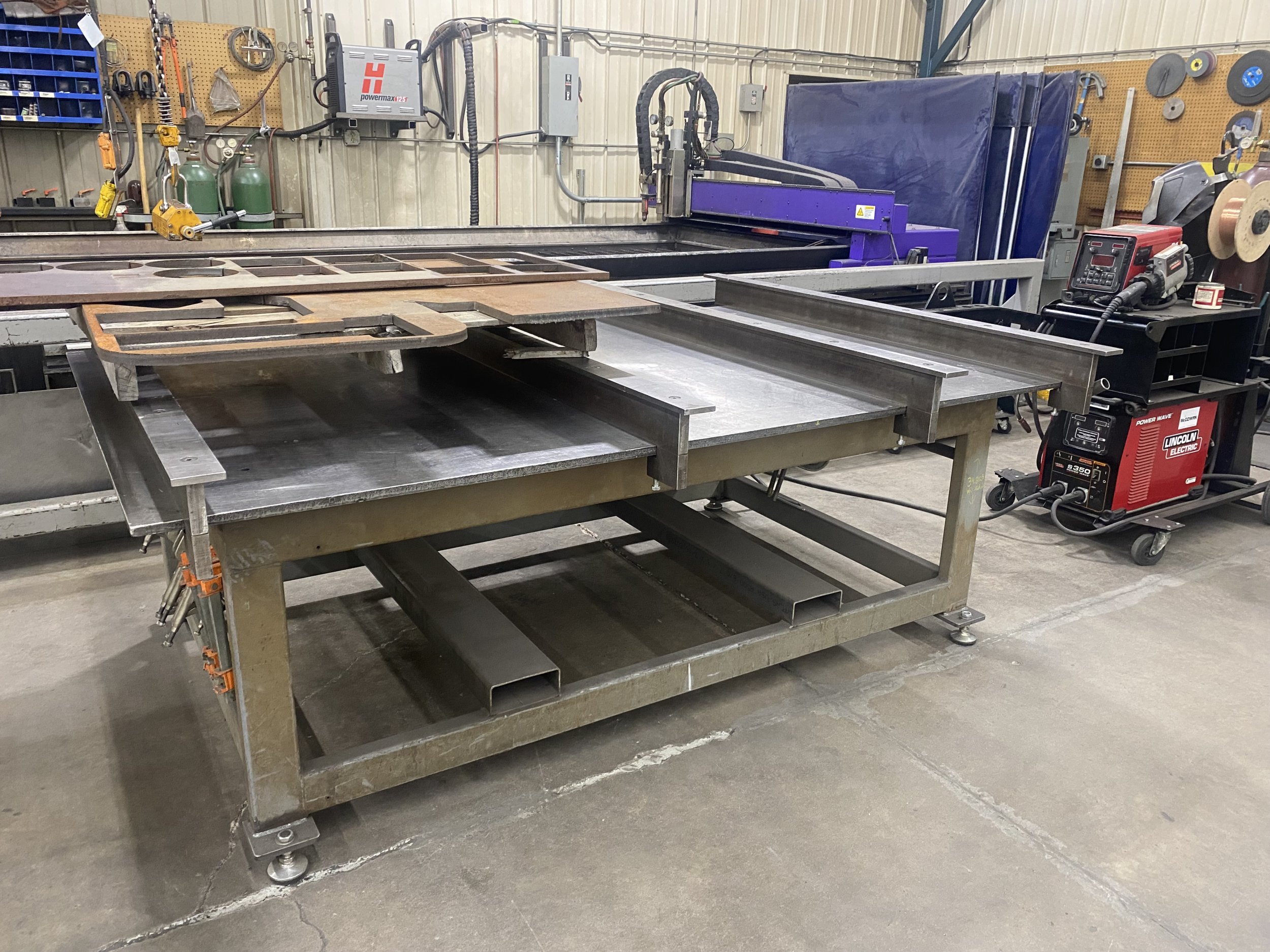

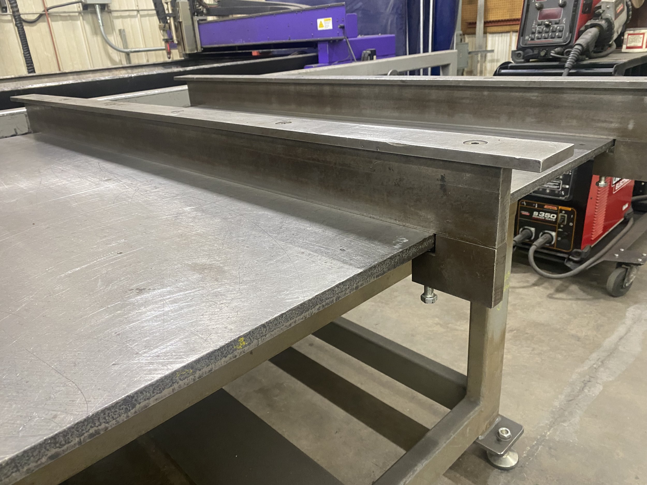

    Our shop welding table. If I was doing a bunch of frames I would make one a bit bigger.
    Top was blanchard ground flat. Risers are movable and work well for all we do. They were blanchard ground flat as well.
    And yes bounce around welding. We added the forklift tubes after a few years and just putting them on warped the top about a 1/16". Had to have it re-blanchard ground.
    Big one is our other table.

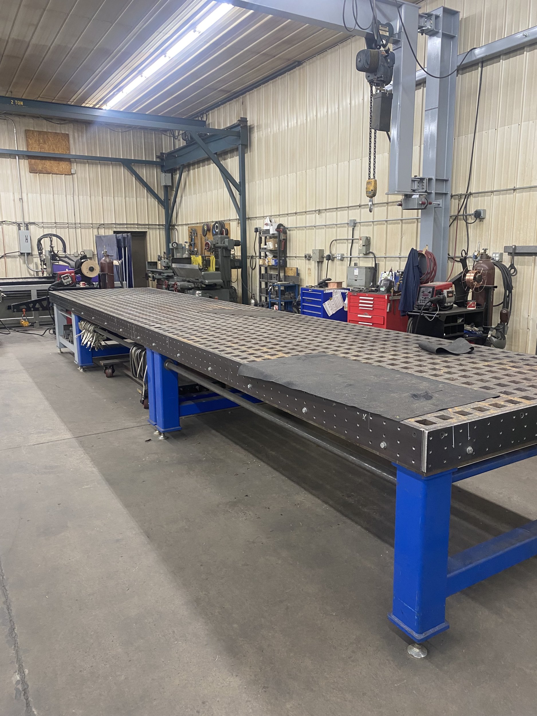

    We built the legs, but the tops are 5' x 10' platten tables. Bout 1200# a piece.
