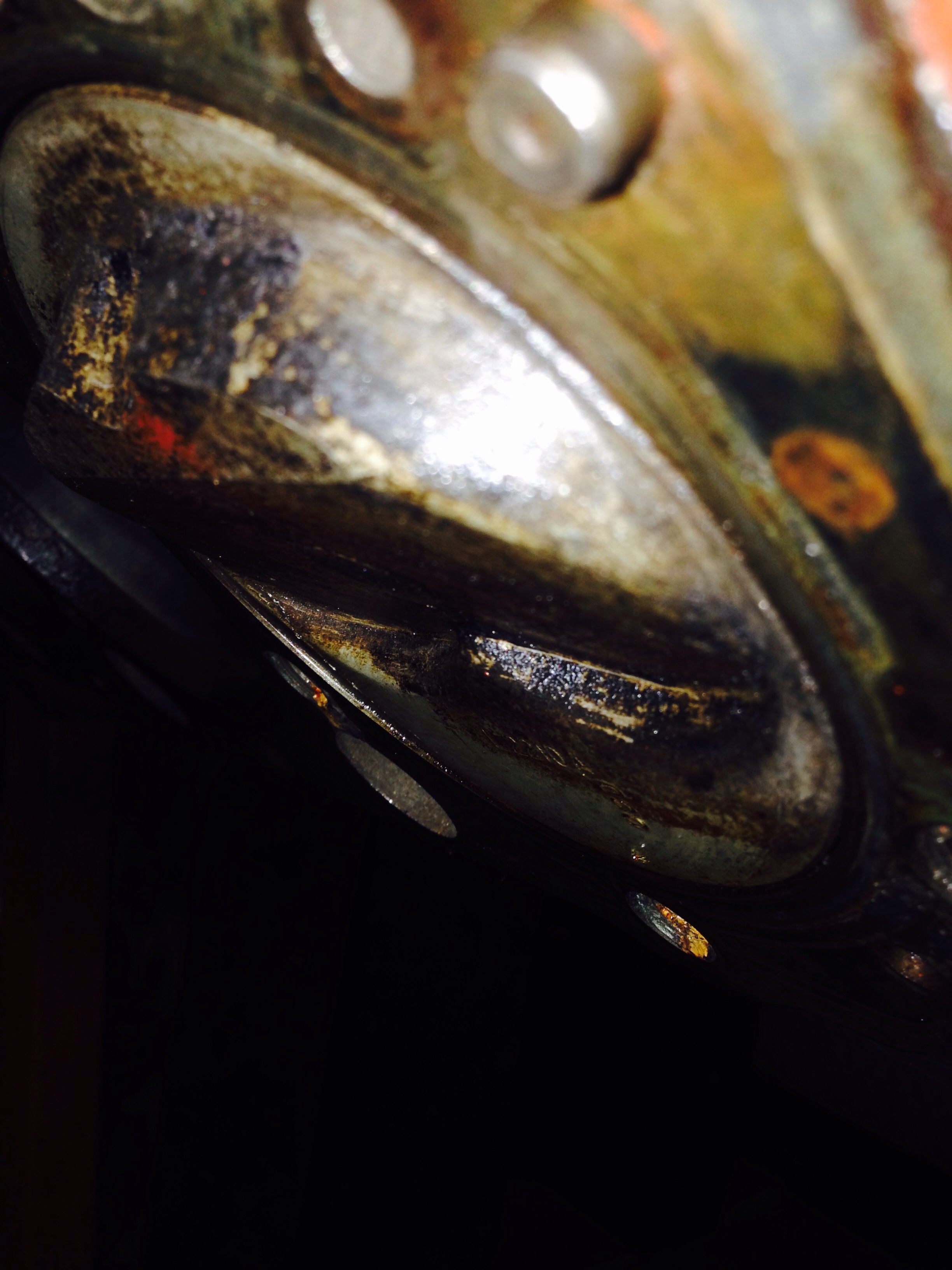

    image.jpg Pie shaped flange "1178" casting distinctive to large main 302 cranks. Pie shape present for small or large mains 302's / 283 perfectly round.

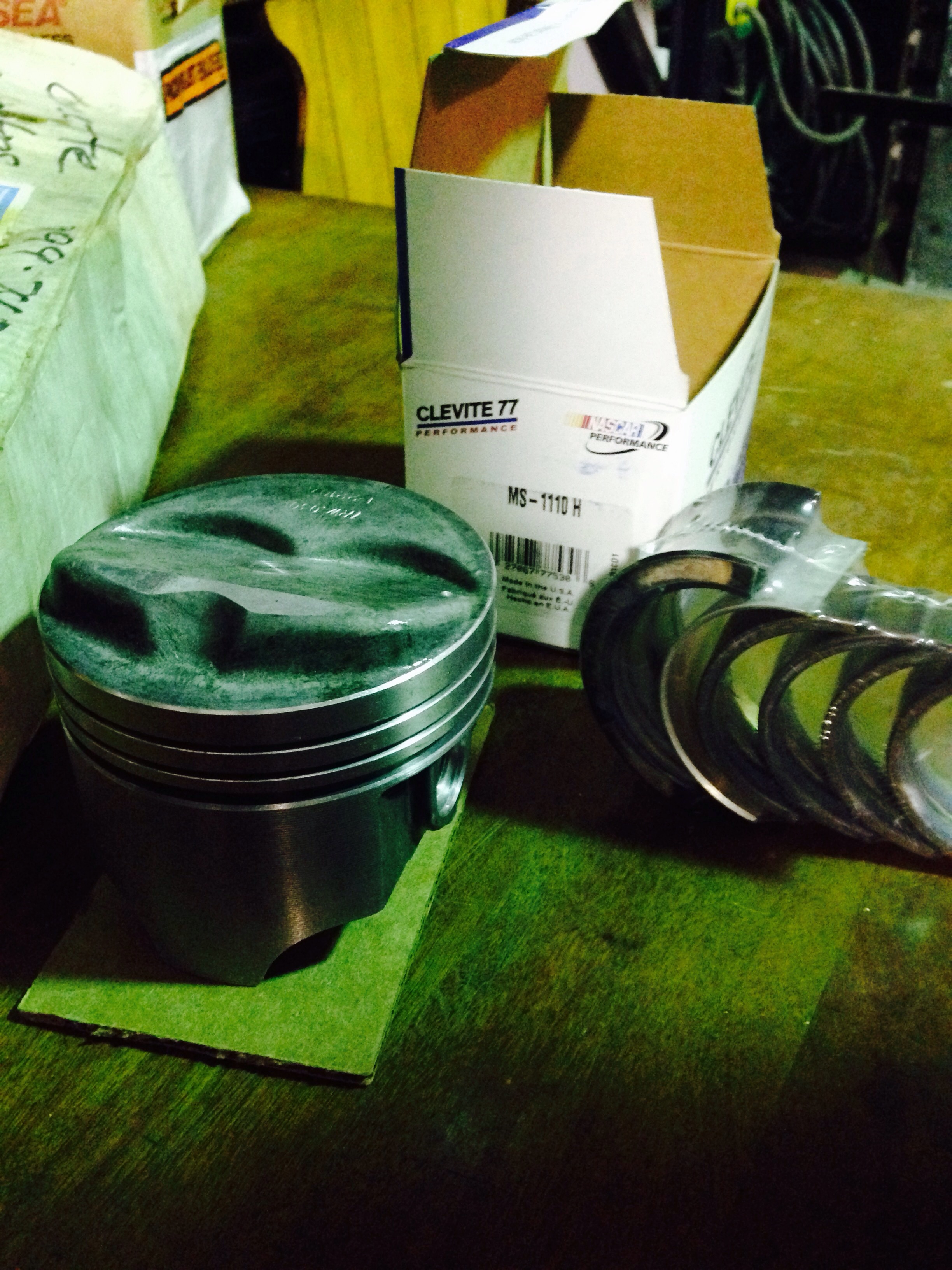

    Nos 302 trw pistons 67/68 domes & some of those thick Large journal to small mains from clevite bearings, of which I was too afraid to use. I bought this stuff 30 years ago when I was almost 14. I've always been a 69 z nut & have a deep love for the 302's. I've had lumps like the ones in top pic tickling 8000 many a weekends in late 80s. Boy do these little engines love to buzz.....Fun, fun, fun! As time p***es I've become partial to stove bolts..... A different but destinctive kind of buzz. Keep with the small journal theme all over I do recommend sir! Flux
