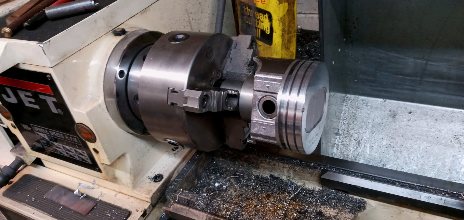

    I have jaws to hold the piston by the ring lands. Took this pic to show a while back, but you can't leave the pin in. It will get you! Also a quick and easy way to measure piston thickness to see if you have enough to cut .083 off.

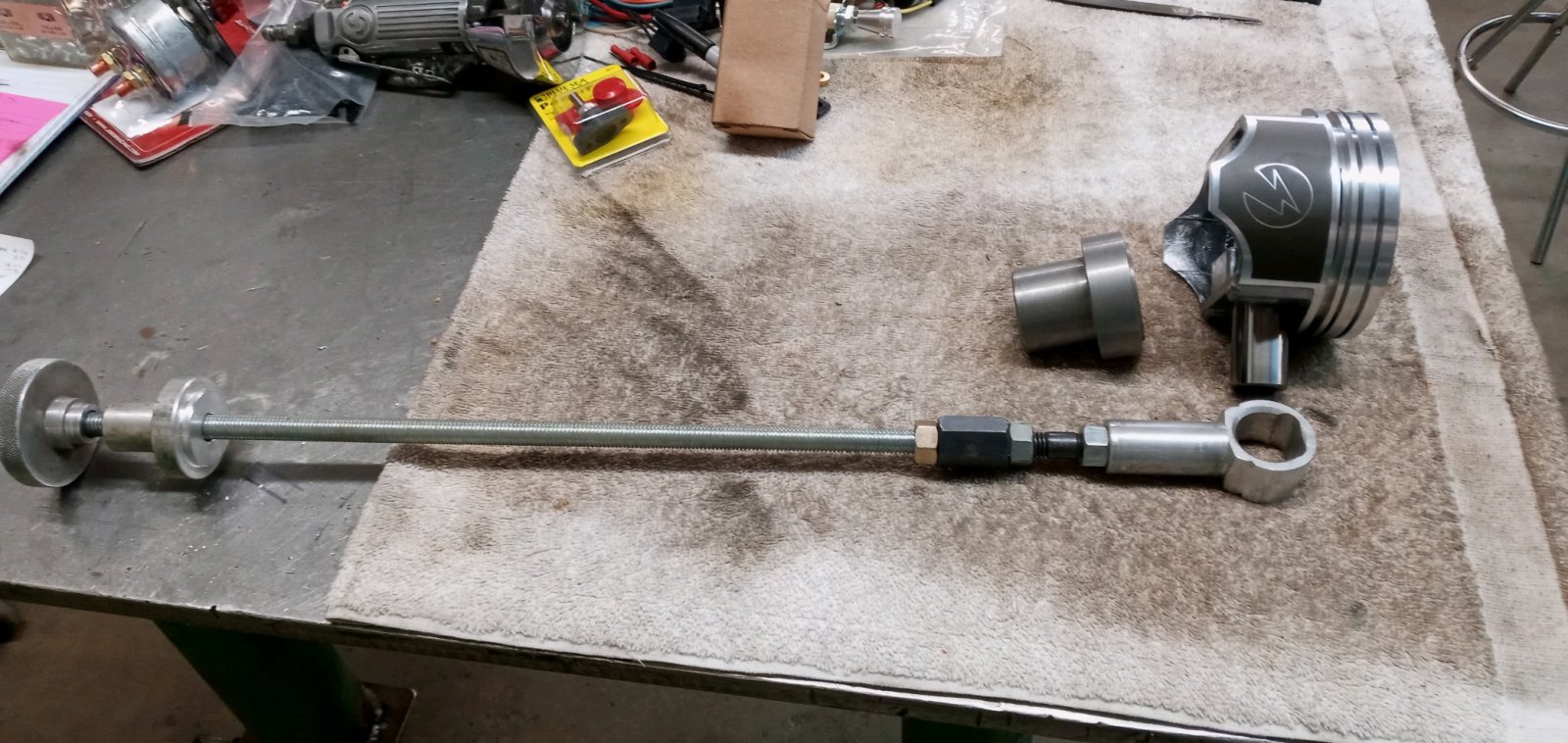

    I also made a draw bar set up, that pulls on the pin, I will get pictures later today. Its just a piece of aluminum machined to fit the bottom of the piston to register it and a eye bolt to pull it tight through the spindle of the lathe.

    Here is the draw bar thingie I made up. Most pistons have a register on the bottom, so I used that to locate the piston. Fast and repeatable.
