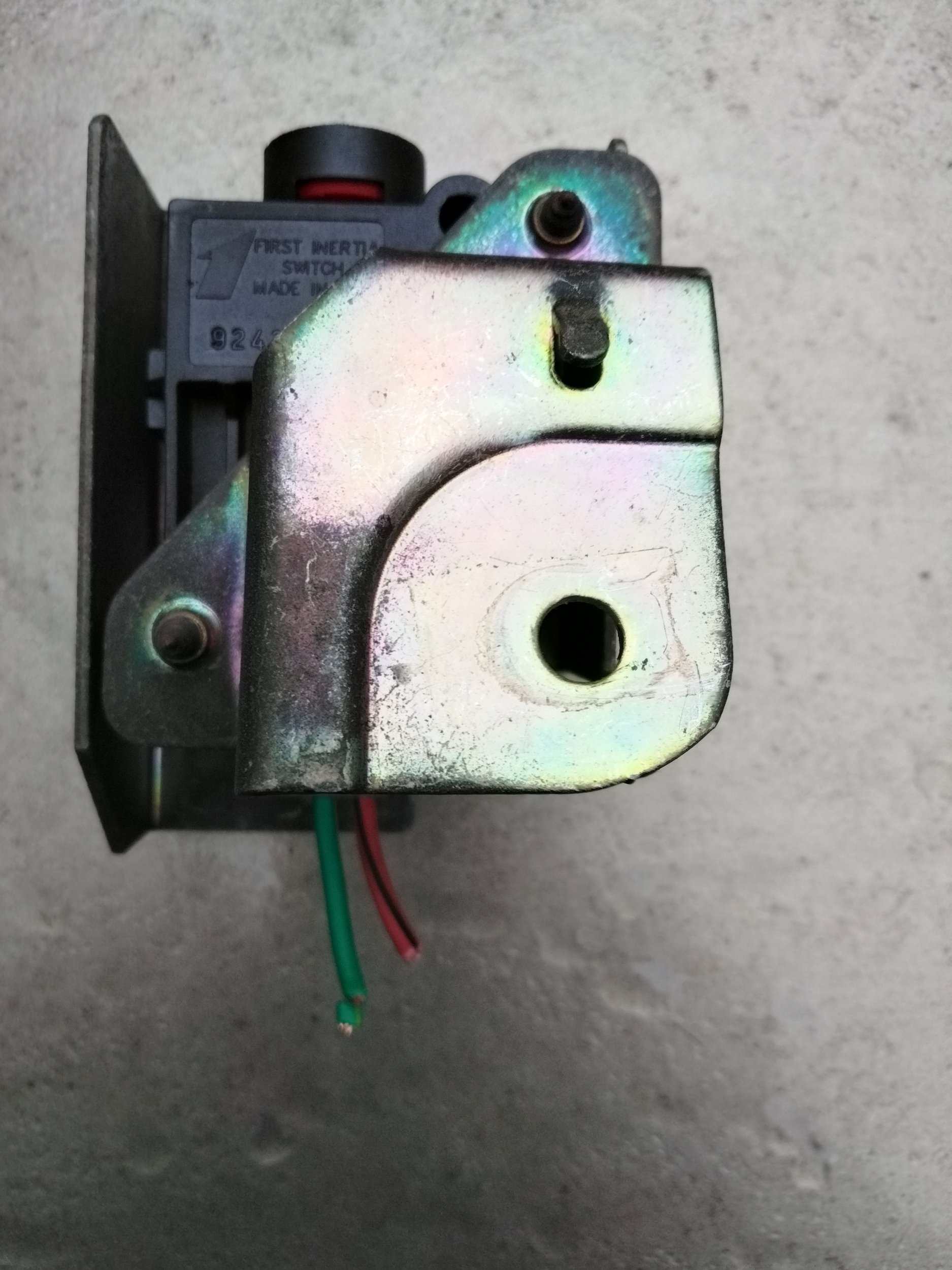

  1. If you are running an electric fuel pump on any of your vehicles, it is critically important that you have an inline inertia switch that will cut the power to the fuel pump if you are in a wreck. Ford uses a simple, easy to wire inertia switch that you can grab off any Ford vehicle made in the last 30 years that has an electric fuel pump. This one came off a '99 Mercury Grand Marquis. This switch is easiest to get to on Crown Vics, Grand Marquis, and Lincoln Town Cars, inside the trunk on the left quarter panel. One screw that takes an 8 mm wrench, and cut off the plug from the wiring harness and a couple of inches of wire to make it easy to wire into the electric fuel pump circuit. It has a red reset ****on on top. Once with a '90 Ranger many years ago, I hit a patch of ice and slid into a curb, no damage, but it activated the safety switch and cut the power to the fuel pump. All I had to do was press the red ****on to reset.

    Would a hard launch or coming down from a wheelie trip it?

    They’re in the right kick panels on the pickups. I would pop it with a screw driver while running to depressurization the fuel system when I changed the fuel filters on my pickups.

  5. Don't know if coming down from a wheelie would trip it or not. The car I took it off of was wrecked in the front with airbags deployed, and the fuel pump inertia switch was tripped by the accident. Just had to press the reset ****on. Don't think it would work as an anti-theft device, as it takes an impact to trigger it. But you could put a hidden toggle switch in the power feed to the fuel pump as an anti-theft device.

    Inertia switch is a good idea. I've always run the pump feed through a normally open, 10 lb. pressure switch plumbed into an engine oil port. Doubles as an engine shut down in case of lose of oil pressure when the engine is running also. An inertia switch wired up in series with the the press. switch would be an added safety feature.

    Ford cutoff inertia switches are in the trunk of all EFI cars. The Foxbody Mustang switch is very small. Also a 2 wire setup.

    I mounted an inertia switch in my rod, but was hoping I wouldn't get inadvertently trips in normal driving. A few thousand miles later, no trips.
    I run a mechanical fuel pump, and use the electric pump with a toggle switch to prime the carb, as the fuel bowl evaporates in a week or so.
    The problem with the oil pressure switch connecting the electric pump is you loose the ability to prime the carb.

    With a mechanical fuel pump you could make the inertia switch kill the ignition so that in the event of an accident the ignition would shut down stopping the engine and thus the mechanical fuel pump.

    If some cargo (I can attest that a couple HP electric motor is sufficient) falls off the p***enger seat under braking or the p***enger stomps on the floor of your Ford Ranger, Explorer or Aerostar (the switch is mounted where the firewall, tunnel and floor meet just above the p***enger's left toe in those) it will fairly reliably kill the fuel.
    And as deucmac said, the ones with trunk mounted ones are pretty susceptible to cargo being tossed around.
    99.9% of the benefit of a cutoff switch can be had by wiring the fuel pump relay to run with either oil pressure or starter. If you're driving your car so infrequently as to need to prime the carb a simple momentary switch can be added.
    If anyone is dead set on using an inertia switch the right side kick panel mount on 80s Ford trucks and vans seems to be the best mounting configuration to prevent being inadvertently tripped.

    Hard launch, no. Soft wheelie landing, no. Hard wheelie landing, yes.
    I've owned several Fords with the same switch, never tripped one, and I've done hard launches, soft wheelies, and off roading.
    For a stock replacement version, an easy way to remember what to get is just grab one for a 2000 Ford, any model. They're less than $40 and you can get a pigtail for them as well. You can put this wherever you like for ease of access and it just wires inline for the power wire to your fuel pump. You can also wire this into ignition module or coil wire power. Hopefully you'll never need it.

    they are designed to trip when hit horizontally, not when you go over a bump. The switch needs to be mounted with the ****on on top.
    my dad mounted one on its side and it would trip on speed bumps. Turning it 90° so the ****on pointed up fixed that problem.
