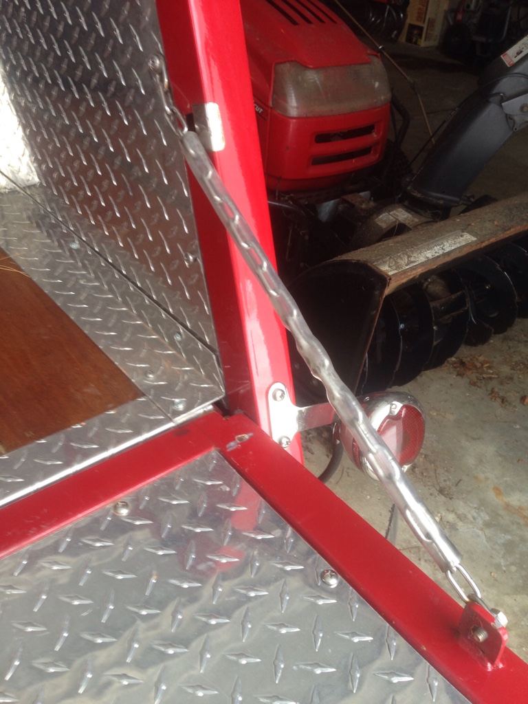

    I used stainless chains and covered 'em with clear vinyl tubing on my Diamond T, that'd kinda go with your beautiful tailgate hinges. Inspiring build and thread, BTW...

    Aforementioned stainless chains and clear tubing. Worked for me.

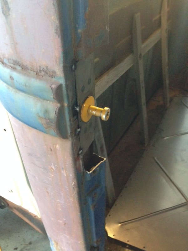

    Some "master hot rod builder" cut the latches out of my cab sometime before I got it. Boo!

    But with some nice heavy duty latches out of a freight truck I am well on my way to fixing it up. Still needs plated in and body worked but even just tacked in the doors close wicked and I won't have to worry about my kids falling out.

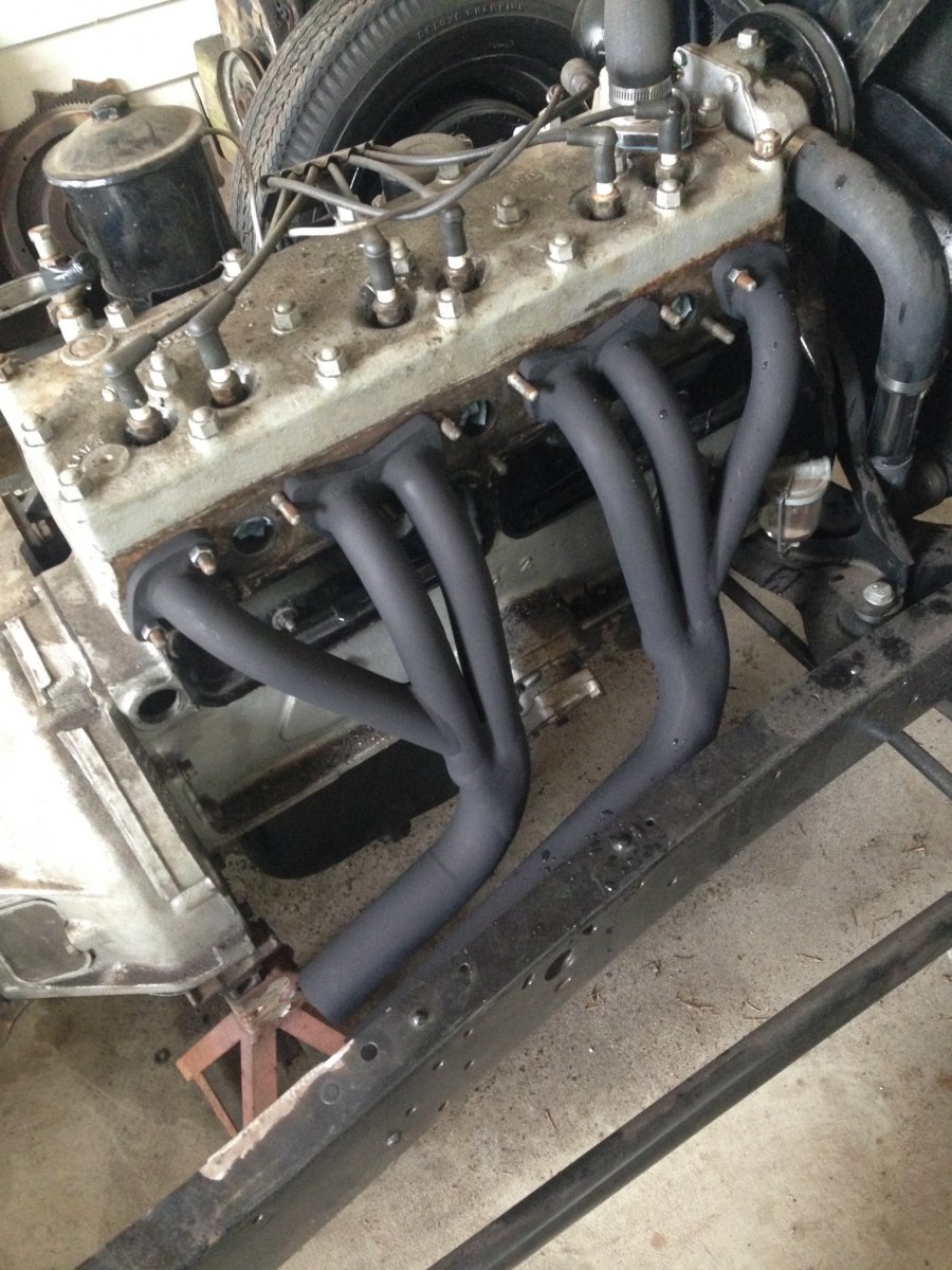

    IMG_1701.JPG And started to work on a 32 style crossmember.

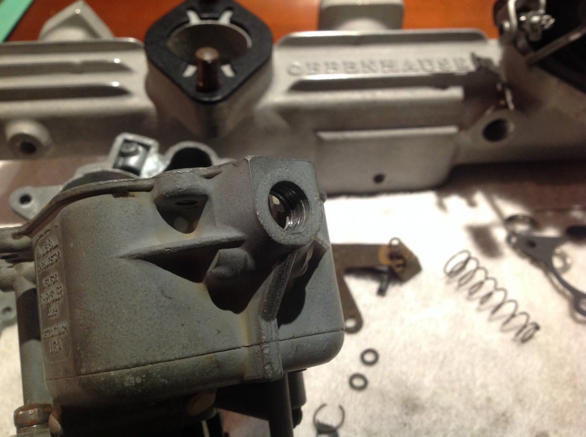

    I always go for timesert repairs in these situations....
    I will read on to see what you chose to repair this with. Love this thread!

    ^ I stuck a heli coil in it. It is low pressure and seals with a gasket on the face so it should be fine. If not I will keep looking for more matching carb cores.
    Or toss them both in the ditch and run some forklift carbs.
