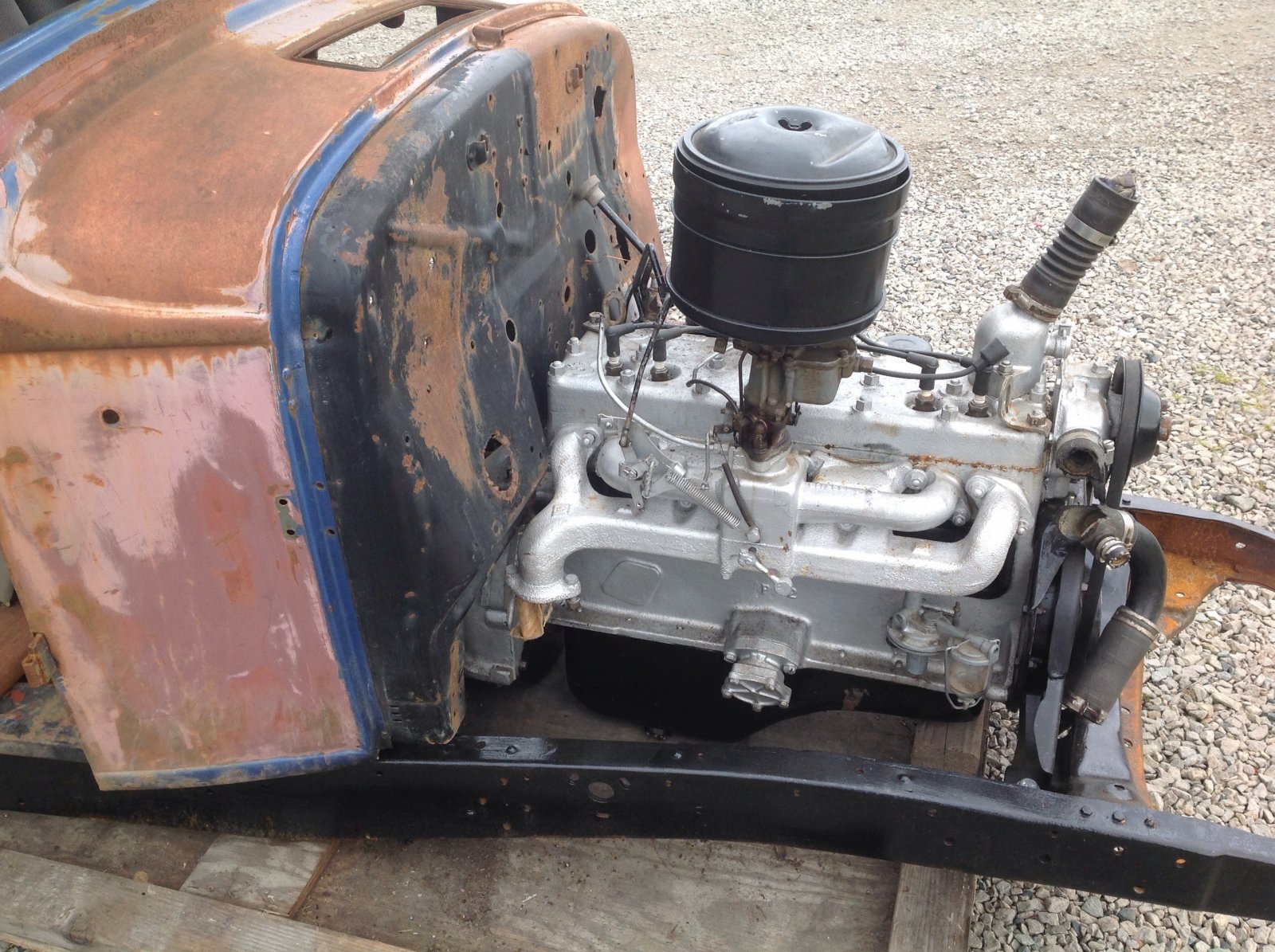

  1. I actually think that this pic with the 6 popper is pretty cool it actually fits the nooks and crannies in the firewall perfect.

    It only needs to go up about 3/16 of an inch.
    Not a bad fit for tons of guess work. I never bolted the cab down till after the engine was in. I figured I would just cut the firewall, but I don't have to.

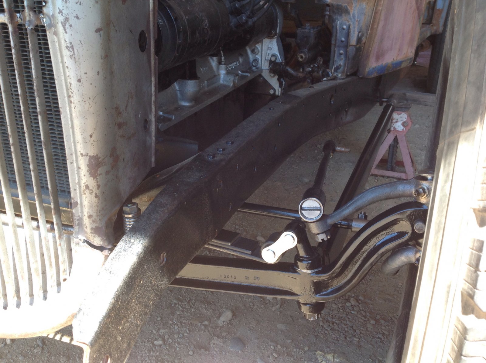

    Picking away at the truck this week. I finally got the front end stuck back together to check clearances. It seems I need to bend the steering arms up about 3/16ths just so the bolt heads don't rub on the bones. image.jpg

    I am not entirely sure what to do about this lack of clearance between the axle and the spring plate. Ideas? image.jpg

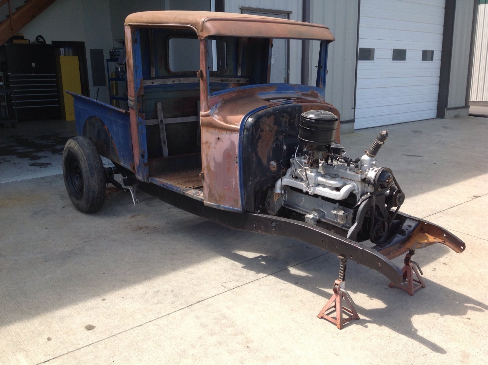

    But it is starting to look like something. The grill is still in pretty tough shape but I have an idea for that. image.jpg

    But (I might be wrong here), shouldn't the top bearing face of the steering arm be parallel to the face of the king pin boss on the axle? I was just reading another thread where the guy emphasised this, in his front end build.

    The arms are not finished yet. I need to mount the steering box and get the axle and wishbone mounts finished. Then I will cycle the suspension and steering like I do with long travel 4x4 builds to check for binds and bump steer. For what it is worth the angle is not as far out of whack as it looks. Bad picture I guess.
