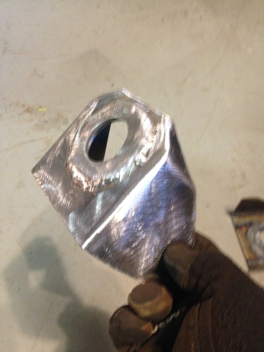

    Latch plates all welded and round up. Need to fill the little round hole yet but you get the idea.
    Getting closer to getting the cab sand blasted and primed. Hopefully by the end of February.

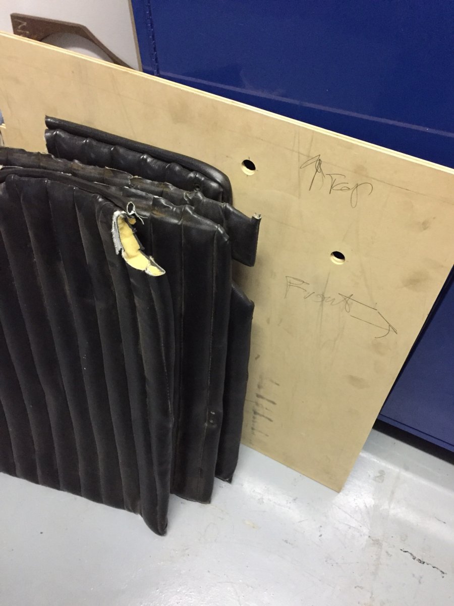

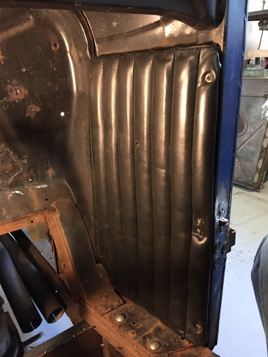

    IMG_2212.JPG IMG_2218.JPG Picking away on stuff in my typical non linear manner. I cut all the Masonite for my interior panels, fitted the kicks and got the rest ready to go to the shop for finishing. Recycled vintage vinyl!
