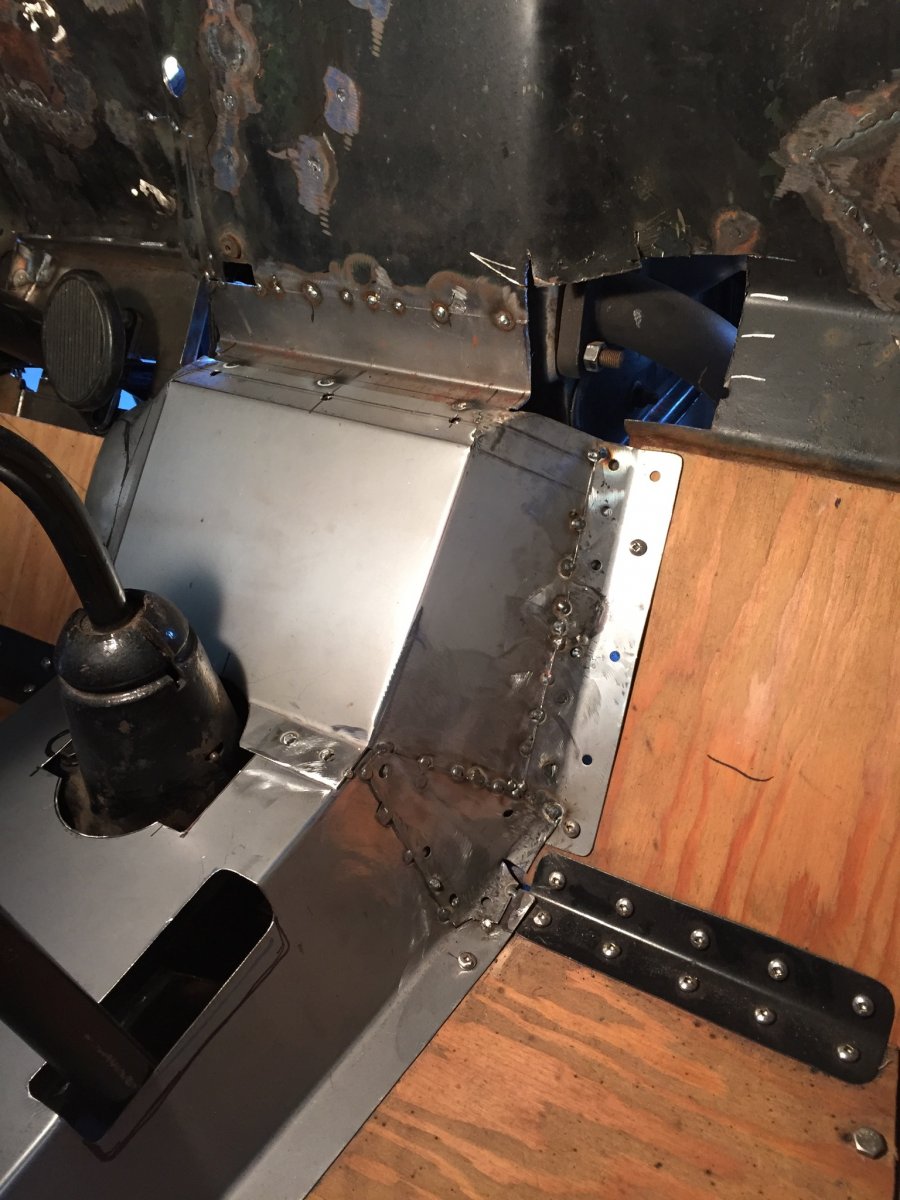

    This part is a real pain trying to preserve foot room for the pedalm here's my early stage effort 20181007_172729.jpeg

    After working on the second section I'm considering s****ping the round tunwl and going to a boxier approach like you have. It's pretty tight on the pedal as is 20181021_234456.jpeg

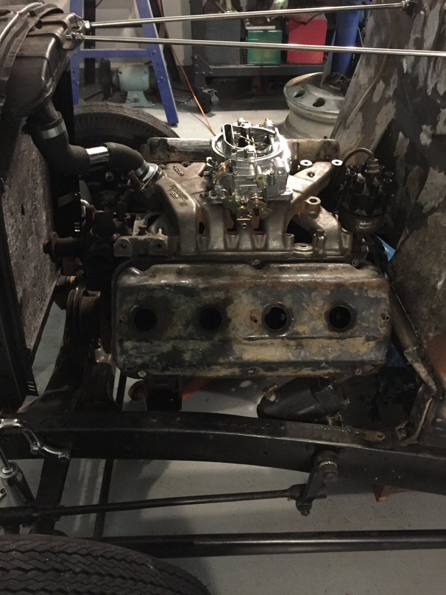

    IMG_2795.JPG IMG_2796.JPG More fitting and screwing around. Swapped out a couple of bad caps and hand fitted replacements. And 426 hemi studs. Bores are round within .0005 but still need honed. Rear cap is big in one direction by .001.
    And the 354 oil pump fits with a little grinding.

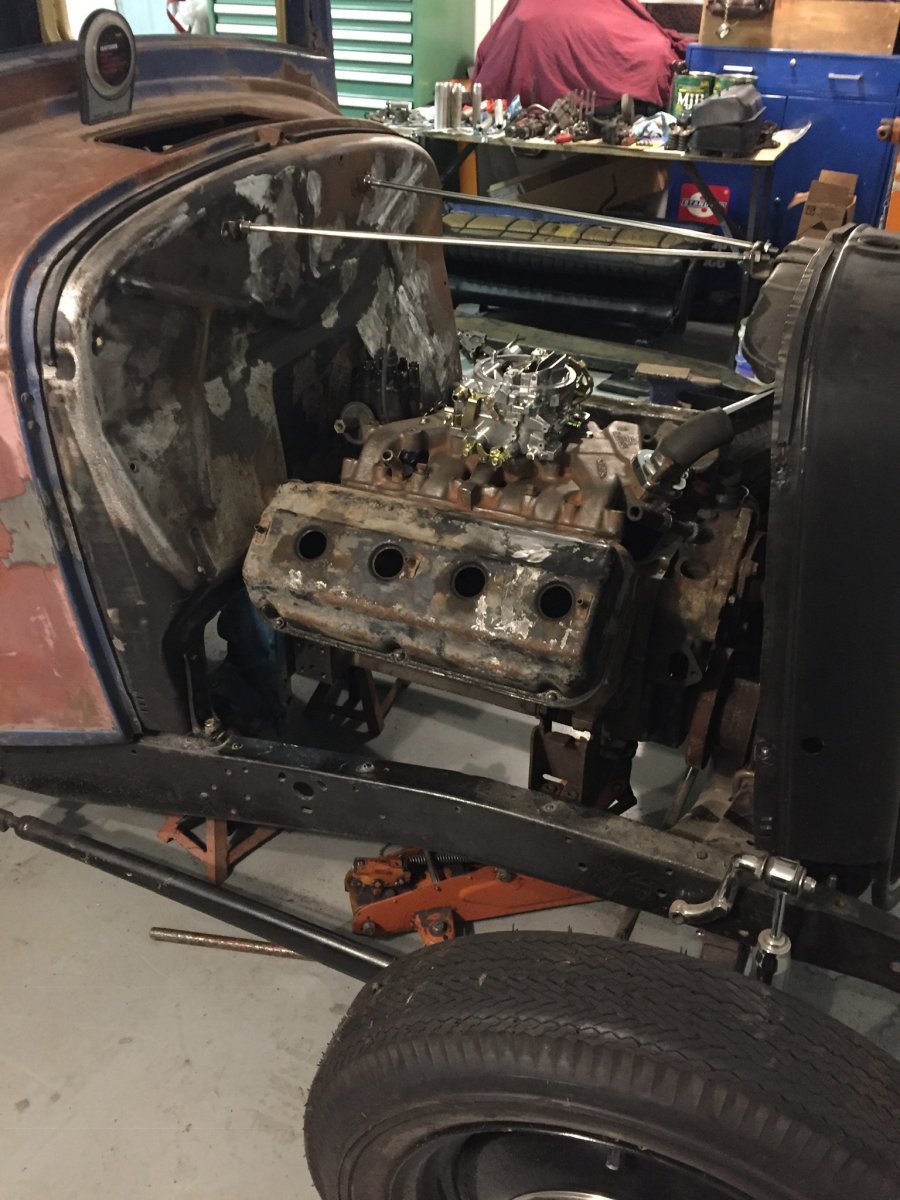

    IMG_2813.JPG IMG_2814.JPG Well the six is out and the hemi mock up block is in place. Hard to believe this fits better. It's twice the size. It has to move up about an inch. And the exhaust is still going to be tight to the steering box.

    :rolleyes:...just like that...Cool...its the shuffling of the issues but the new hand may be better does it help the pedal deal?
  23. dumprat
    Joined: Dec 27, 2006
    Posts: 3,573
    dumprat
    from b.c.
    Yes it fixes the pedal problem. The floor becomes almost flat.
    I am going to order a front cover to accept a Chevy water pump. It should allow me to push the engine forward an inch and still run a solid mechanical fan.
