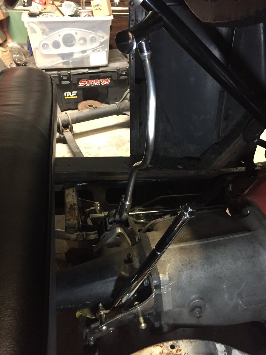

    IMG_1669.JPG IMG_1670.JPG Still ****ing around with clutch linkage and all the other bits I need to have in the cab while maintaining room for me! I had to put a bunch more bend in the shifter and lower it a tad to keep my knuckles out of the dash. It's ergonomic as hell and visually weird which I think is great! I also got the e brake mount figured. I need to find some cheap rubber shifter boots or scrounge the wrecking yard for small leather ones.

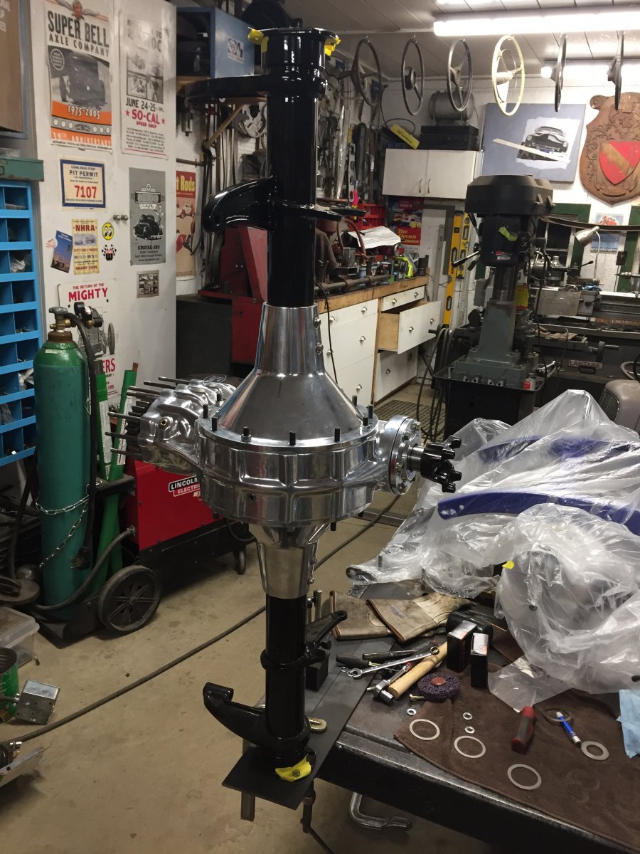

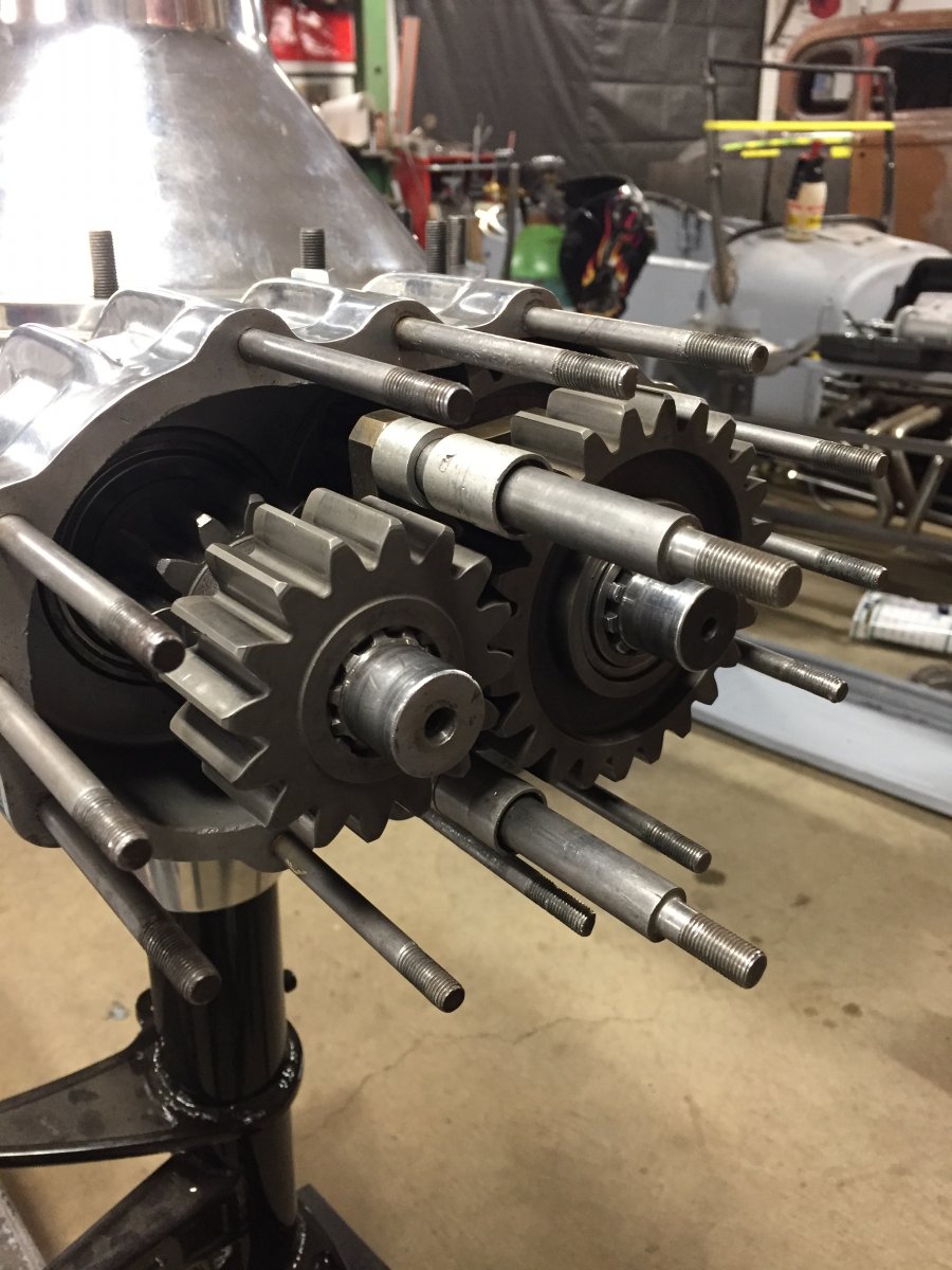

    IMG_1719.JPG IMG_1721.JPG So a little side project to help my friend @29Hiboy .
    We have been rebuilding and setting up his two speed Halibrand champ quick change. It now has a DPI gold track and slip in 31 spline axles. We had to make a few tools and modify the adapters.
    Should be very cool on the road. Either 2.73 or 4.86 rear gears all shiftable from the drivers seat!

    HIS WHAT?
    I was today years old when I learned that existed and now I need one. That sounds amazing.

    Ya it's a two speed halibrand 301 quick change. Has a shifter through the cover and a set of dog clutches to shift between gears. The gears need to be machined a little but it sure looks cool.

    Ok, so this is a homebrew? I have been looking and can't find any information or mention of this outside of your thread right here and I am thirsty for this knowledge! Looks like a few other guys are too.

    Sorry but it's not one of those. It's a Torrence calif. Halibrand 301 with an extension made for the spur case and the cover modified. It has a longer quill and pinion spline.
