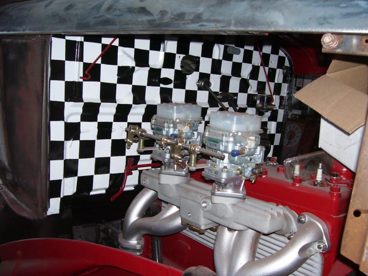

    Here's what that engine could look like when its done.

    I already have the same intake but I think I will build some tube headers. It is easy and fun.
    From old guys in the know, ditch the oil filter. The byp*** system bleeds off oil pressure at high rpm and doesn't do much at low rpm. The little six needs all the oil pressure and flow it can get.

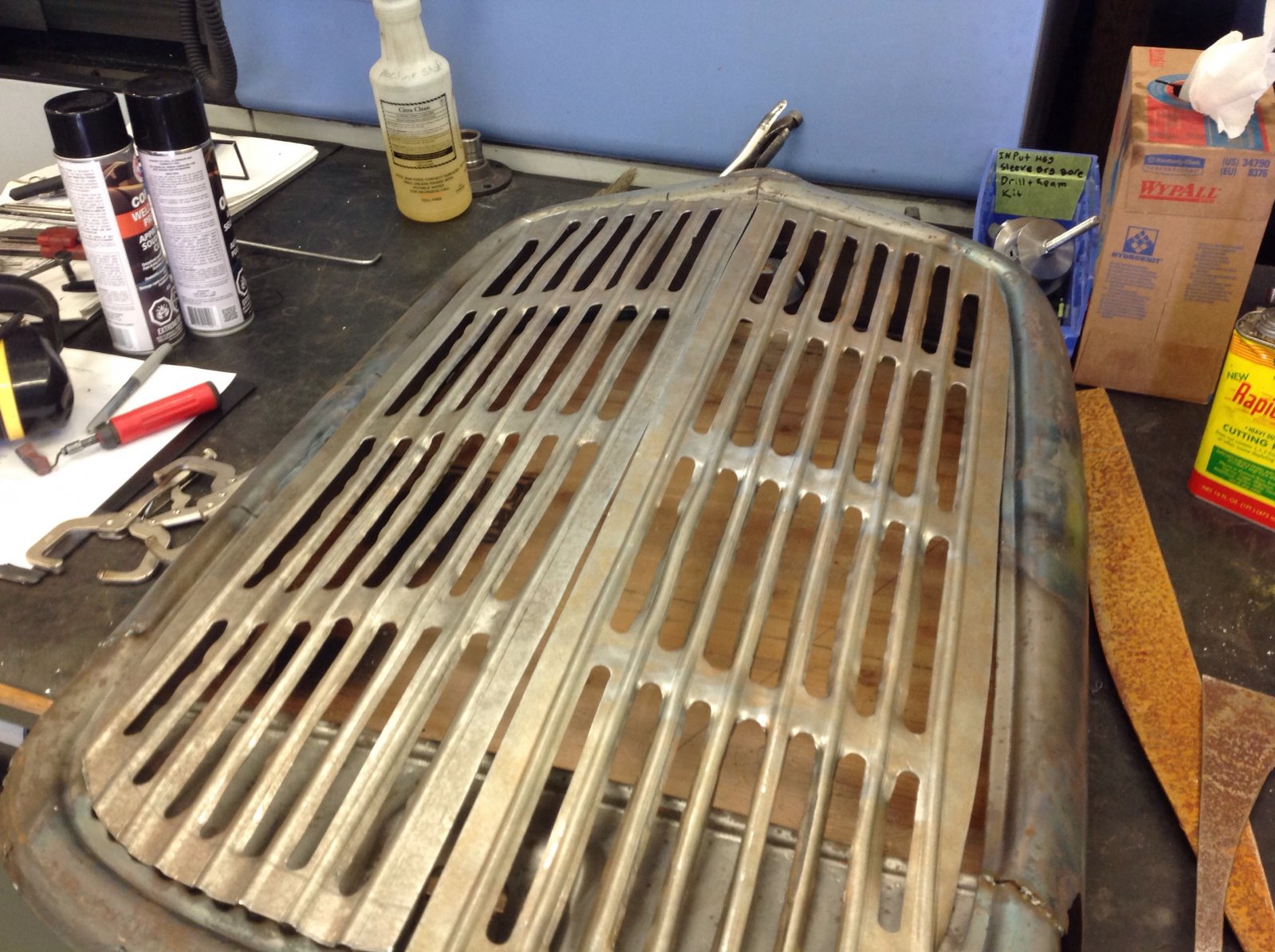

    Got the grill insert started today. Cut out and the slots done on the mill. Then ran them through the trusty Harbour freight bead roller. Must have gotten too much sun yesterday. I left the blank spot for the crank hole on the top rather than the bottom. Oh well that is an easy fix. image.jpg

    Still needs a ton of hammer work as the dies to bend the bars tend to roll them over.

    Somebody please explain this to me. What is the top bearing face of the steering arm? steering arm or draglink? What part of the kingpin boss is the face? thanks

  10. Budget36
    Joined: Nov 29, 2014
    Posts: 15,838
    Budget36
    Before you start hammering, maybe make up some dies and V blocks and use your press. I fixed up some '35 and '36 Ford PU grills that way.

    The bars are round faced from the die of the bead roller. I am thinking if I tack a piece of round bar to a piece of stock and clamp the inserts to it I should be able to hammer the sides of the bars down to where they need to be.

  14. Jethro
    Joined: Mar 5, 2001
    Posts: 1,967
    Jethro
    What about routering a slot in some wood to use as a hammer form?

    Sort of what I am thinking only steel is easier. Or maybe some plastic.

    image.jpg I ended up welding a T dolly out of some 1/4" stainless and a chunk of flat bar. That a bunch of different pairs of pliers and a female radius piece of aluminum to beat on worked. It will get stainless trim and a stainless center bar then the insert will get painted satin black.
    Not finished yet but I like it.

    rdscotty
    from red deer
    Love the insert even more now that I know it is an original design.
    I have a question though. Would it be possible to do the bead rolling first and then mill out the slots? Would that help lessen any distortion?

    It didn't distort much when doing the bead rolling. Holding the plates after bead rolling was a major pain. (I had to fix one slot)
