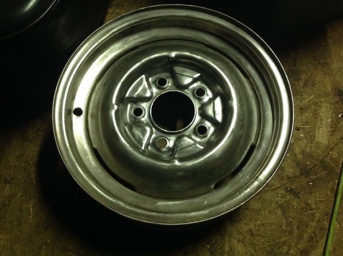

    Soaking parts in mol***es while getting other stuff in order and chasing kids to school. Wheel on the left is soaked and wire wheeled and right is just media blasted. On to brakes and spindles tomorrow. image.jpeg

    I went to Less Schwab and they quoted $25 and change. I removed the tires and I taking them in today. They are 19" Chevy wire spokes. The mol***es bath looks like a good way to go. I need to build a tank to soak my frame.

    image.jpeg They were pretty nasty to start with. I plastic blasted the paint off, but it doesn't touch rust. And the local yokels want $250 to sand blast four wheels.
