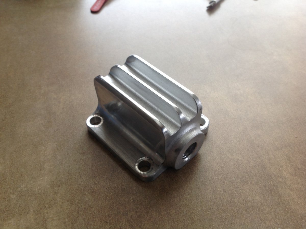

    Spent the weekend fixing broken jeep and other things but managed a whole hour tonight to work on truck parts. Cleaned spindles for a trip through the magnaflux bench and built a finned fuel block. Still needs some holes and a bunch of other work but it is a start. I needed to work on my fin cutting technique. I have more of that in the future. image.jpeg
  16. dumprat
    Joined: Dec 27, 2006
    Posts: 3,572
    dumprat
    from b.c.
    image.jpeg Finished the fuel block.

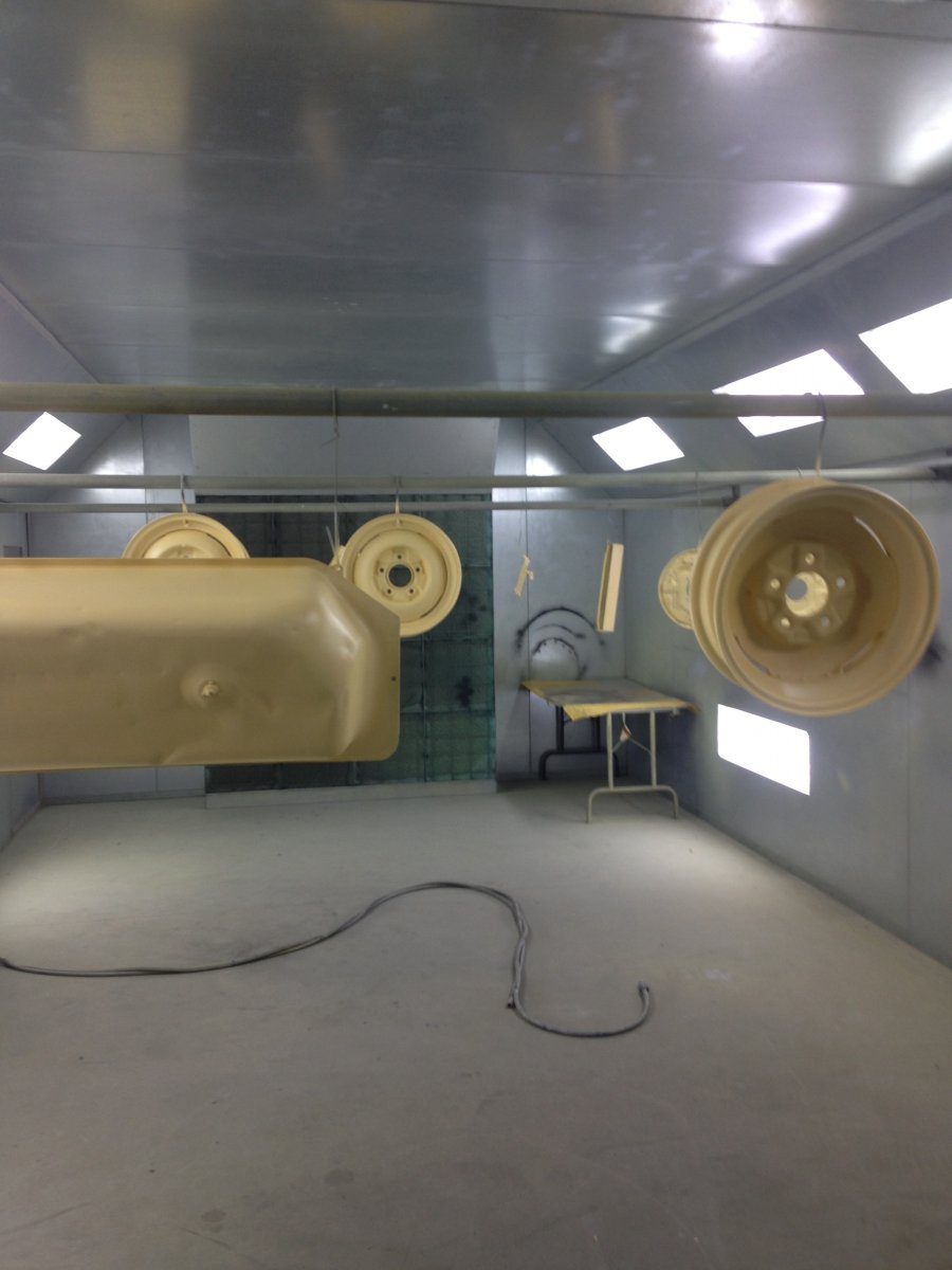

  19. dumprat
    Posts: 3,572
    dumprat
    from b.c.
    After a week of blasting and scrubbing I finally got everything in the booth and primed! A lovely shade of beige. Ick! image.jpeg

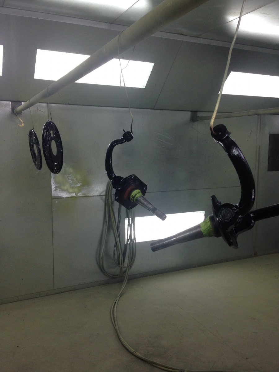

  20. dumprat
    Posts: 3,572
    dumprat
    from b.c.
    And got the spindles hubs and backing plates painted and ready to put back on. I hate paintwork. It sure does look nice once it is done though. And yes the booth at my work is filthy. image.jpeg
    tb33anda3rd, Jeff34 and volvobrynk like this.

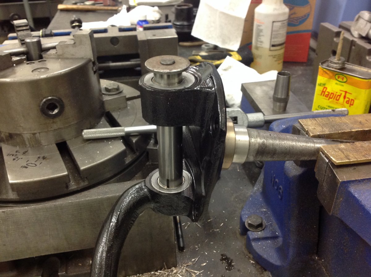

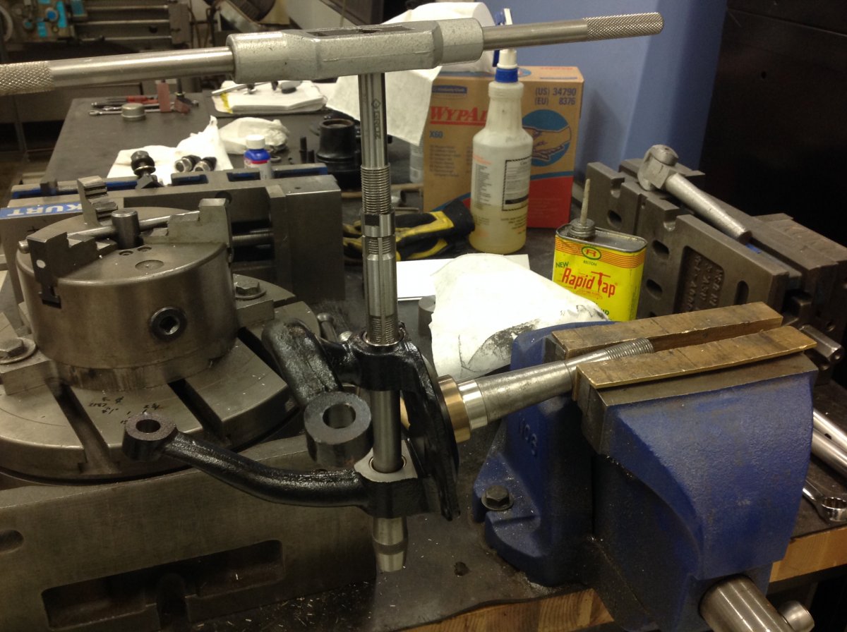

  24. dumprat
    Posts: 3,572
    dumprat
    from b.c.
    Got my king pins reamed tonight. Adjustable piloted ream. No stupid piston pin hones. Note the pilot at the bottom. I start with them upside down, do the bottom hole then flip and go from the top down. Cut in three stages. Last cut being about .002.
    Pins fit super nice but the pins themselves are slightly different. One pin fits its own spindle but they mic at less than .0002 difference. And they line up exactly! No sloppy ******** like the last set I had honed.
    DylanHill1931 likes this.
